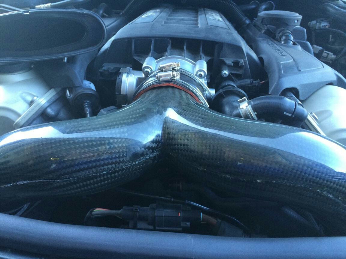

Put the new 82 mm tb on and took her gor a drive. Stepped in it and this happened. Moving some serious air. Hit 1.2 bar for a brief second. Guess its time for metal piping.

Don't you think the metal will flex if you split carbon fiber? I don't know enough about physical qualities of both materials

The c.f. split at the seam weakest point there's guys out there running huge power thru alum piping it will be fine

So the bigger 84mm gt3 throttlebody works fine ? It fitted the agency y-pipe because of the silicone adaptor ? Did you use it with 20T turbocharger ?

The tb bolted right up. I used the carbon pipe for the 20t. Not sure why it split with the 22s saw 1.2 bar just like before. Slot of air flowing thru. Since I made the cold side pipe from the turbo to I'd bigger. Moving mire more air will get a Metal one made or something and then we will be ready to see what the current tune does. I wasn't there but Rob said pulled Hard. Scary fast he said lol

I think for the y-pipe its better to do like we discussed ! Like oem system . To replicate a plenum to fit the throttlebody and with inlets 2.75-3inch , than silicone hoses like the oem system

Yea I agree but I'm sure that will cost an arm and leg to do

No ,why ? 1 silicone hoses are 100-200$ with couplers. Than ard hace just to fabricate the plenum . You can alwas do it in full aluminium but the space is tight and the movement will make it hit things.
