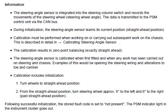

and one more, anybody has calibrated steering-angle sensor after alignment ? (I'm not event talking about ACC sensor )

)) .... just wondering what includes alignment at Porsche dealer
I've never asked them, but now wondering do they do steering angle and ACC sensors calibration as well for those $279 ?
