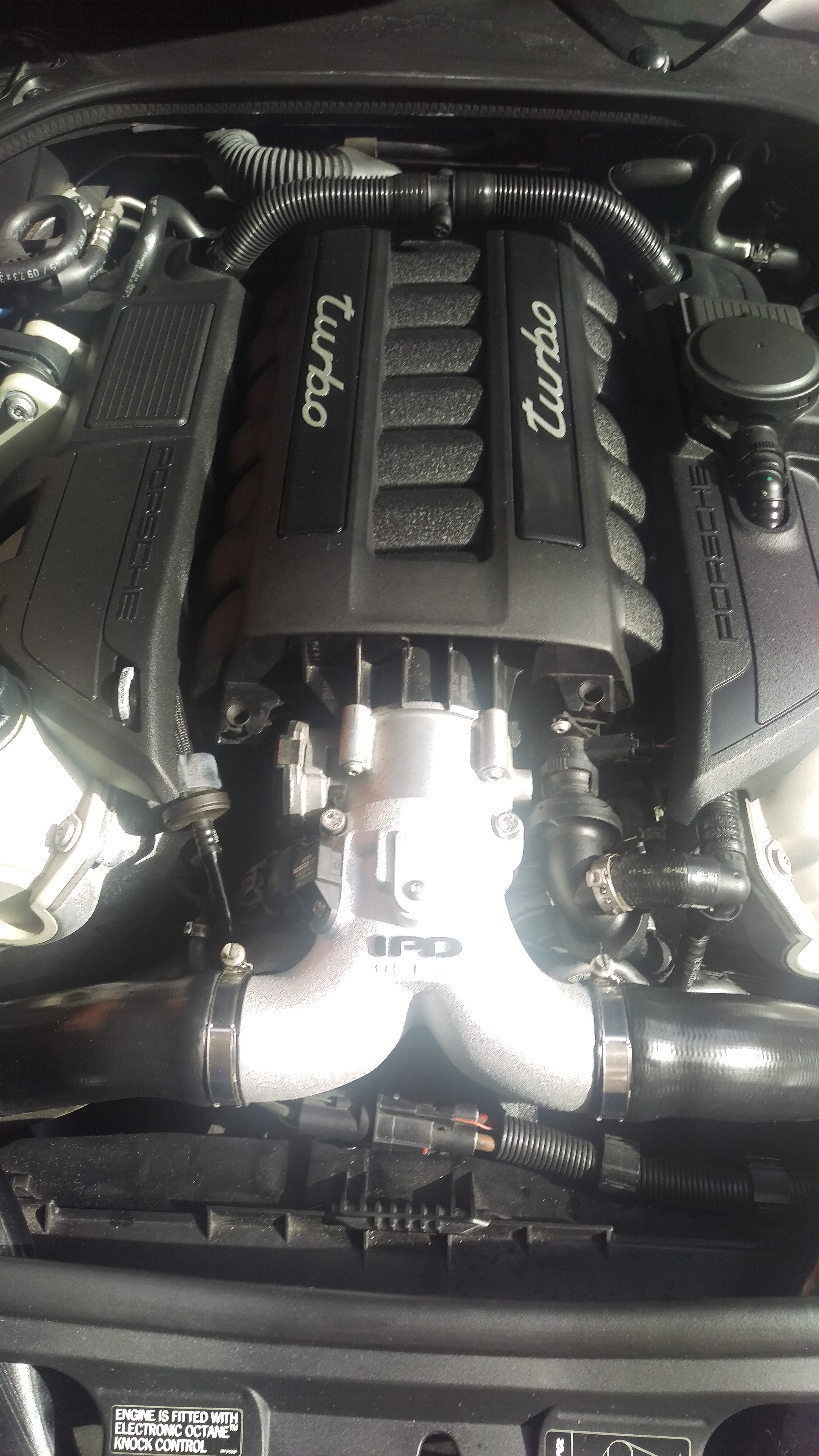

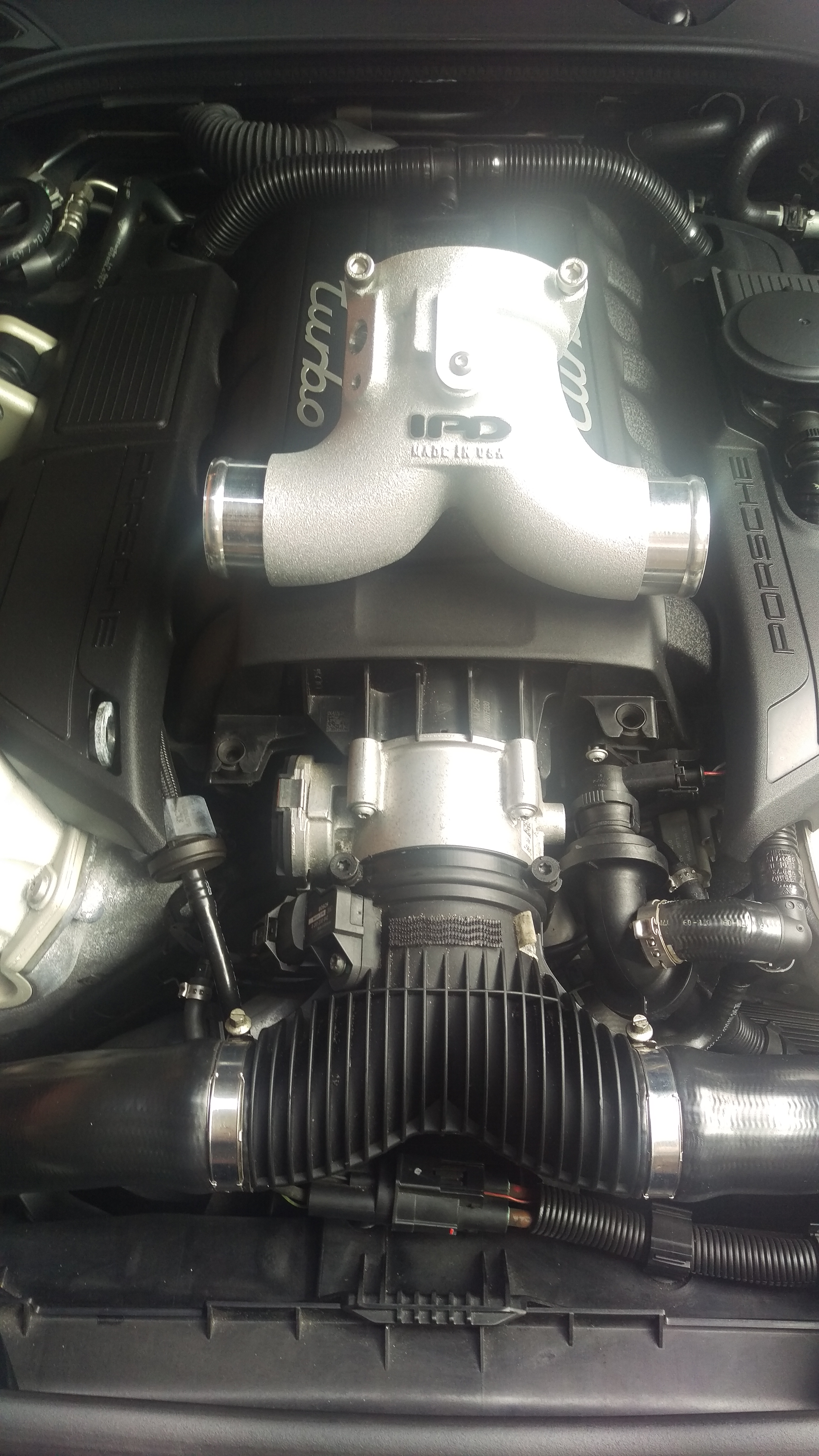

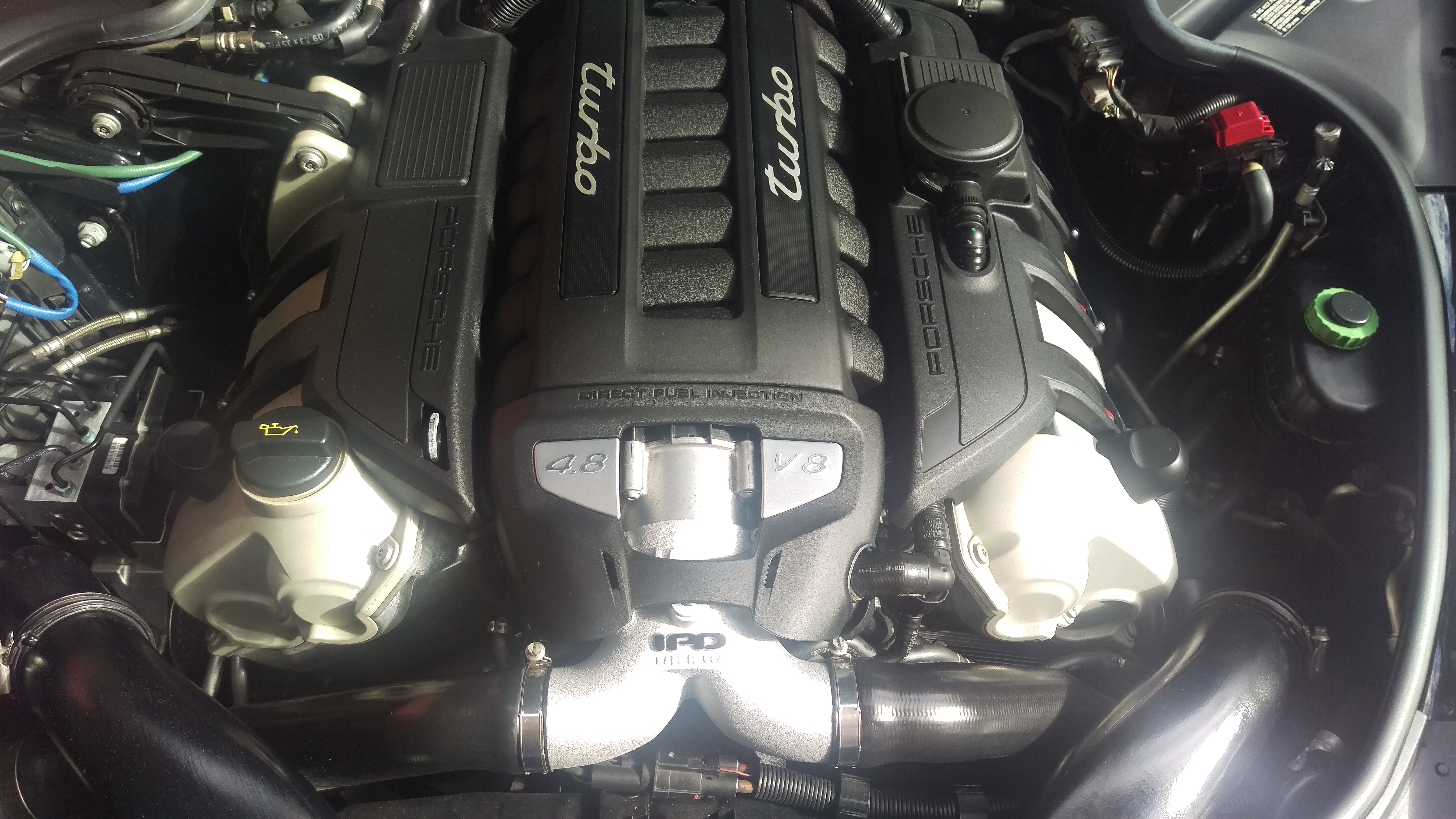

Easy install on my 2010 turbo.
VRTuned ECU gets installed nxt week.
Should be @ around 580 hp by then.

Have you noticed any driving difference at all with the plenum installed?
Old Aug 18, 2016 | 09:11 AM
RDS993's Avatar
Joined: Apr 2010
Posts: 523
From: Short Hills NJ
Rep Power: 42
RDS993 is a name known to allRDS993 is a name known to allRDS993 is a name known to allRDS993 is a name known to allRDS993 is a name known to allRDS993 is a name known to all
Yes,
the idle is smoother on cold starts, quicker throttle response too.. The boost gauge shows positive boost pressure.1-.3 at light to moderate throtle input where as prior to IPD install there was no positive boost unless you gave it more throttle input
Rich

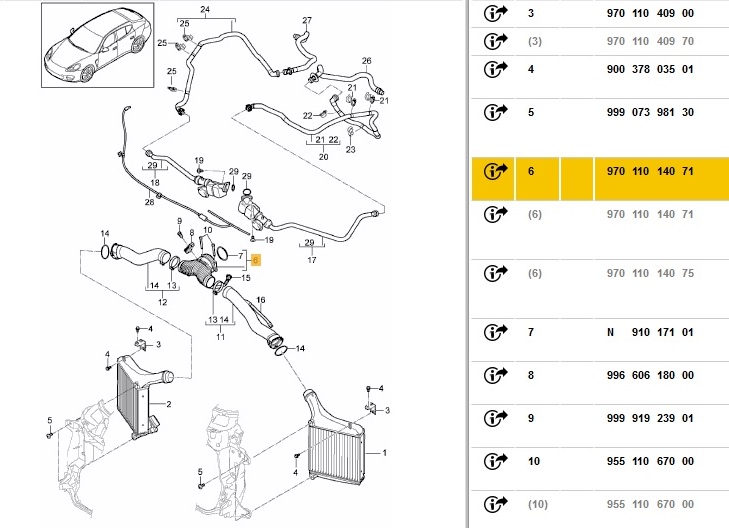

Do you know part number of your OEM Y-Type Connector, I assume it is part No.6 ? Just wondering if Turbo & TurboS has the same (97011014071) or different Actually is this IPD Plenum good for TurboS or not
Old Aug 18, 2016 | 03:42 PM
RDS993's Avatar
Joined: Apr 2010
Posts: 523
Rep Power: 42
Oem # for standard turbo plenum is : 970.110.140.71
http://www.ipdplenums.com/products/p...anamera-turbo#!
Turbo S has larger throttle body than turbo so the IPD wont fit.
Old Aug 18, 2016 | 03:49 PM
porschecayenne92's Avatar
Joined: Jun 2013
Posts: 1,107
Rep Power: 72
porschecayenne92 has a brilliant futureporschecayenne92 has a brilliant futureporschecayenne92 has a brilliant futureporschecayenne92 has a brilliant futureporschecayenne92 has a brilliant futureporschecayenne92 has a brilliant futureporschecayenne92 has a brilliant futureporschecayenne92 has a brilliant futureporschecayenne92 has a brilliant futureporschecayenne92 has a brilliant futureporschecayenne92 has a brilliant future
Yeah the same . Only in the cayenne turbo s 957 the y-pipe was bigger than the turbo model because of bigger manifols 82 vs 78mm.
I do not understand why porschr didnt reuse it :/
hmmmm .... now I'm confused.... 970.110.140.71 is part number for engine type M4870 as per my TurboS VIN and this is 100% correct.
