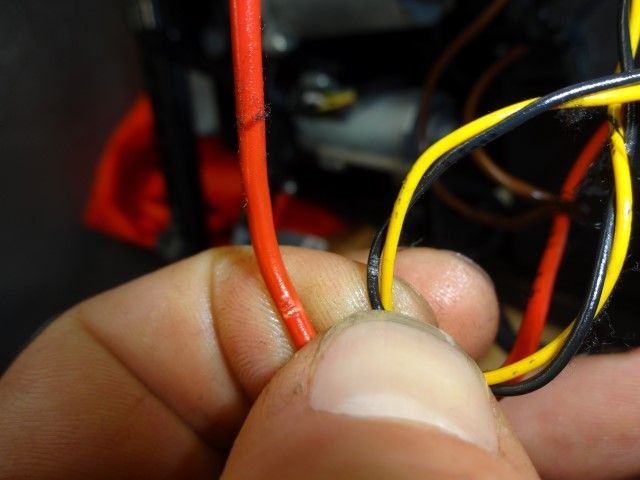

Wish I could.
It's been a month now and still no diagnosis. Who would buy such a high end car in such a condition, unless it were highly discounted.
Porsche has no idea how to fix it and were even considering returning it to me, as is, so I could drive it some more, until the faults return more regularly (apparently they're having difficulty replicating the faults).
Anyhow, I guess I should just be happy with the Cayenne diesel I have as a loaner, since everything seems to work just fine.

mwvh's Avatar
Joined: Aug 2015
Posts: 42
Rep Power: 12
mwvh is infamous around these parts
Believe it or not, after a total 7 visits and 150 days in the dealership, Porsche finally found the cause of all the car's problems. It was simply a short between two wires under the drivers seat (see pics below). Apparently it was a short to positive that was taking down the whole CAN. I can't believe that such small wires can cause so much trouble... Anyhow, I've very happy to finally get my car back.
