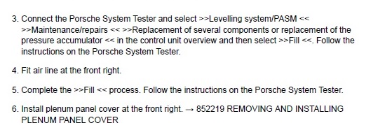

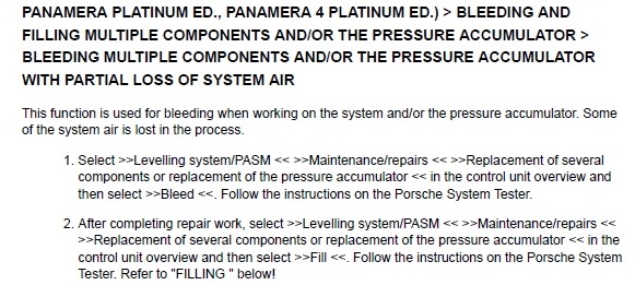

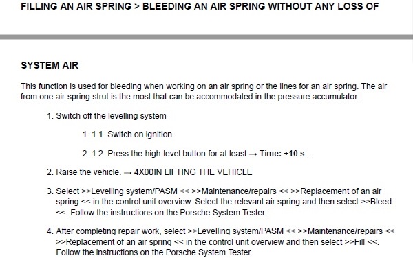

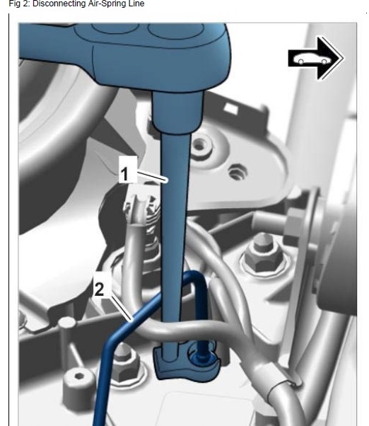

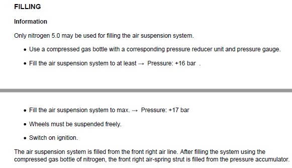

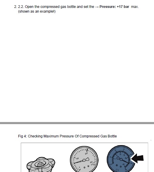

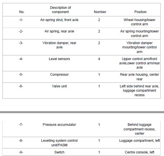

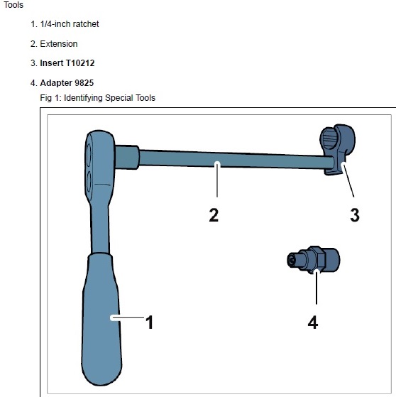

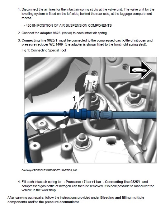

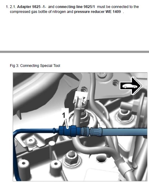

..... I have disconnected and drained all 4 air-spring struts at the same time, but before off course I've raised the car to 'high level' and turned off air control to lift the vehicle.
After all necessary repair work was done and everything connected back it took some time to get all air-spring struts filled up, as Kumar wrote 'random troubleshooting' Please note, all doors and both lids has to be closed !
But after all this was done in the Panamera_Service_Repair_Workshop_Manual
https://www.6speedonline.com/forums/...roduction.html
https://drive.google.com/open?id=0B8...TB5blVHQXlyTlk
I've found that air suspension system has to be filled with nitrogen !!
So what is this all about ?! Is it really needed ? Why my Panny with all 4 empty bags got back to normal ? Or it used content of pressure accumulator (No.7 in one of attached printscreens) ? But the same manual says that content of pressure accumulator enough only for one bag/air-spring strut ....
I'm attaching printscreens from the manual related to ir suspension.

It might be that any "dry" inert gas can be used. If not dry, low ambient temperature in combination with the system pressure may cause condensation.

Yes, I do understand advantage of nitrogen (+- the same when inflating tires with it) but what I don't see in air (NITROGEN ?) suspension system is it really closed loop ? and that instruction for filling nitrogen.... when disconnecting from bottle you have to be quick fitting air(NITROGEN !) line back at the front right bag?
And the last one: as I've wrote before I had disconnected all 4 air struts at the same time and then got them back working but manual says that accumulator has capacity to inflate only one ! ... I'm totally confused
