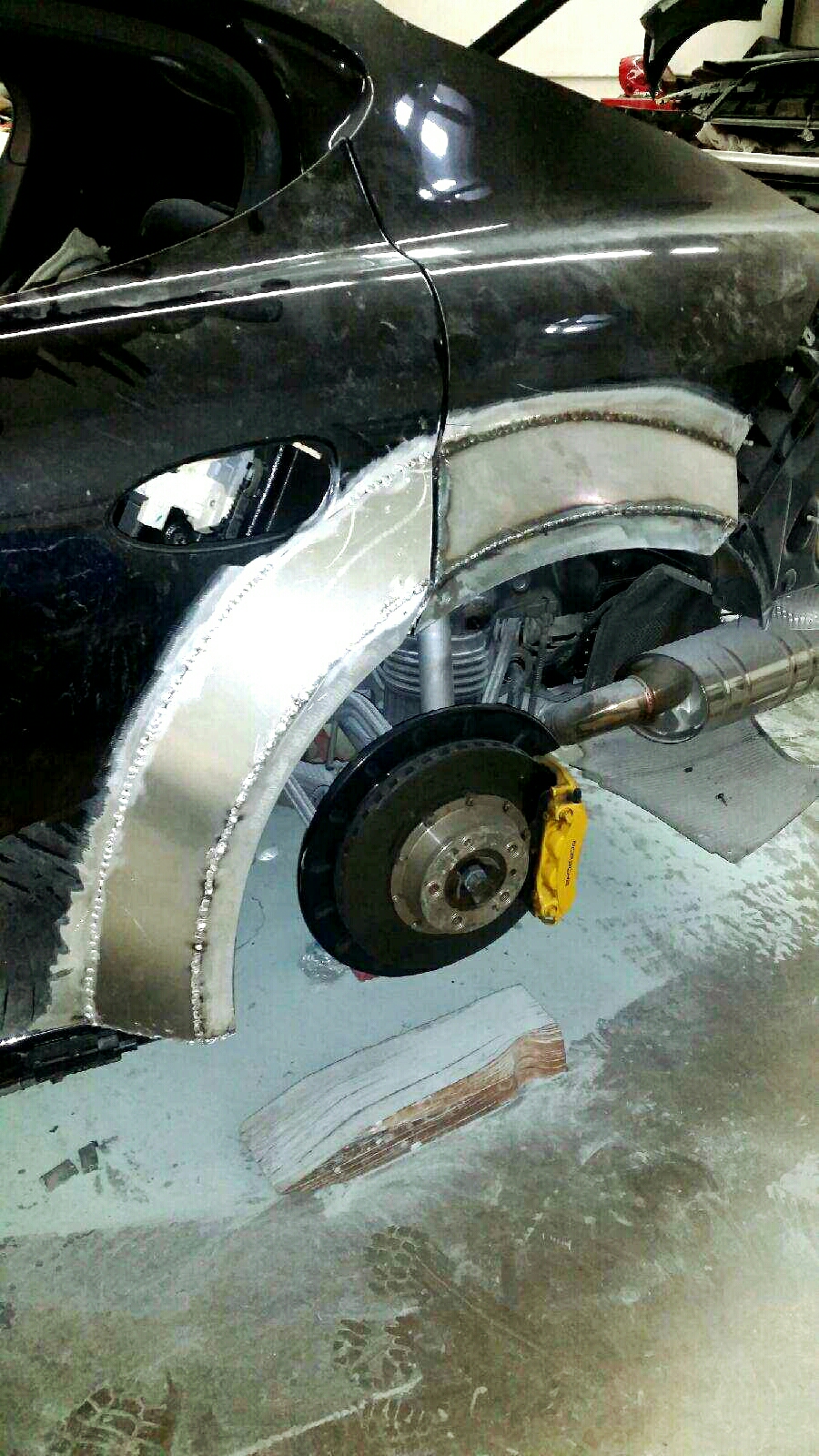

The tech art is a work of art. I was looking at that hard when I stumbled across Topps work. I decided a custom fabled metal was the way to go and will hold up over time.

Yes, metal will always be the best way. Looks amazing.

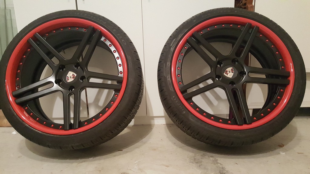

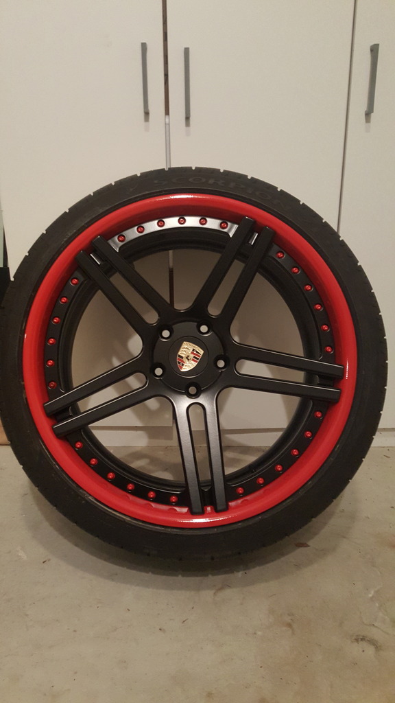

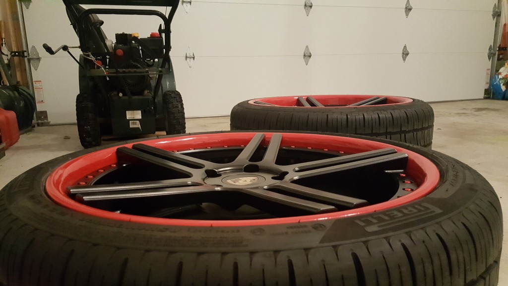

I asked a question here earlier in the thread and now can chime in. Most people recommended 315/30/22 on a 22x11 rim (for my rears) but I had a great deal on a set that was 295/30/22, was afraid it was stretched but it turned out just right.
Offsets are both 61 and i have 15mm spacers to end up at 45mm front and rears (very similar to the vivid racing panny specs with their Vorsteiners). Just waiting for all the snow to melt here in NJ and will mount them up in a week or so. Will provide additonal pics then.
Hope this helps some people.
3 Piece Modulare Forged Wheels. 20x11 rears with 295/30/22 Pirelli Scorpion tires.
Left is the 22x11 right is 22x9.5 on 265/35/22
Some mild concave action on the rears.

Nice. Looks a lot like the setup i have on my M550d.

Just A GTS - thanks for posting. I wasn't sure if the 265/35/22 would fit in the front without rubbing, as it's a 29.4" diameter. If it fits, I'm buying the same setup:
265/35/22 Pirelli Scorpion Zero Asimmetrico 420 A A
295/30/22 Pirelli Scorpion Zero Asimmetrico 420 A A
3 Piece Modulare Forged Wheels are one of my favorites for the Panamera, nice choice - looks clean with the OEM center caps.

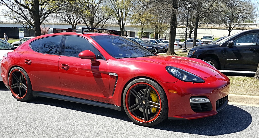

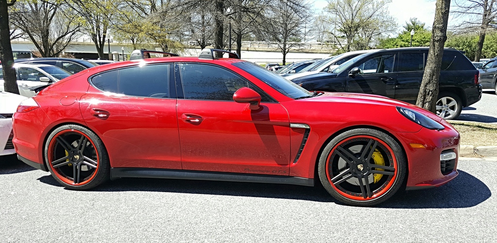

I apologize. Just installed them on Friday night and took a 4 hour drive from NJ to DC. Here is a quick phone photo I just took. I added 15mm spacers on all four corners to make them flush. Only issue is when I turn left my right tire rubs the inner fender liner towards the door side. I suggest getting a 255 of you have a 9 inch width front tire. Just to add this is the lowest setting on the stock air ride, I'm pretty happy. Will hopefully provide better photos soon.
