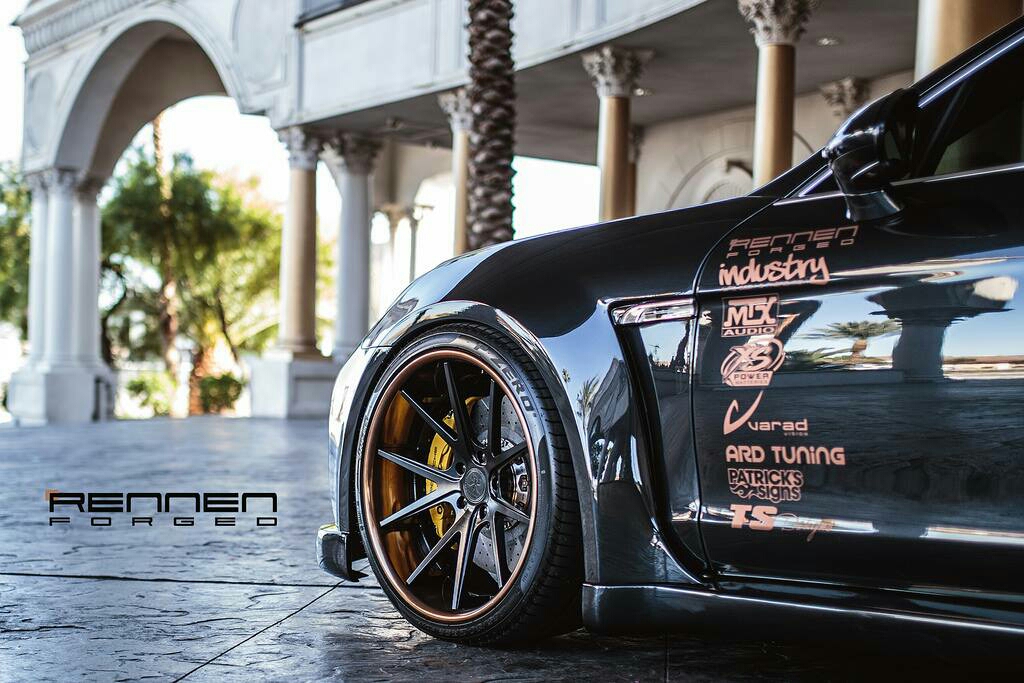

I run a 285 and 335. I'm running 10.5 and 12. Mine fit perfect with no rubbing before I put the widebody on it
I just saw pictures of your car. Nice with the widebody arches. But are you running spacers now? Since the wheels fit perfect before you widened it?

Congratz on getting the panny. I had new wheels made to fit perfectly on the widebody treatment. 2 different sets. I don't feel good about spacers. Let alone those big and with 700 hp. Just me

So you had 10,5 and 12x22" on before widening with no rubbing? What offset did you have then? I also want that size on mine

I'll have to look at the offset. If u contact a reputable wheel source they will know what offset u will need

Yes, but i will feel safer asking someone actually have tried it on their car. So would really appretiate if you could check the offset for me. Because the wheels im after does come in 12x22" on the rear. Super concave wheels. Thats what i like.

It def been awhile since I looked lol winter and she's been sitting in the garage next to my Dodge. fronts are 30 and rear is a 35. Def make sure what ever shop you get some from have the correct offsets.

Of course my widebody helps but ran the same tires before with a different set of wheels and fit perfect. Contact weiz at Rennen forged wheels fitment is great and getting some made for my didge real soon
