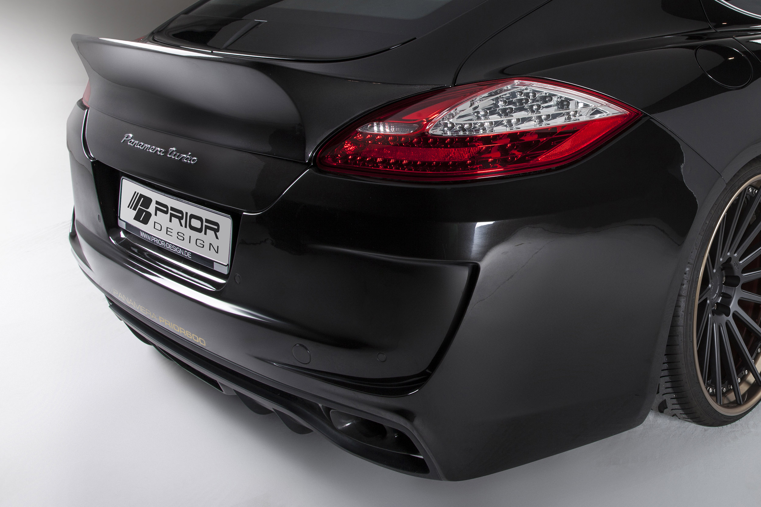

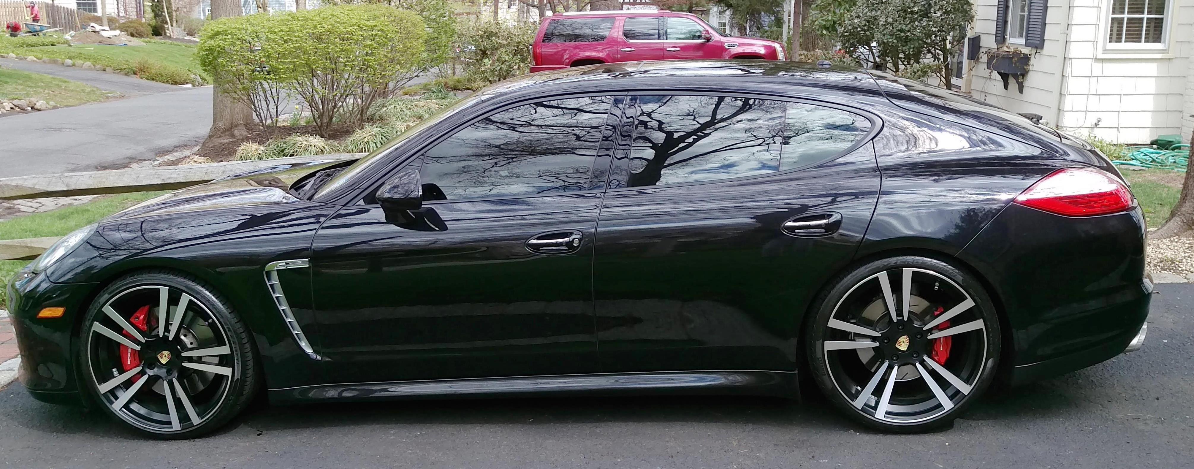

2010 Panno turbo equipped with following;
VRTuned piggyback ECU box. IPD plenum, FVD 3 inch mid pipe exhaust with center resonator delete. OEM sport /flap mufflers.
Lowering links for air suspension, 22's staggered with 265-30-22 & 315-25-22.
No rubbing even in lowest ride height position.
Pot holes are an issue. In two yrs. I have only bubbled one front sidewall with slight rim bend.
I also purchased Prior Design Duck tail. Not installed yet.
Performance wise the car is scary fast under boost. I also have modded 996TT. I believe the Panno could spank it in a roll on top end run.
See pic for sidewall & ride height set up.
Good luck

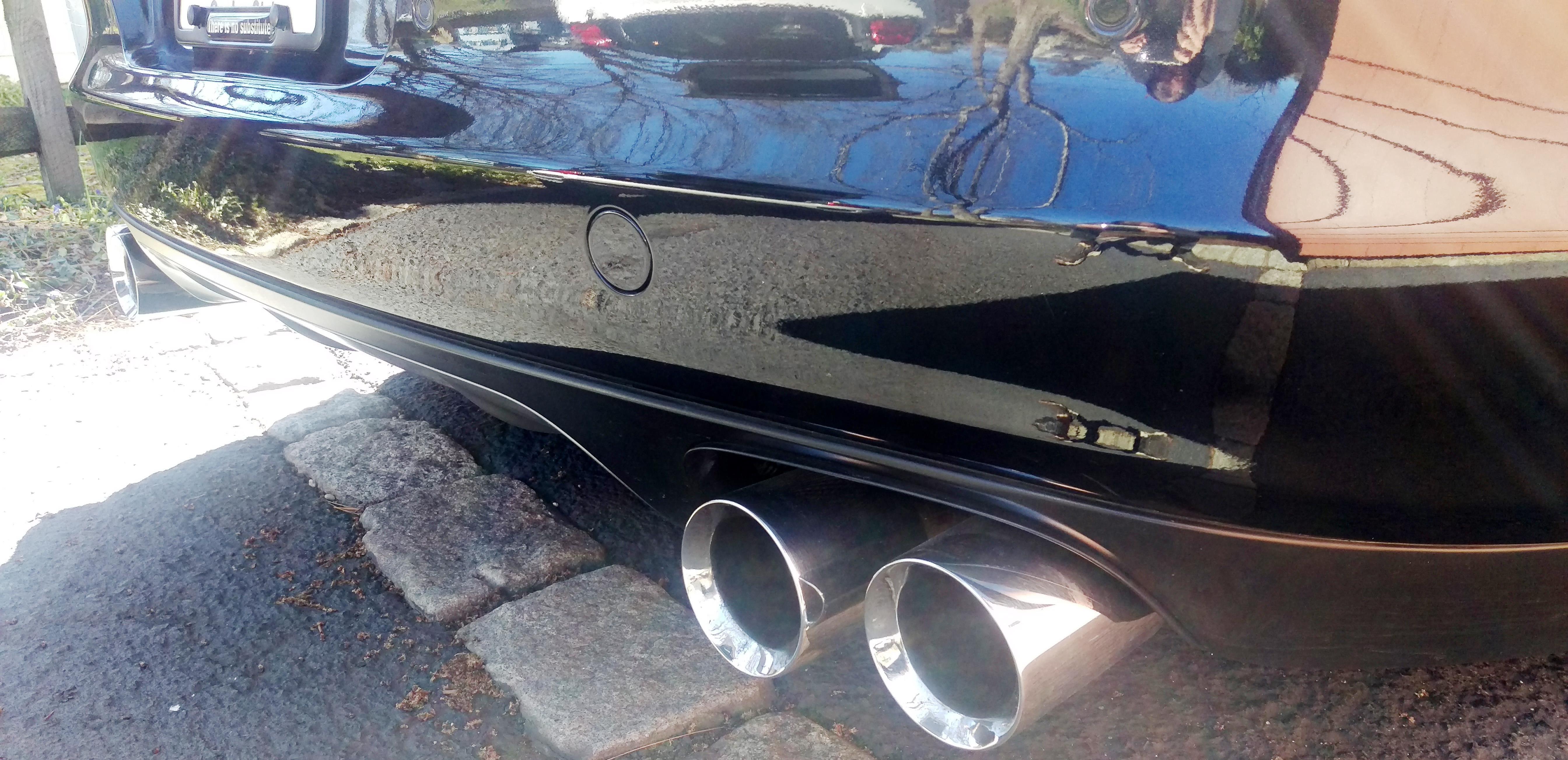

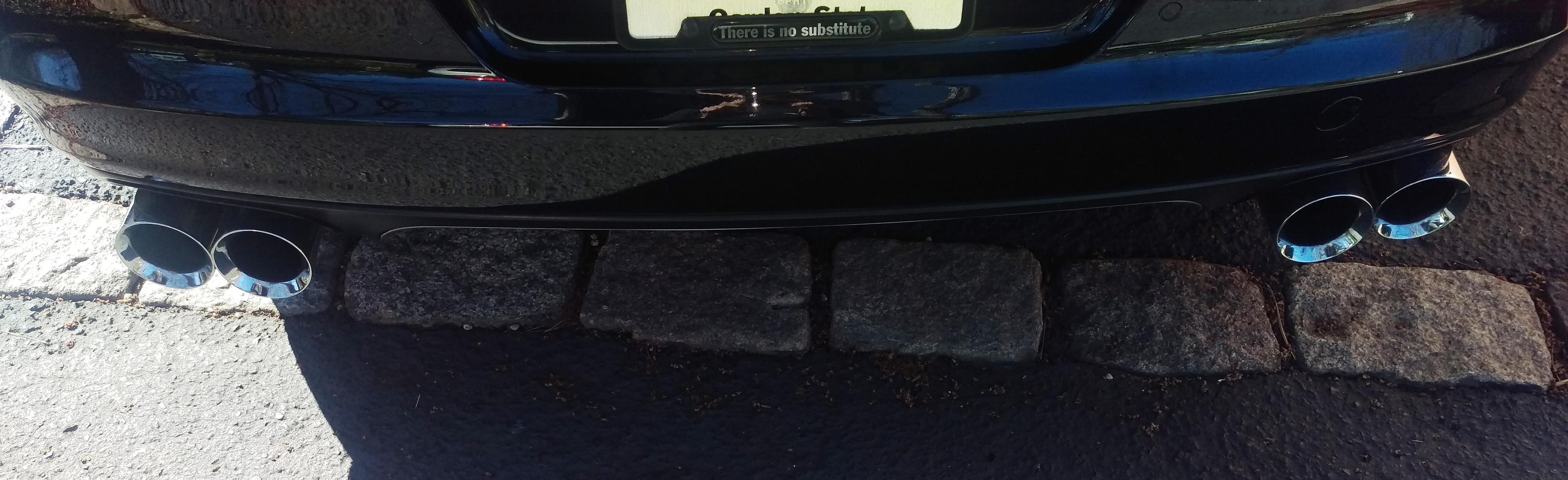

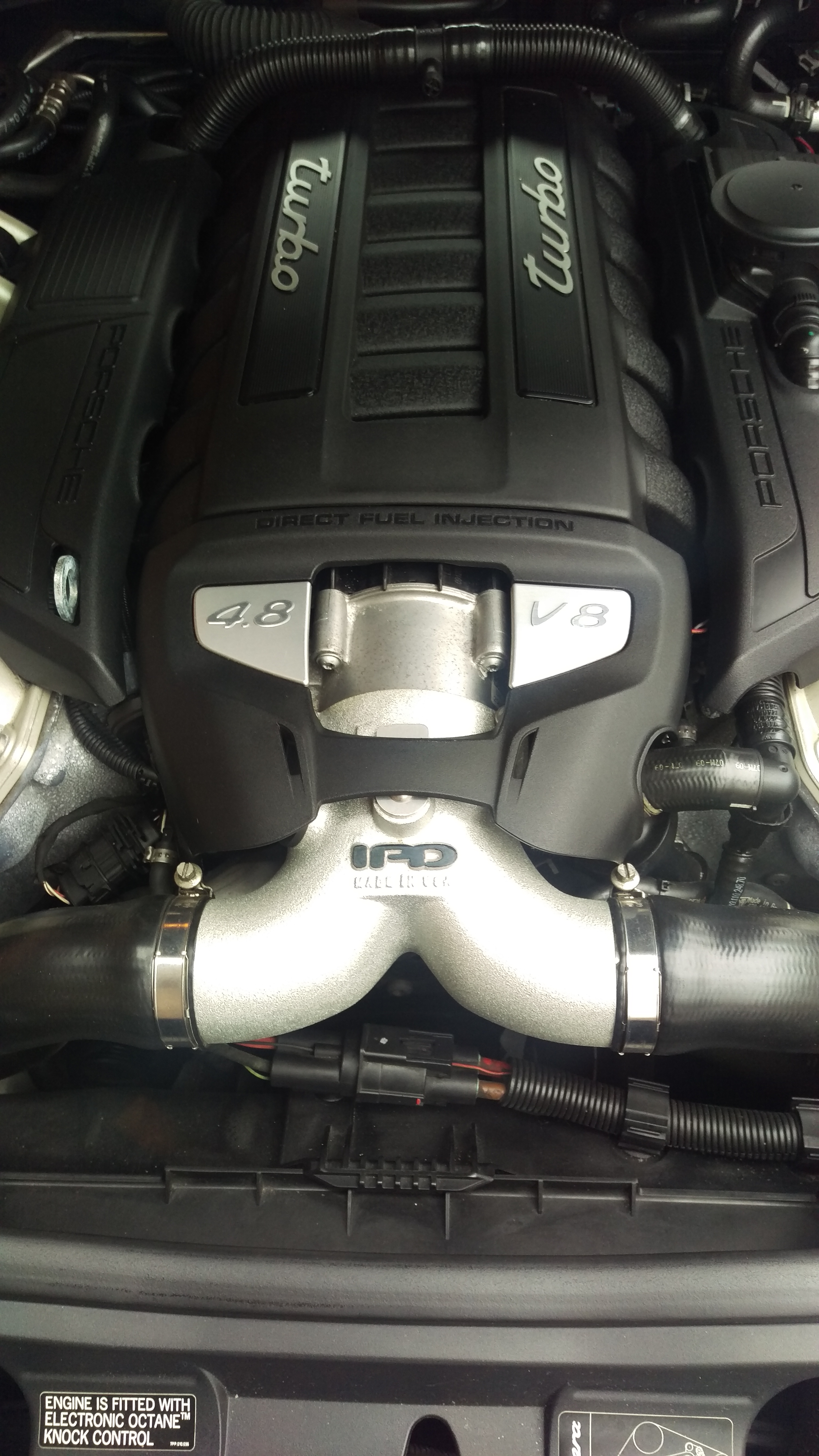

RDS993 - thanks. Looks like you have exactly the mods I had in mind. Few questions,
1) FVD mid-pipe delete with PSE. How stealthy is non-sport mode and cold start up? I.e. will my wife notice? She never presses the exhaust sport button. Any drone? If my wife can notice I'm going to pass on this mod.
2) IPD plenum - that seems easy enough, looks oem and easy to install.
3) thanks for the pot hole comment. I'm going to try and fit 285/30/22 all around (square setup) with Contentinal DWS06 (560 A A) or 285/30/22 front and 335/25/22 rear Pirelli P Zero (220 AA A). That's 28.7" diameter vs 28.1" oem. So .3" more side wall, hey ever much helps right! What tire brand and model are you running and what's your feedback on them?

The FVD (M&M of Germany) is super stealthy, but still sounds way better than oem. It sounds like exotic V8, nice rumble at all times & even nicer with flaps open on sport mufflers.002.MOV -
FVD exhaust sound clip :https://drive.google.com/file/d/0BxZaXENJw0o0Z19NMk1aaDZUM00/view?usp=sharing
FVD documented 12hp/12lb/ft torque with large diameter NON x-pipe design.
Wifey wont even notice except cold start up is an explosion/rhapsody for a few seconds.
I did IPD plenum my self in twenty minutes. Only trick part is pressing out the vacuum connection on the bottom of the oem plenum.
The VRtuned box ecu is 4 oem style plug & play connections. My shop did it in 30 mins

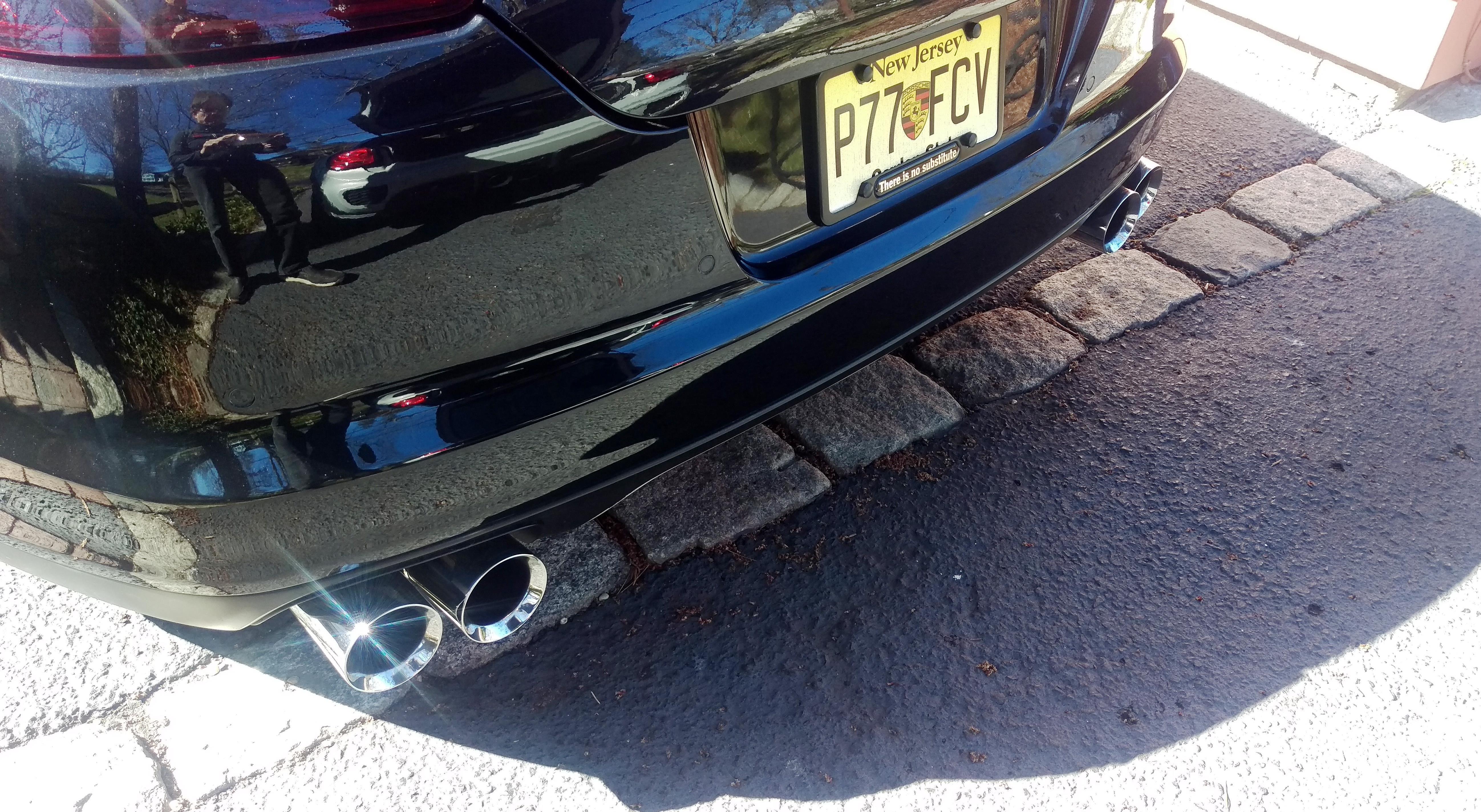

Originally Posted by RDS993
Nice, can you show some pictures of them installed?
Old Apr 2, 2017 | 08:25 AM
RDS993's Avatar
Joined: Apr 2010
Posts: 523
From: Short Hills NJ
Rep Power: 42
RDS993 is a name known to allRDS993 is a name known to allRDS993 is a name known to allRDS993 is a name known to allRDS993 is a name known to allRDS993 is a name known to all
Sure.
Here u go;
