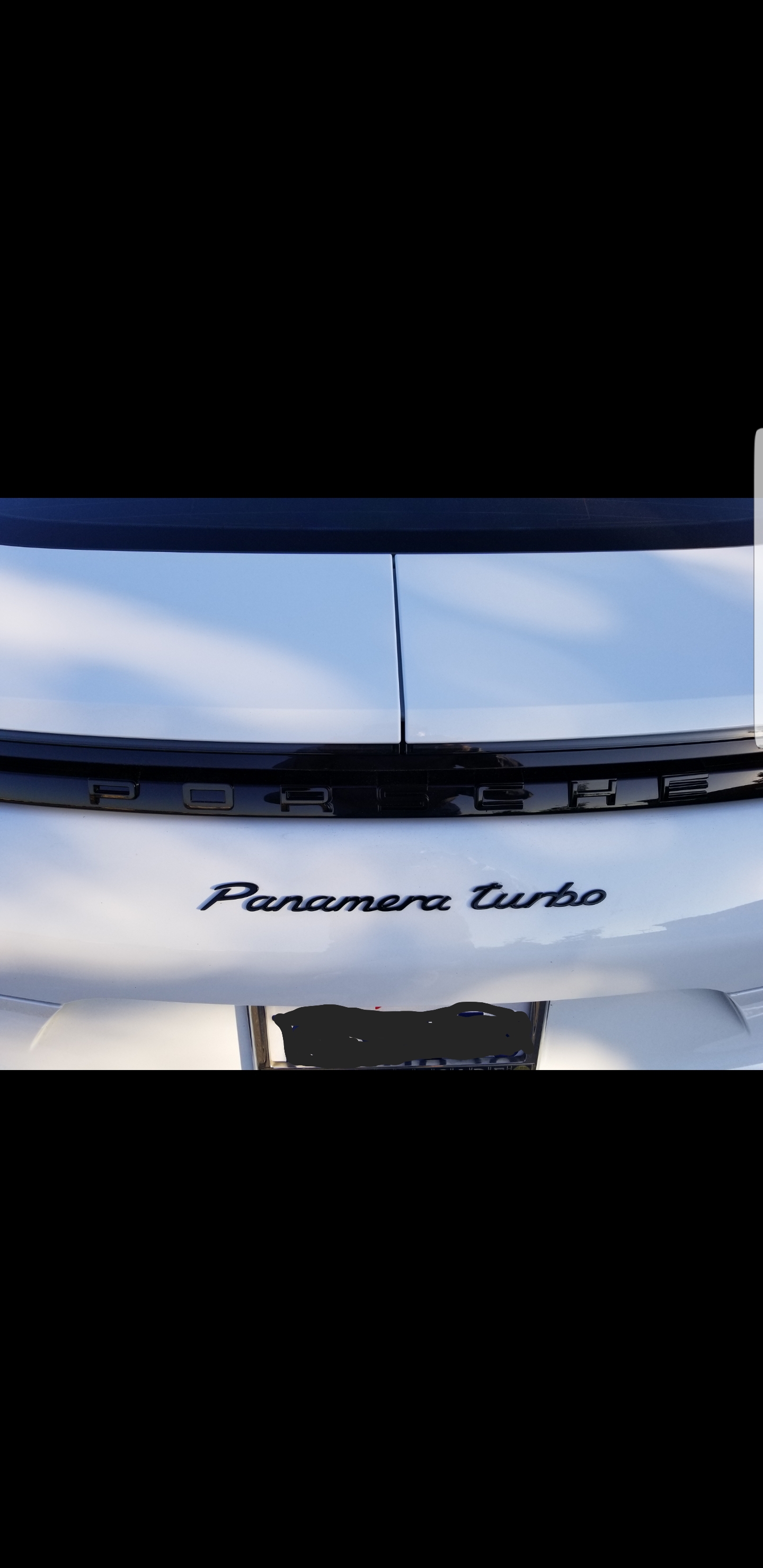

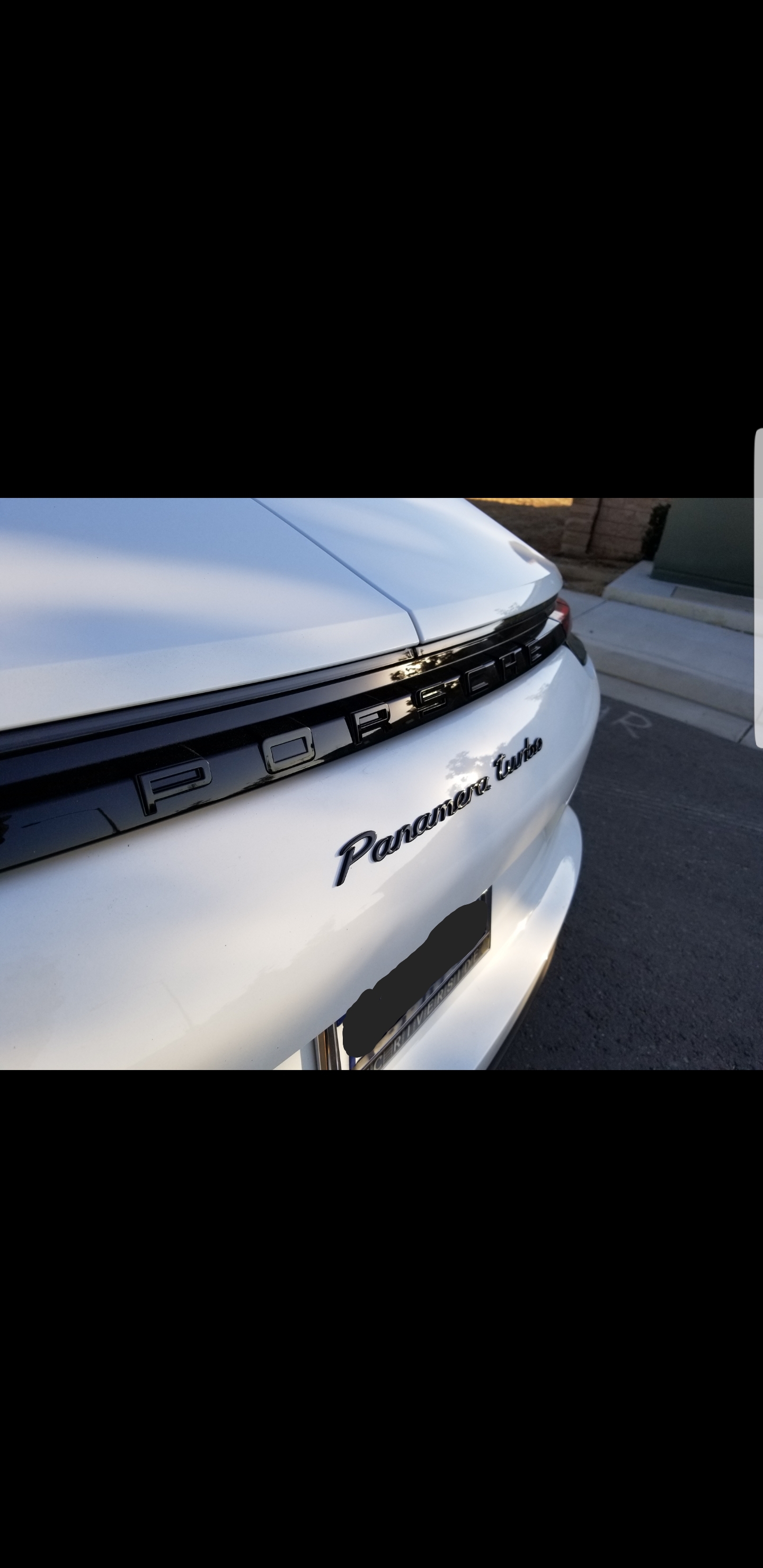

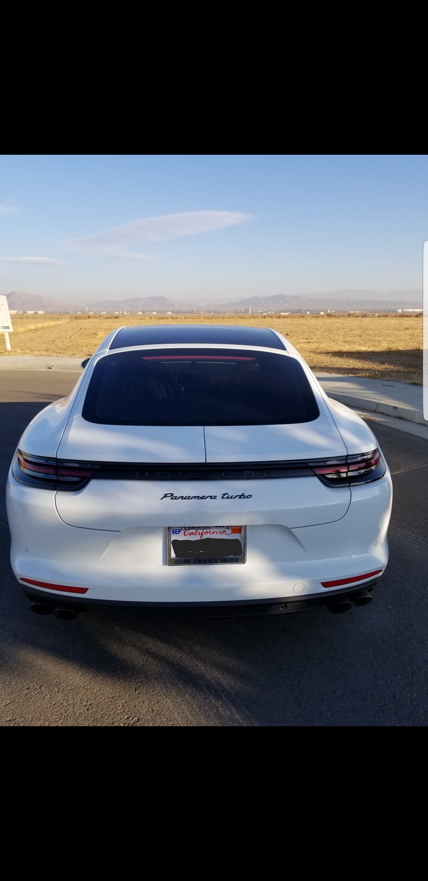

I installed the OEM tinted taillight kit and blacked out the "PORSCHE" that goes across the LED strip.
I absolutely love how both came out!
