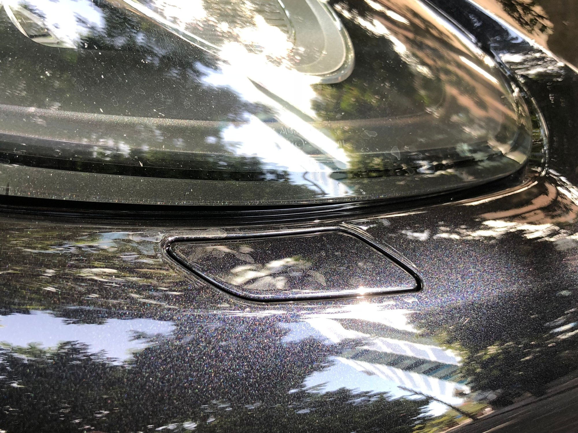

1) Headlight washers are no longer functional. If i had bought the updated headlight washers to suit the bar, then they would have worked. But i didnt bother with it. I had the headlight washer plumbing, plumb back into the washer bottle, so no leaks.

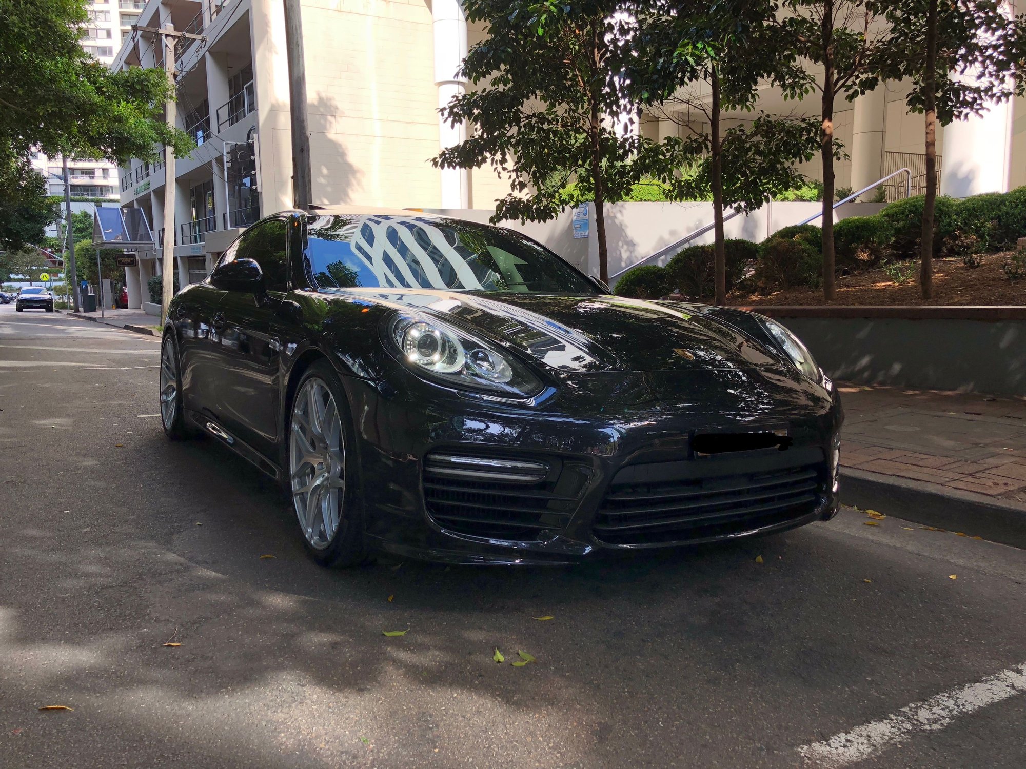

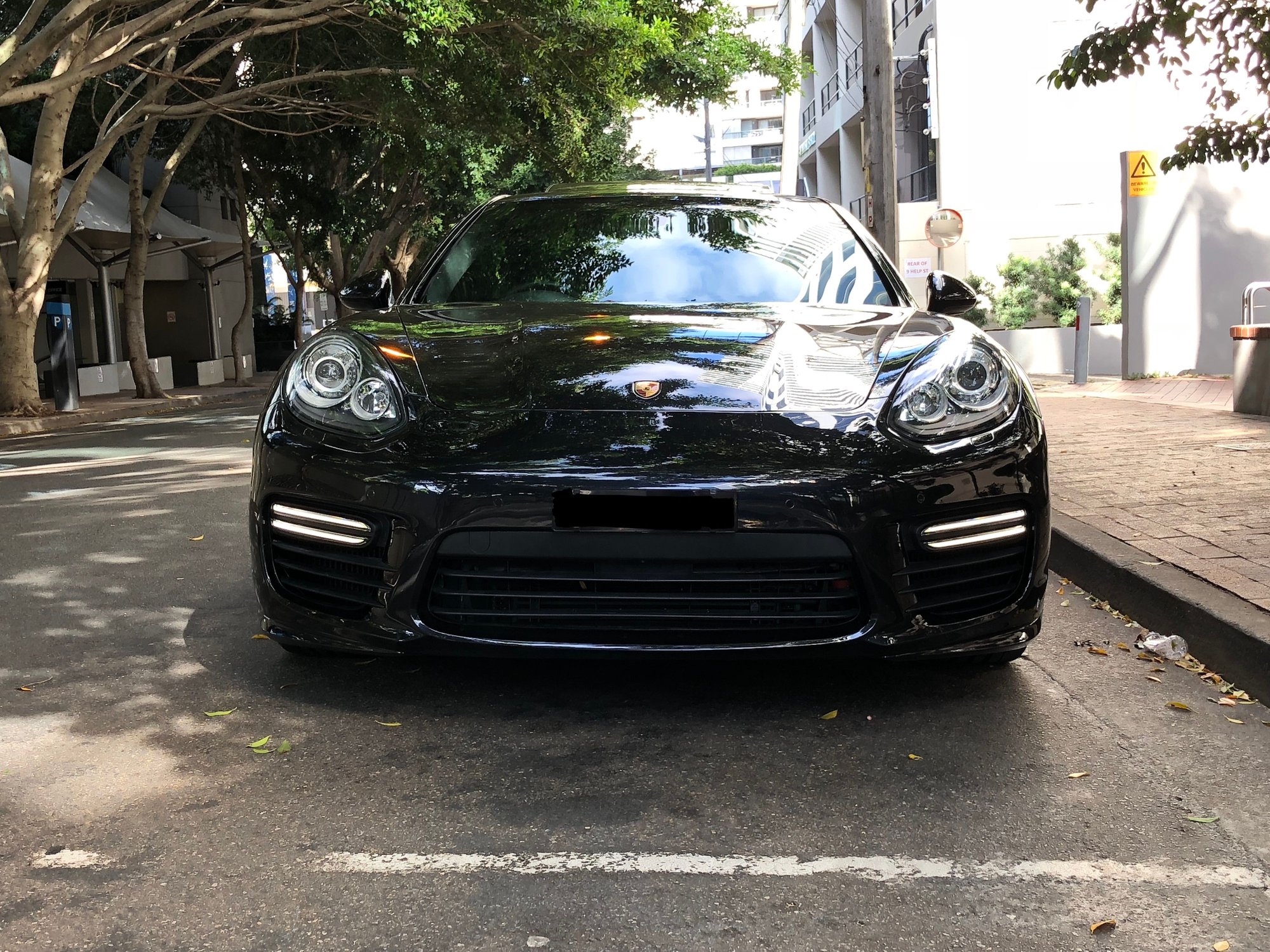

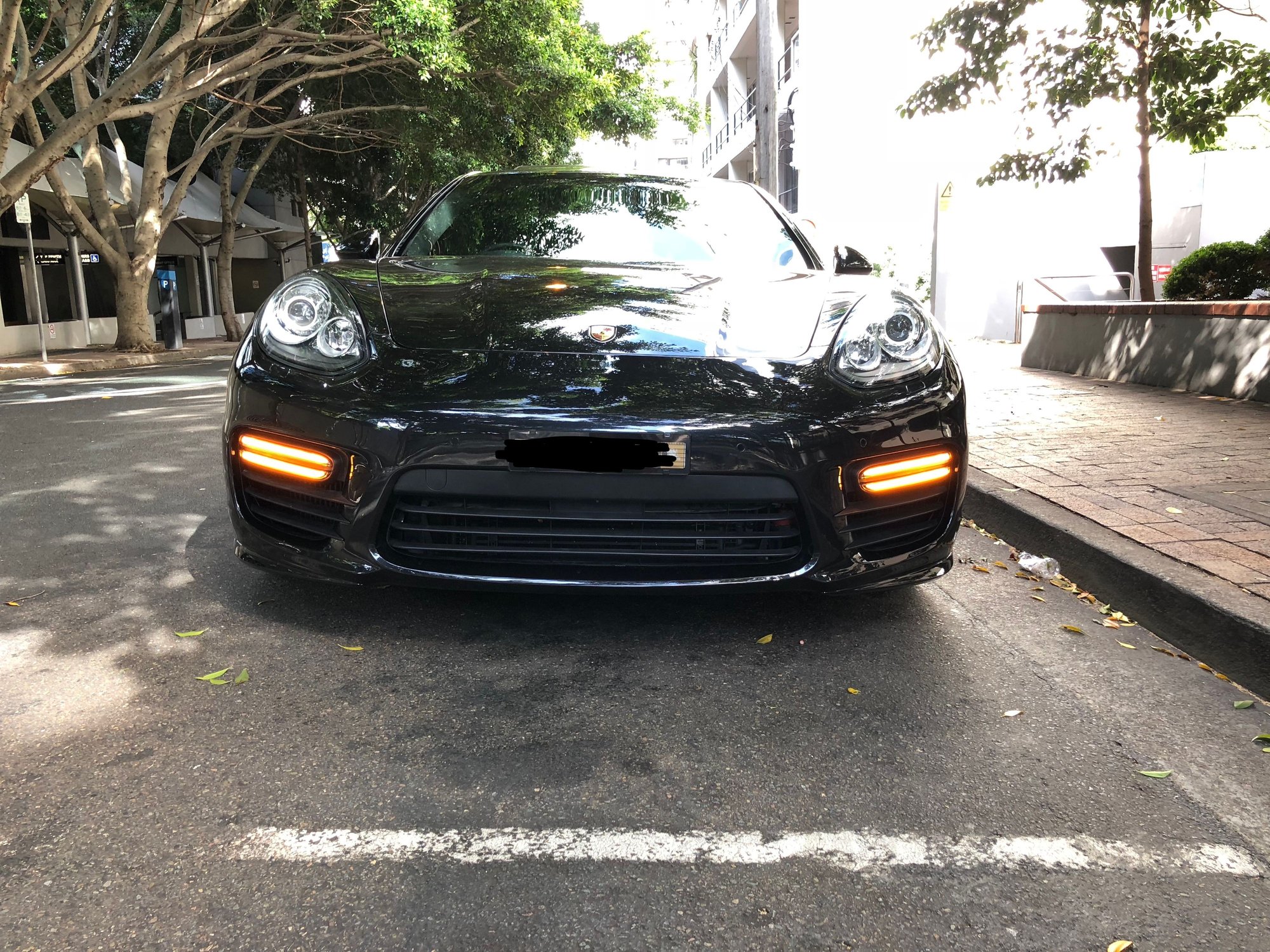

Old Feb 16, 2018 | 10:57 PM
amgpan's Avatar
Joined: Jun 2016
Posts: 210
From: Sydney
amgpan is infamous around these parts
Above is a few shots of it. With the DRLS on and the blinkers.

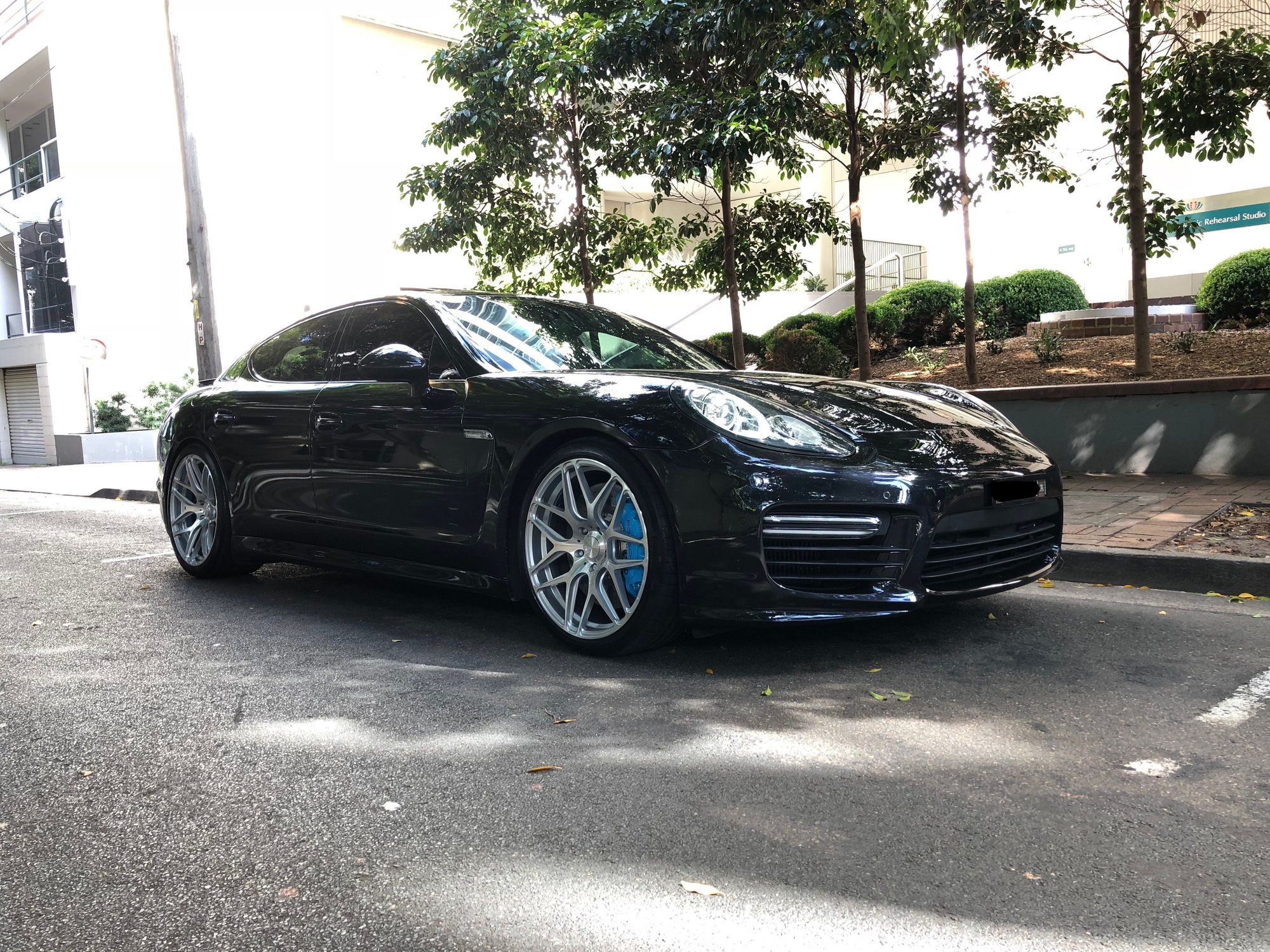

Old Feb 21, 2018 | 02:02 AM
amgpan's Avatar
Joined: Jun 2016
Posts: 210
From: Sydney
Thanks guys!. Here are some before pics FYI.
