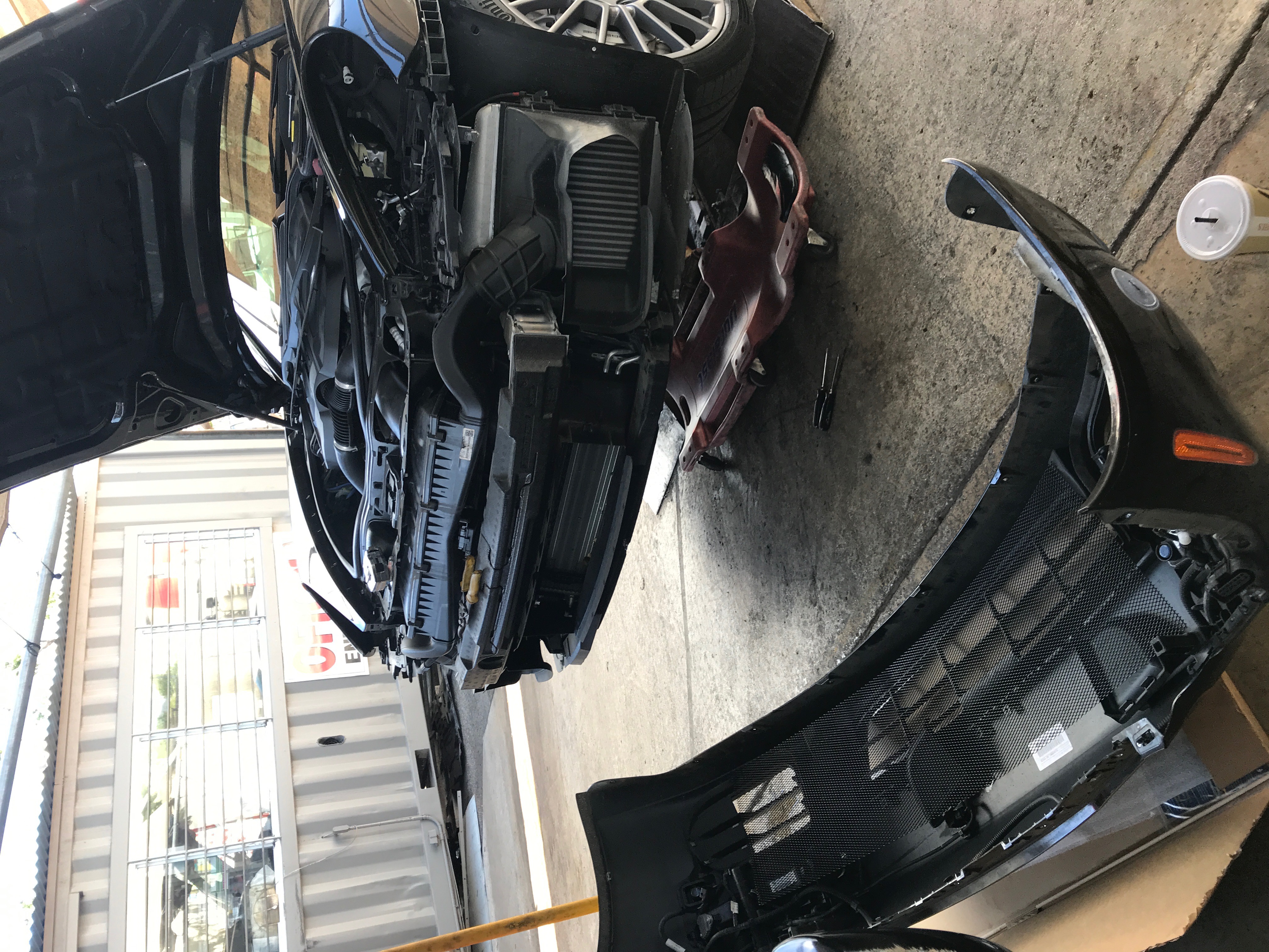

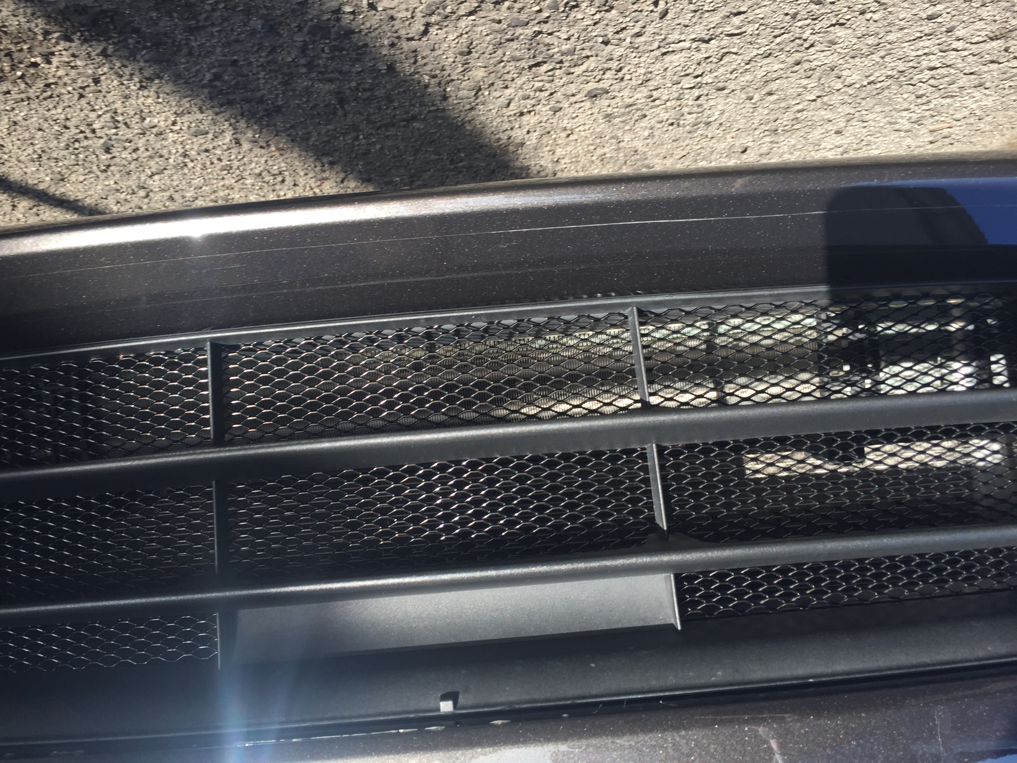

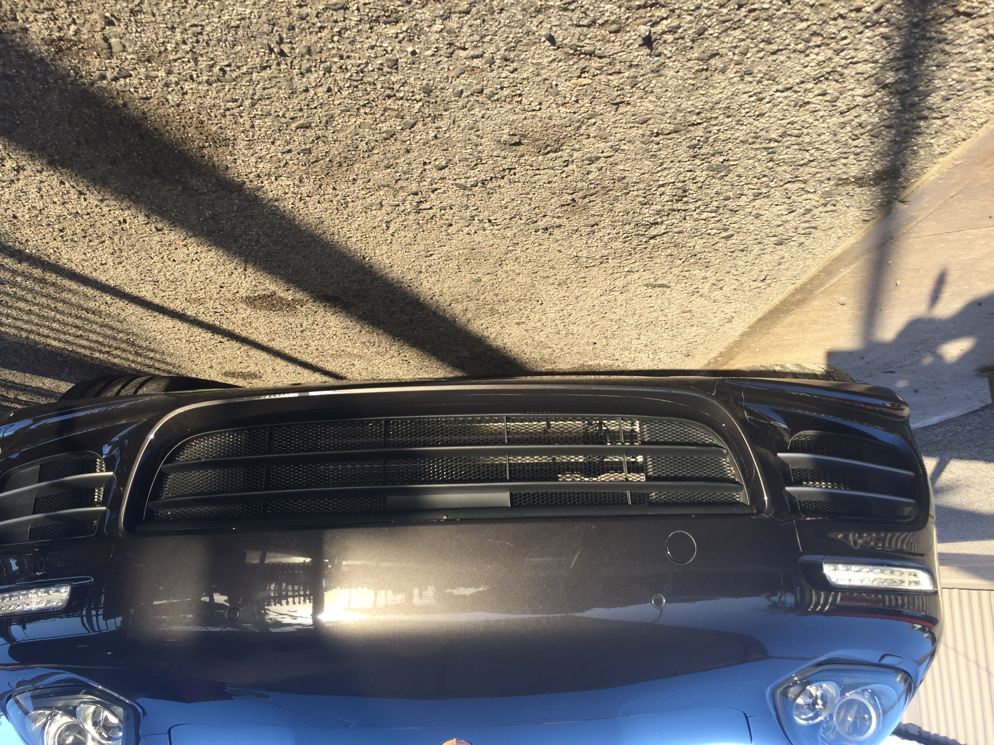

My P4S has exposed both the center and lateral radiators. Found a post in the 911 forum for a DYS project. Bought the black small diamond aluminum grill mesh sheet 12x48 at Customgrills.com for $49.99. Paid the local shop $100 for removing the bumper, cutting and installing the grills. Few years ago I purchased a custom cut grill kit from Renline at $299 and paid $150 to instal. Big savings if you buy the sheet grill. Sorry for the picture orientation!!
