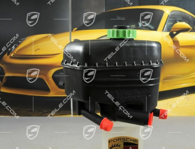

Have seen folks say its a real PITA to do. Started looking closer and found this photo of the tank itself. Somehow it does not appear to be difficult. There are 3 lines going to the tank.
Just guessing, if I was to remove driver front wheel and lining, I can get to that side. Then I could siphon out the fluid, protect the area with rags, etc, disconnect the 3 lines, and change the tank with a new one.
Anyone comment on the above, whether I am missing something?
Other folks were saying you have to remove the (serpentine?) belt, to get the tank out. I somehow do not see the need unless you are changing the lines too (unnecessary IMO, as I think they are metal).
Thanks for input. Below is pic of a new tank, showing where the 3 lines connect to it.

I have replaced the PDCC & power steering reservoir (with 3 hose connections & 1 sensor that is underneath). The power steering only reservoir has two hose connections & 1 sensor. It is not necessary to remove the wheel liner nor the serpentine belt. You will need some proper
hose clamp pliers hose clamp pliers
, because they are at an awkward angle, particularly the pliers with the cable extension and couple of the other pliers were usefull. There may be a plastic hose adjacent that has to be disconnected (1st photo - GTS & Turbo?) and the rubber gasket along the fender has to be lifted out of the way. Two bolts at the top of the reservoir has to be unbolted, access to the forward bolt is tight (2nd photo). Only needed 1 liter of fluid.

Yes, siphon the old fluid first. I used a turkey baster and covered the fender area. It will be unavoidable that the fluid will make a mess when you disconnect the hoses on the bottom. I stuffed a bunch of towels under and around the area. Rinse the area with low pressure water when done.
The hose remover pliers made it easy separating the hoses from the tank. I forget if the electrical connection was a quarter turn or a clip that you have to squeeze.
Note that I did not flush the rest of the fluid, thus only 1 liter of fluid for the refill.
Yes, if you were able to DIY the spark plugs, you can certainly do this.
