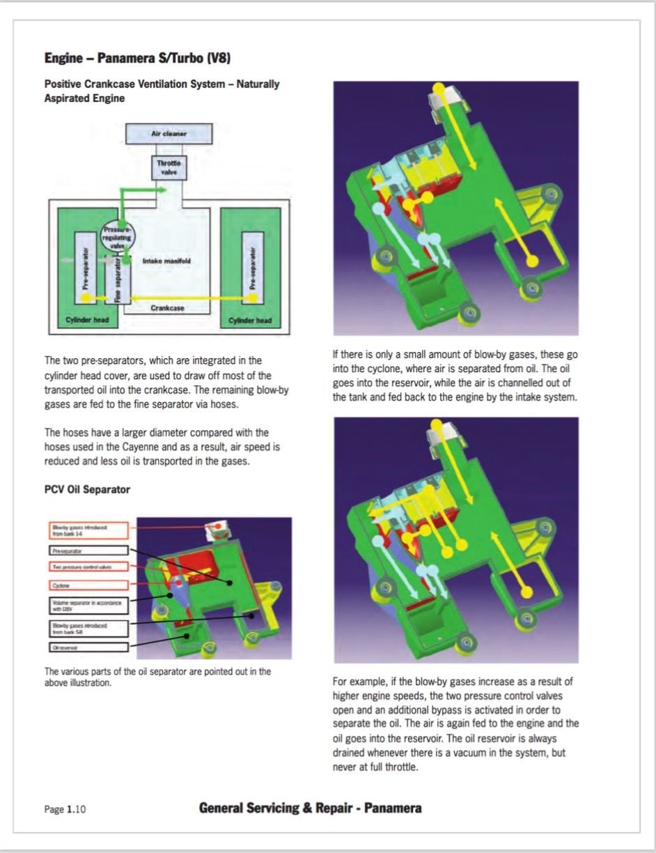

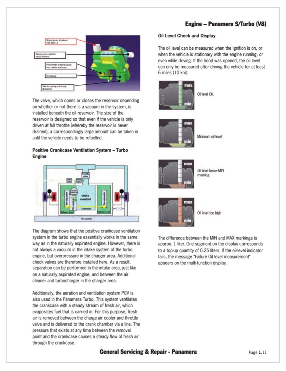

Here is some technical info from Porsche specific to the Panamera on the O/A separator and PCV system.
Hope this is of use.
