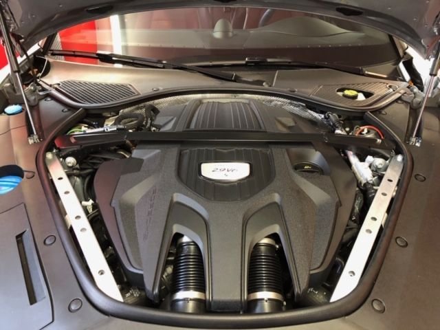

Looks like my plan for DYI oil changes is put on hod for now. The oil filter is located on the top of the engine under the cover. Problem is you can't get the cover off for access due the large bar going across the top of the engine. Even if you could get the cover off, that bar is in the way.

show us a pic.

In the first pic you can see the bar going across the engine cover. In the second pic you can see the cover for the oil filter. Had to place the phone under the cover to get the picture. The third shows the bolt holding the bar in place. a 16 mm socket fits but there is not enough room to for the socket and the head of the wrench on. There is a nut on the backside of the bolt. Can get a box or open ended wrench on the head of the bolt on the front but the there is no access to the nut on the back side for one of those.
Any suggestions?

First, I would recommend you look at vids for other DIYs of oil change on panamera, and decide if this is something you want to tackle, and if you feel confident to do it all the way through without quitting mid way. If you have doubts, go to a shop.
IMO, do not look at how much work and time it will take to do a job, but look at how awesome it will be to have it all completed. That will give you more confidence to do things on your own. Once you do few times, you will be glad you do them all.
I would strongly advise, before anyone starts doing DIY stuff on Porsche cars in general, to obtain the following:
- good service manual (FSM - Field service manual)
- diagnostic tool (I dont know what you can get for 2018 panamera - my '11 is good to go with Durametric - you have to research for your car on forums, not just this one)
Not having these is like working without lights, feeling your way around. Will waste a lot of time, and a lot of money guessing. So do it right, get them first.
Have you looked to purchase a service manual for this car? I did a quick check and see some download manuals for panamera 2018. Most of them cover all models, base, 4, 4s, gts, turbo, turbo s, hybrid, etc.
Buy one, download and search for oil change. Mine is a PTT, and oil filter is down low in front of passenger leg space. I have to put car on ramps, remove lower engine shield, remove oil cap, then access drain bolt to drain the oil, then remove oil filter housing with a 36mm oil filter socket.
For you, looks like you will have to remove the engine cross brace by removing the bolts. Looks like head of bolts is hex, so get metric socket set (harbor freight sells 8mm to 22mm for 12 bucks). I would get regular size, not tall, from 8mm, to 26mm, then 32mm, 36mm, and 12 point sockets 22mm, 26mm for various Panamera work.
Once you get the cross brace out, you will look at the plastic covers, and usually they have plastic trim clips to remove while some pop off with gentle tug on them. I dont know your car, so you will have to try gently.
Recommend you look at this video for 2010-2016 panamera V8. If you do not feel comfortable doing some of this type of stuff, you should take it to a shop to change (dealer will charge you a lot more than a good independent porsche/german car repair shop, something to keep in mind).

Once plastic is off in area of oil filter, I would:
- have car on ramps then disable air suspension if you have one
- remove lower engine shield
- locate oil drain plug (will be in the oil pan, which looks different from transmission pan that will have fins on the pan for cooling)
- remove drain plug (feel how much force was needed to remove, and apply similar to new plug when installing), and catch into oil container (walmart has them for 3 bucks for small plastic pans, or you can spend 20 bucks for enclosed ones that fit 15L (for larger jobs like transmission fluid, oil changes on panamera, mine takes 10L oil)
- let oil drain all the way
- install new drain plug with new washer, and tighten (careful not to be too hard, aluminum plug may strip and you will have to get that out for another job itself (dremel tool with cut disc, cut groove into plug stub, use large screwdriver to remove - a very fast summary) - SO DONT OVERTIGHTEN DRAIN PLUG.
- get funnel with long tube, so that it can go all the way down to bottom of car
- loosen but do not remove oil filter housing
- place funnel under the oil filter area, fitted with shop towels or rags around it to absorb spills
- unscrew oil filter housing and gently move out of the way while you catch oil into oil drain pan
- put new filter int housing
- replace gasket on filter housing
- install oil filter housing with new filter in it, back onto car (tight as old was to remove - specific torques available in FSM when you buy)
- clean area up with degreaser if you get it dirty
- put plastics back on
- put cross brace back on
- use diagnostic tool to reset service interval and you are done.
