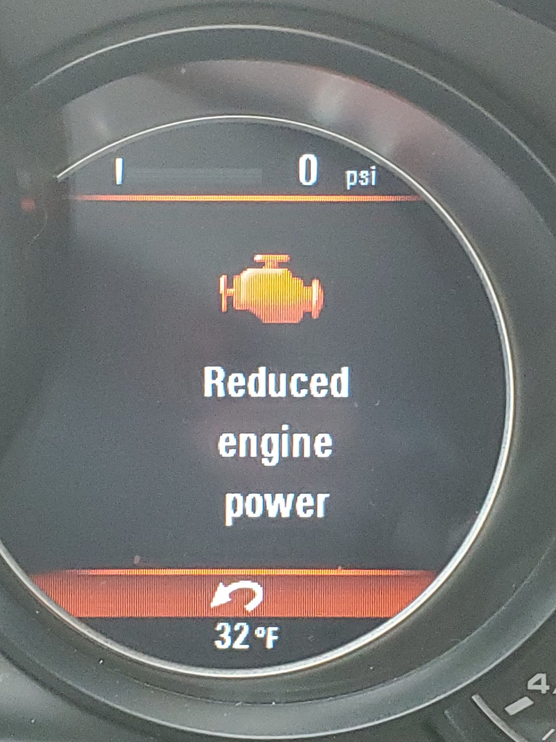

Do it all at once and save yourself the headache of having car in shop more than being able to drive it. All front suspension typically fails, struts, arms upper and lower, stabilizer links and bushings....I recently did it all still get crunching from cold, now I think fuel pump is bad

Originally Posted by panatela
what happened with your fuel pump
got this light today with code p1031 and it seems if you drive car with less than quarter tank of gas eventually pump fails sooner than later.....this will be a costly repair for sure

fuel pump should be that costly. Maybe the labor - I would do it myself personally, or find a good indy shop - dealer cost will be stupid considering they want $500 for an oil change which is $75 worth of parts and an hour of easy work....
Part is $1900 labor isn't the big worry

oh that sucks! Is it the engine mounted one? I hate this direct injection business....
Yes it is, driver side firewall
