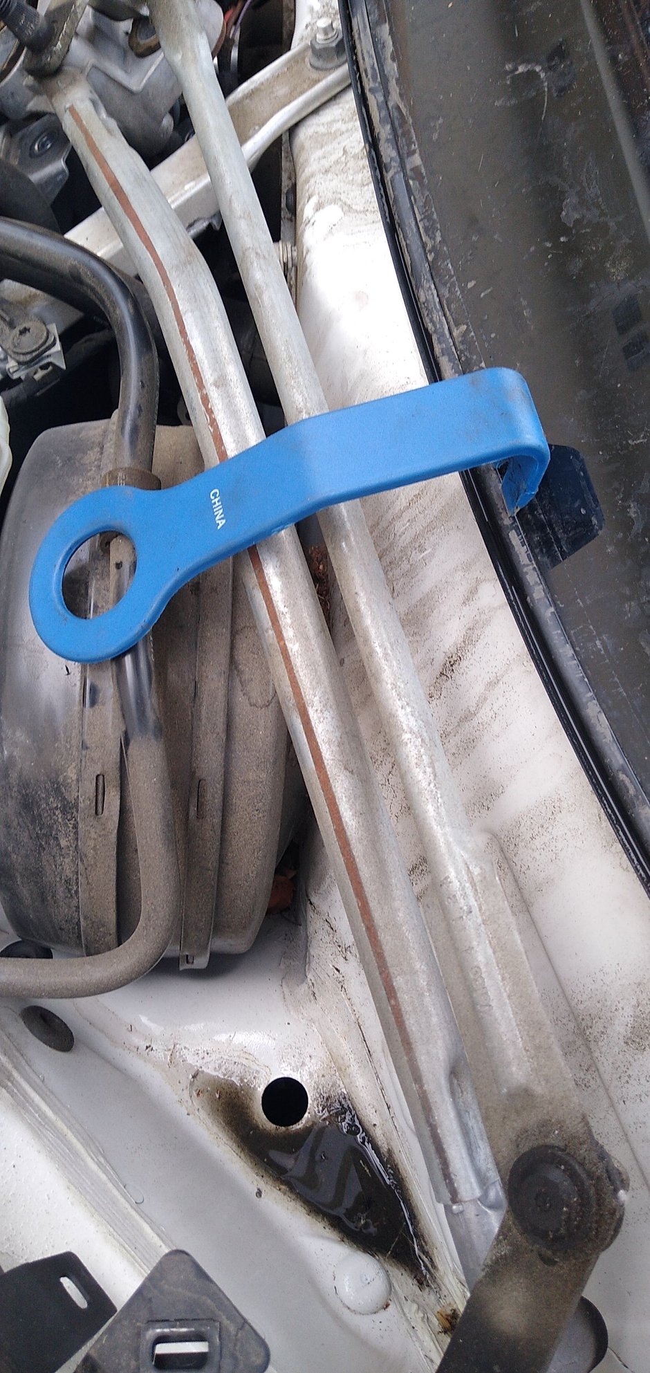

I got news the HPFP is on it's way. Purchased a Lisle 54150 at O'Reilly and popped off the wiper arms. I used a quarter to rotate the plastic screws on the cowl panel covering, rotate 90 degrees counterclockwise and allow them to pop up. Now I'm stuck trying to remove the cowl panel cover without breaking the windshield....

The proper pry tool helped me get the cowl cover off:
Next step is wiper linkage. Instructions note to remove power from the wiper motor so you don't accidentally disfinger yourself. I pulled fuse 48 on the left side of the dash. I pulled the right side fuse 47 for the fuel pump lest I forget.
