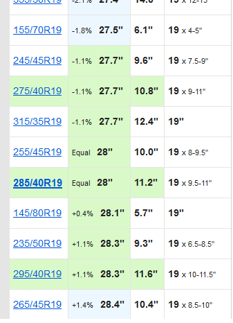

Is it possible to put smaller tires on 19 inch rear?
285/40R19 are damn expensive. I don't need the performance.
255/45R19 are easier to find and cheaper.

Seems to be the same rolling diameter. I think it should be ok, but mehhhh on going narrow tires ...especially on a PTT. You could go with a lesser brand maybe.

Walmart has Delinte Desert Storm D8 285/40R19 103Y for $128.79 each. Those narrow tires might not stretch enough to fit the wider rear wheels...

There is a wealth of tire information at www.tirerack.com. In particular, they offer rim width requirements for each tire size.
I have mounted "front tires" on wider rear rims on a Jaguar and Hyundai Equus with no issues over tens of thousands of miles.The limitation seems to be whether or not the tire can seat on the wider rim. Usually it can. But now you will find that your rim is the widest part of the wheel/rim assembly and thus more vulnerable to curb rash.
