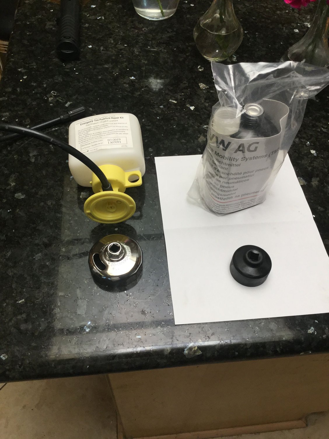

I’ve been wanting to check out the ‘15 Jeep Grand Cherokee SRT-8 at the local CarMax for a while now. But, I’ve been living with it, partly because I realized something....
Service items for my ‘14 Scion iQ on the left, oil filter and tire goo, $44 + shipping, $119 IIRC for the goo
Service items for the ‘13 Porsche Panamera GTS on the right, $11 at local AutoZone, $89 including tax for the goo.

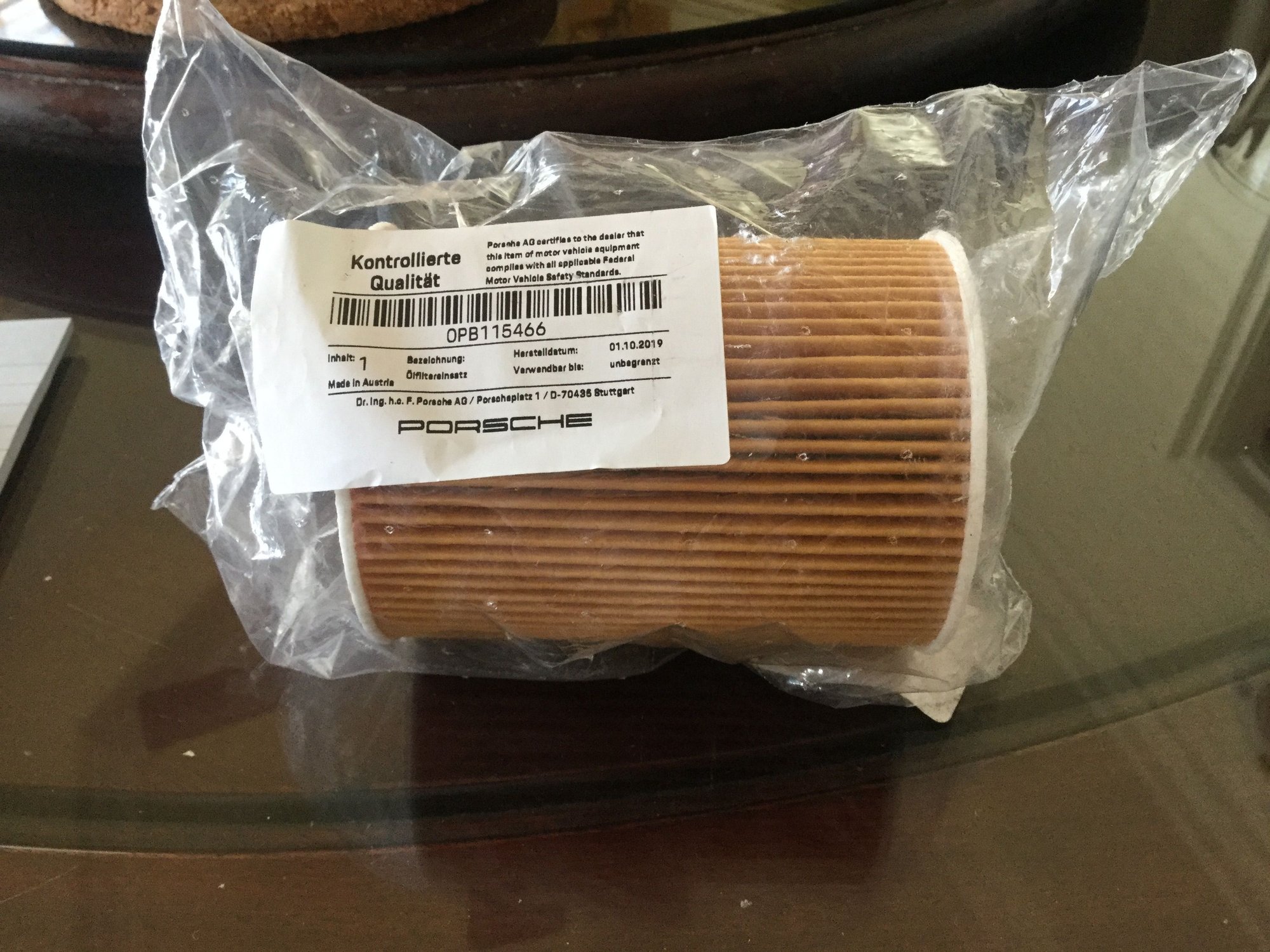

May 14, 2020 | 08:34 AM
What! Porsche oil filter (sourced from FCP Euro) does not come with a gasket! Darn, can’t complete the oil change!!!

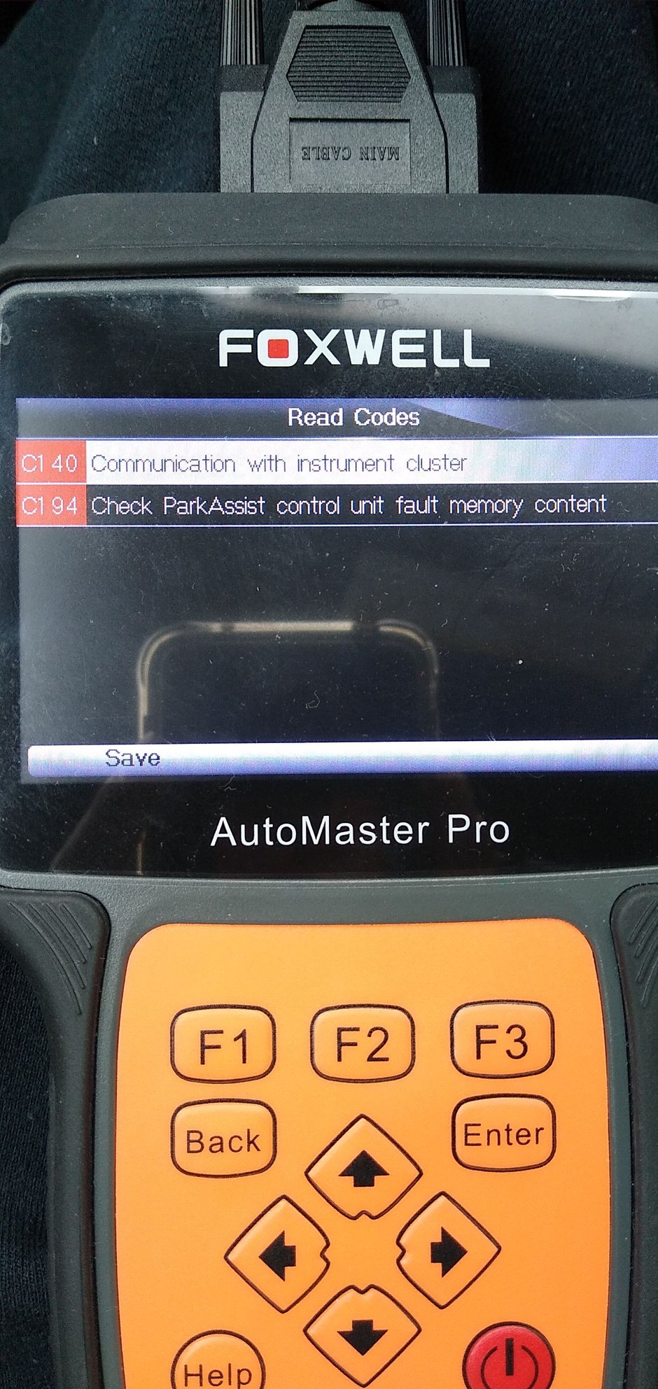

The first two pictures are probably unrelated. I can not erase PCM/CDR codes as it is labeled in the menus. (Not sure about the "CDR" part). Electronic parking brake code pops up once in a while, especially for sure if you leave the parking brake on while running a scan.
So the main issues:
P1027 Fuel high pressure fluctuates
P0171 System too Lean (Bank 1)
