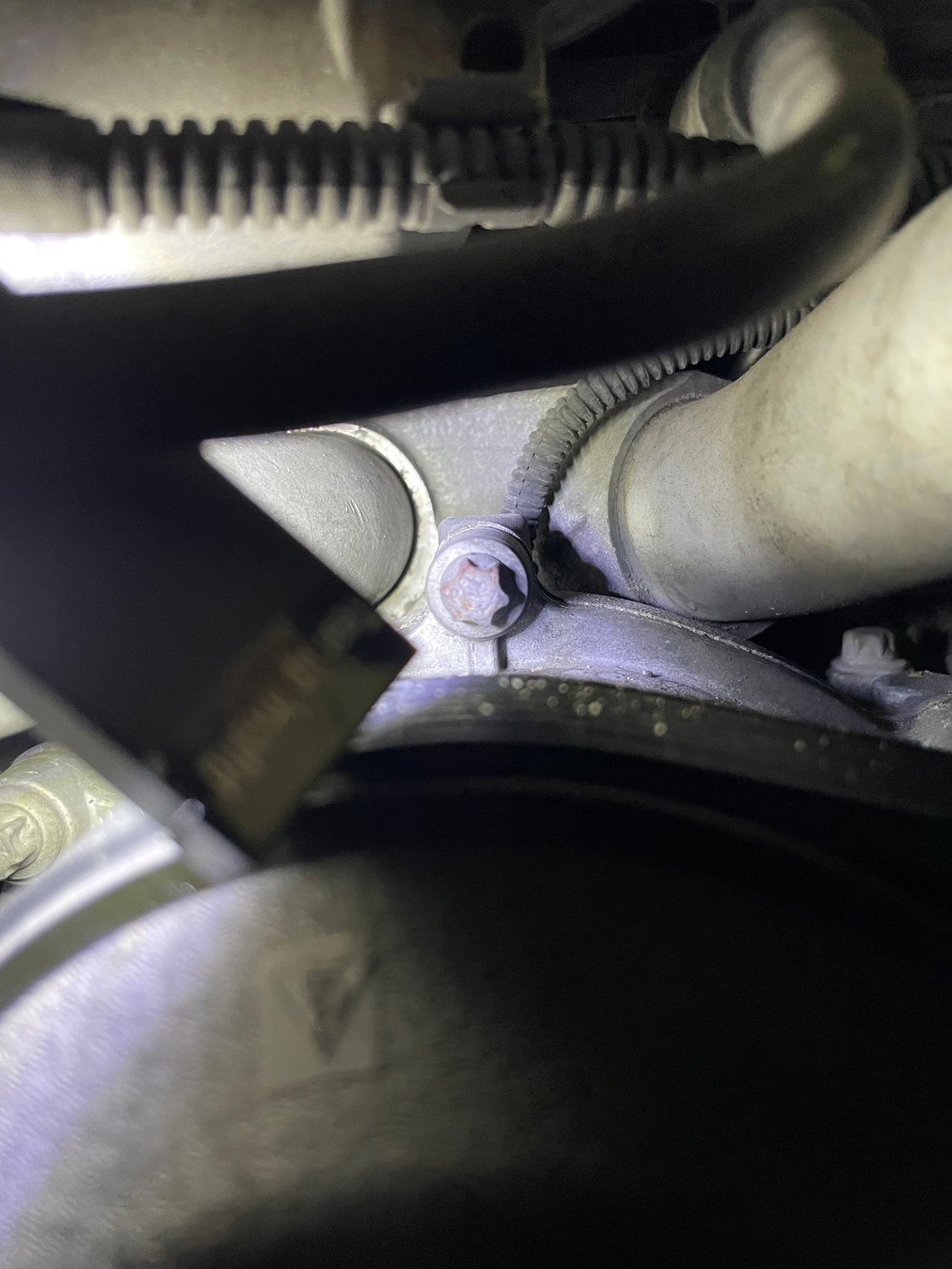

If you tackle this job, I recommend getting replacement orings for the pipe that plugs into the back of the thermostat housing. On my 2014, they weren’t sealing well in the new housing. Also the pipe had to be bent slightly when extracting the housing because you can’t pull the housing far enough forward to release the pipe. You have to lift the housing and that permanently bends the pipe slightly. That slight distortion will preload the pipe against the housing when you reassemble so it would be prudent to get the flexibility that new orings provide. I viewed a video on line for the V6 and they had the same problem and they had to bend the pipe quite a bit more due to the shorter length. You could avoid this by disconnecting the pipe at the back of the engine but that is fraught with several additional challenges getting the access to torx bolt. Loosening the bolt would help but lots of stuff is in the way.
