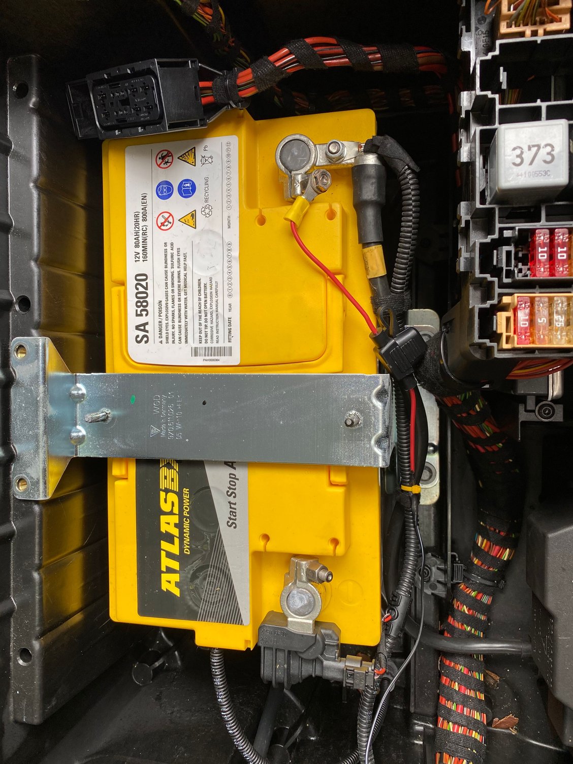

Installed the new battery while connected to the CTEK charger and didn't have to reset any settings. The process was pretty straight forward with the only issue being the hold down bracket being a tight fit. I suspect it may be due to the new battery being a bit wider.
Programming the new battery ended up being partially successful. In the Foxwell you have to input various parameters, the brand, the AH size, the serial and the part number. Some of the fields are drop down boxes with selections (brand, AH). I selected Moll, 92 AH, put in a serial the Foxwell provided as an example and put in the part number (7PP.915.105).
The battery change was accepted and the new battery is programmed in but there is a diagnostic setting called "Battery change coding" and is reporting "not OK". I assume this means it isn't accepting the battery as a valid OEM part or I have inputted something incorrectly like the part number. I did test whether the car has changed its charging and voltage is only reaching 14.6, so it is definitely using new charging rates.
Unfortunately, the battery is still losing charge, after installing the new battery (which I had charged to full before installing) I went away for a few hours and when I returned the battery had lost 10% charge, so there is a drain somewhere while the car is parked.
This drain is probably what was causing the voltage drops on the old battery and the drop in voltage then causes other systems in the car to stop working correctly. Many of the systems in the car seem to have a min voltage limit, if voltage drops too low they stop functioning correctly and then throw a voltage limit error/code.
The PDCC system is one of these, after changing the battery and resetting the codes on the system I noticed a remarkable difference in the handling of the car.
While removing the old battery I discovered a tap on the positive terminal. I wasn't able to trace what it was powering but I disconnected it and I've not noticed any change in the functionality of the car. Does anyone have any ideas on what this tap was powering?
Red line tapped into positive terminal
I didn't restore the tap when installing the new battery and I'm still finding there is a drain. Anyone got any ideas on how to diagnose the source of the battery drain?
............. snip..............
No idea; however, it is clearly NOT a Porsche component or a factory component from any other reputable auto manufacturer. They would never use a crimp terminal like that piggy backed onto the battery clamp bolt.
Look around for some kind of boot-leg device. Have you noticed anything like this in your rear window?

Maybe for a dashcam?
