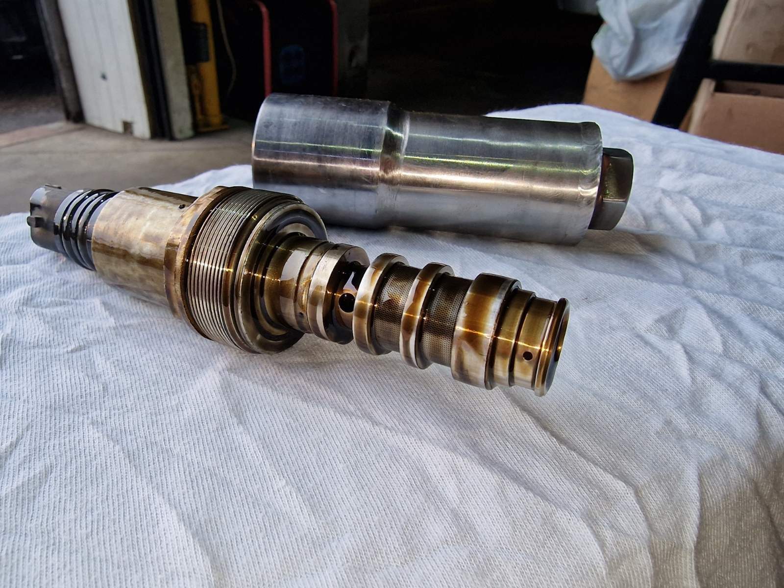

OK, measured it, flat to flat is 32mm
outside diameter is 38mm
inside depth is 80mm

Thank you very much! Now I will have to find a deep enough 32mm socket and somehow grind it to 39mm outside diameter. Hollow pipe wrench is another alternative.
Old Apr 7, 2023 | 11:28 PM
SRT88's Avatar
Joined: Jun 2019
Posts: 17
From: Bulgaria, Sofia
SRT88 is infamous around these parts
So finally the nut is 32mm between flats and it needs a very special socket in order to be removed!
1. At least 80mm deep (no more than 100mm in total length because of the engine mount being on the way)
2. Outside diameter must be no more than 39.5mm
I made mine @ the garage using lathe to turn it down from the outside then cut it and finally weld it to a 37mm pipe with a nut @ the back using tig welder. Several people were involved in manufacturing process...
​​​​I suggest you to order the special tool!

Could you let me know where you got the special tool? Do you remember it by any chance? I have this issue with my 2016 pan4 now. Porsche wants $1.2K to fix.
Thanks.
Old Jun 12, 2023 | 06:10 PM
DogWood's Avatar
5 Year Member
Joined: Apr 2018
Posts: 935
From: Bend, Oregon
Rep Power: 47
DogWood is infamous around these partsDogWood is infamous around these parts
Hey Doug, if you're willing to pay for shipping there and back I can loan you mine.

I don't understand why this socket is special. Why not just a 32mm socket like this? I suppose I will have to go to Autozone with calipers and measure the stated max O.D.
