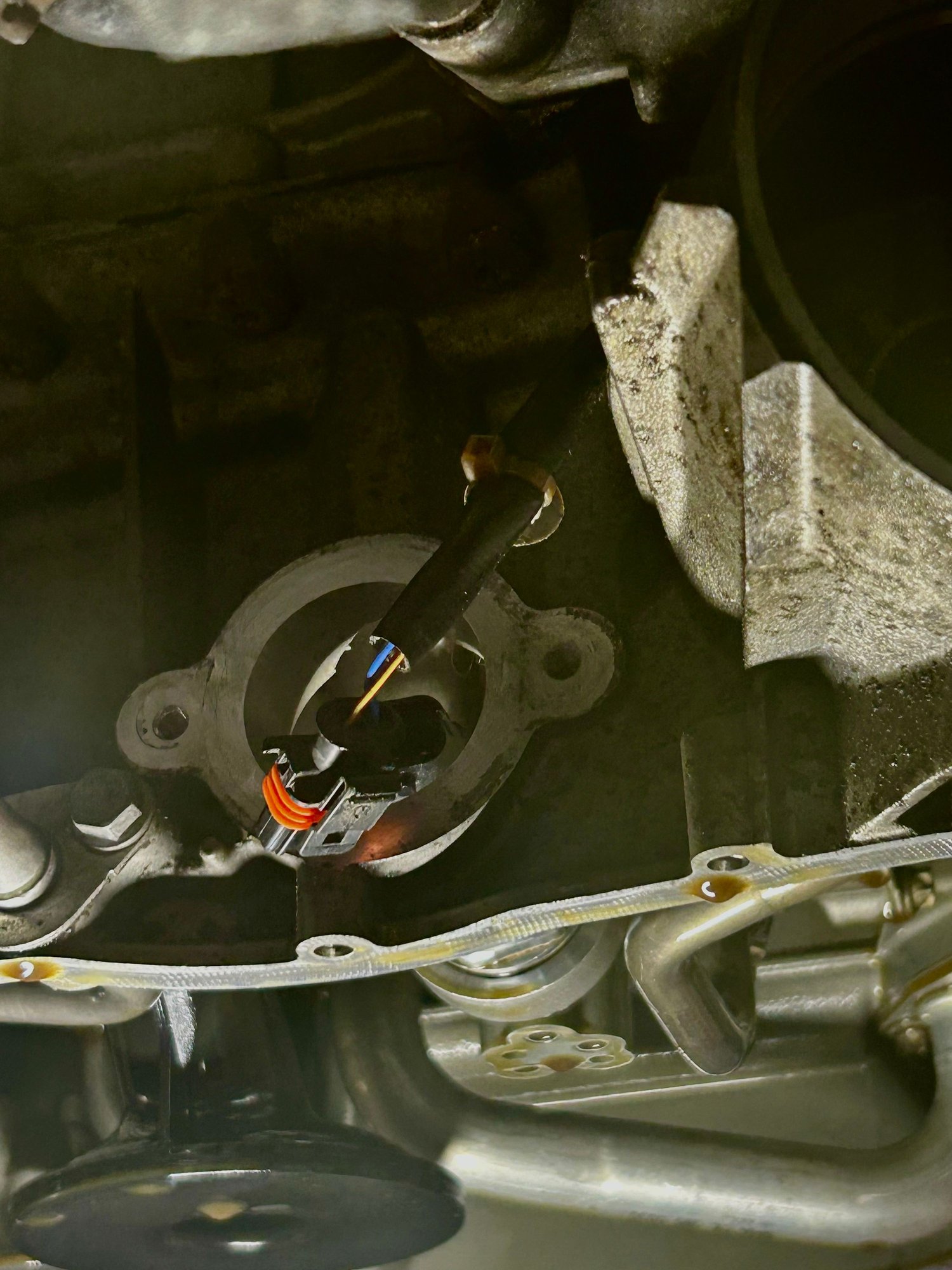

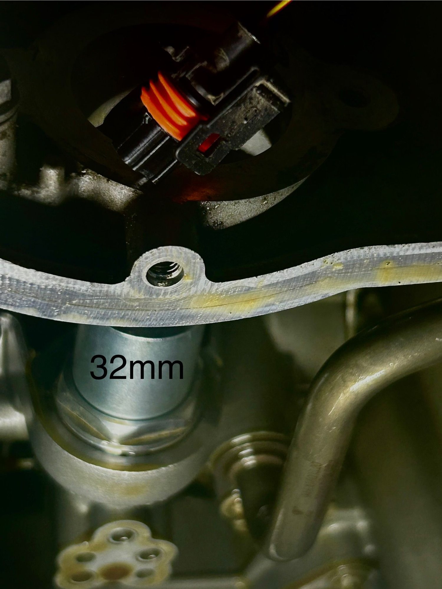

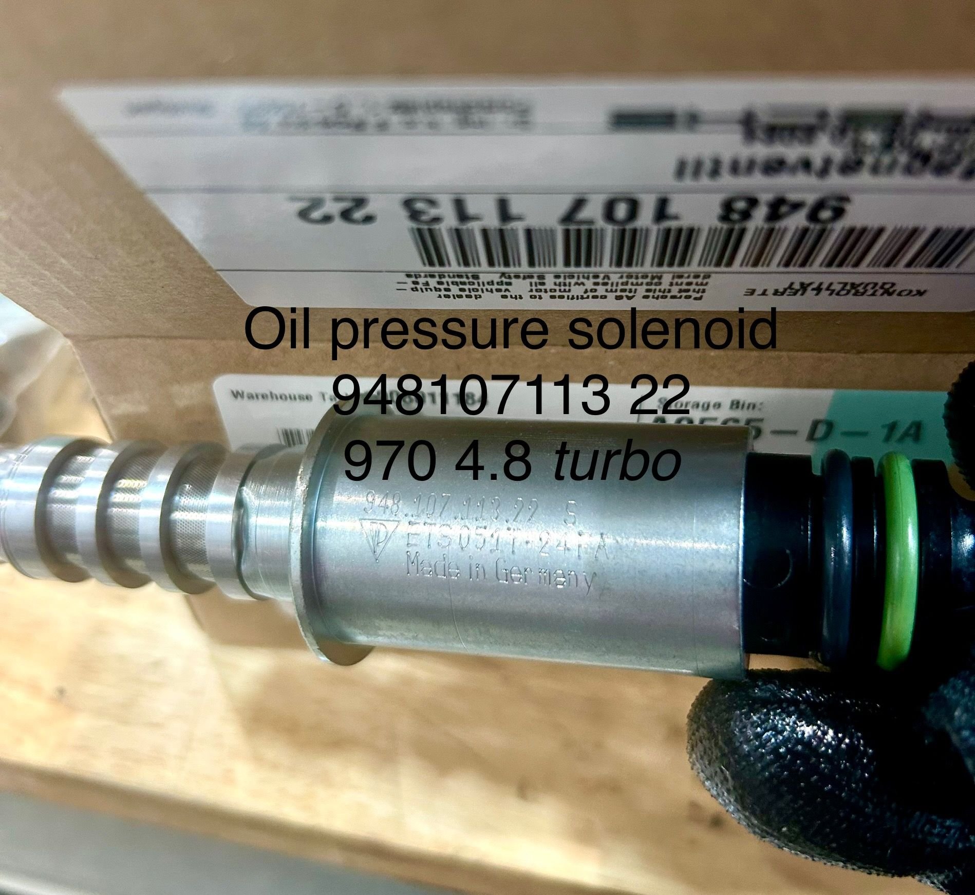

970 4.8 turbo oil pressure solenoid via oil pan removal
. If you can’t find the OEM 32mm thin wall 6pt tool or manage to lathe down a deep 32mm 6pt socket to 39.4mm OD you can drop the oil pan to R&R the oil pressure solenoid.
