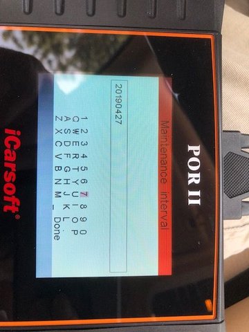

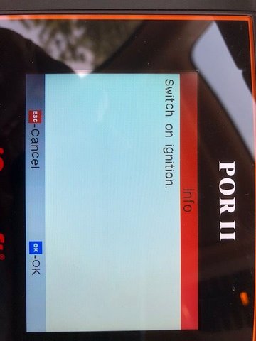

First time changing the oil on my 4S since I got it late last year, fairly straight forward and I had no "gotcha" moments. I then reset the OIl change reminder with a iCarSoft.

the iCarSoft is pretty easy to navigate
this one took me a few tries as I just scanned over the format instructions, so year month day
