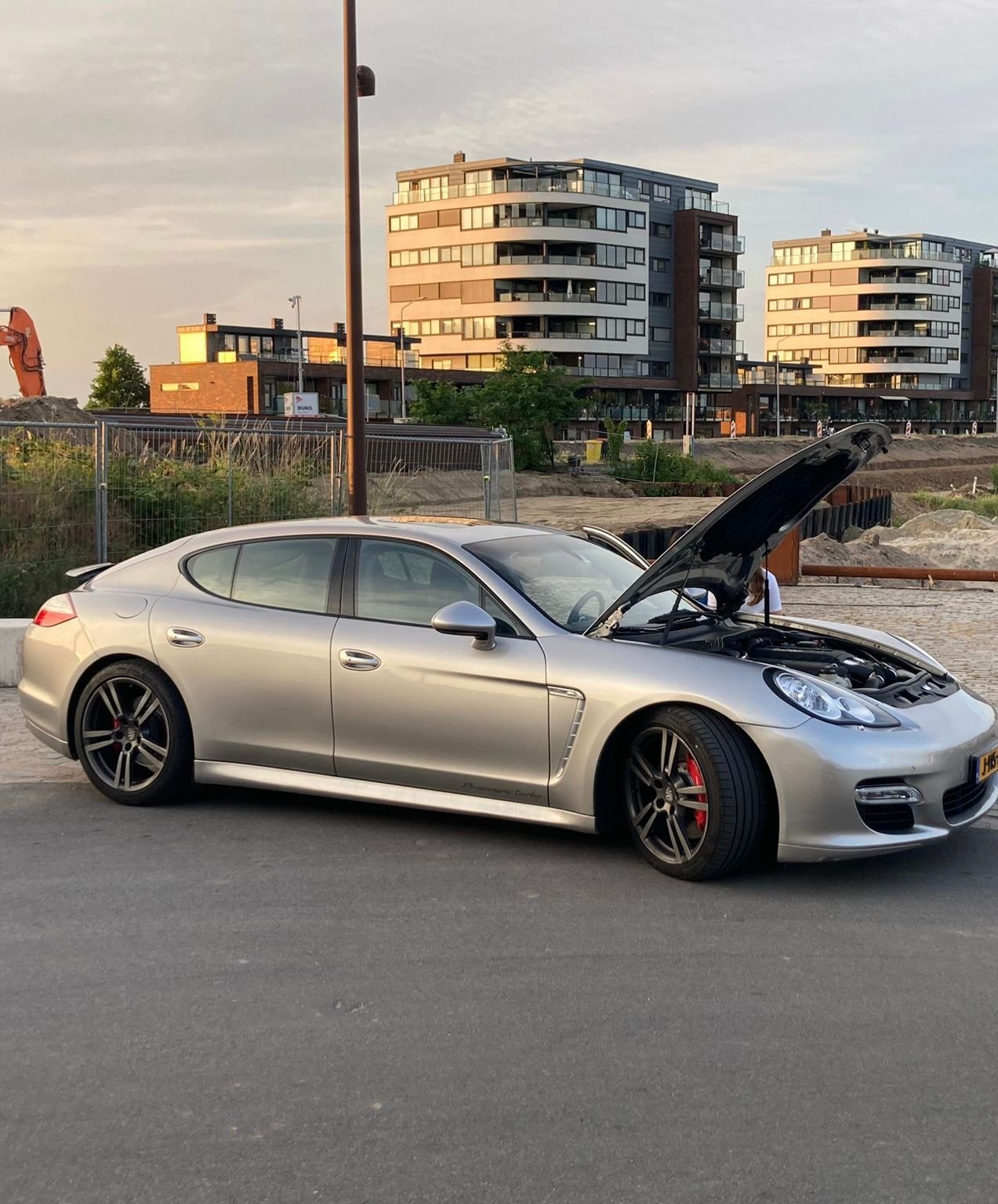

Good morning,
I was driving my Panemera
turbo 2010 when it suddenly started smoking with the message oil drum. The engine started to tick on one side so I immediately turned it off. After reading the car, the following error codes came out:
- P0346 cylinder row 2 camshaft position - g163 unmanly signal
- P0305 cylinder 5 cylinder misfire detected
- P0306 cylinder 6 cylinder misfire detected
- P0307 cylinder 7 cylinder misfire detected
- P0308 cylinder 8 cylinder misfire detected
Is this a known issue with a 970 Turbo? I think there is something wrong with the camshaft adjusters.
I'd love to hear what you think.
