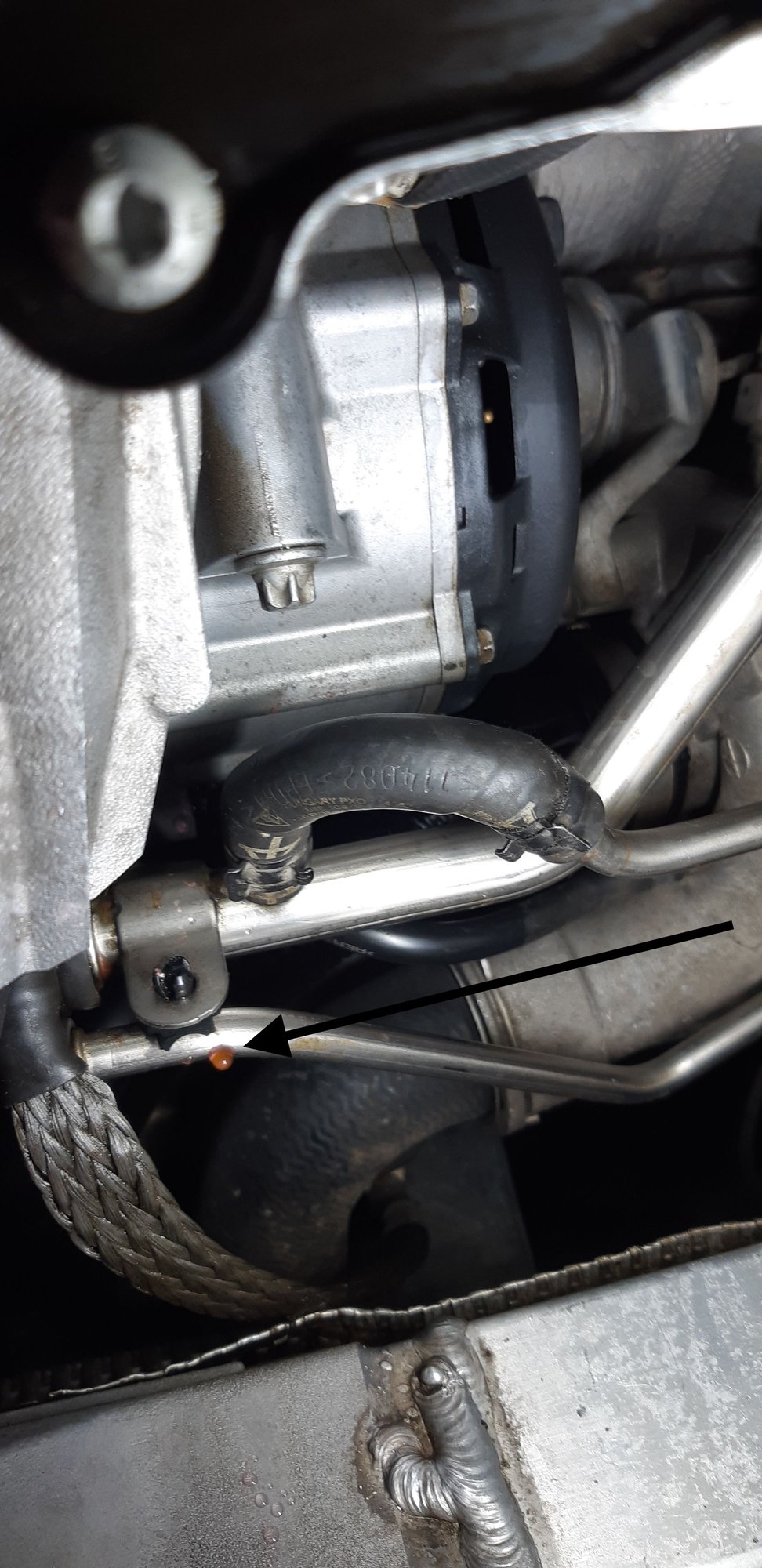

I just had an alert with a coolant leak on the right side under the car.
The source of the leak is the O-ring at the alternator outlet.
LEAK WITHOUT PRESSURE FROM THE CIRCUIT.
