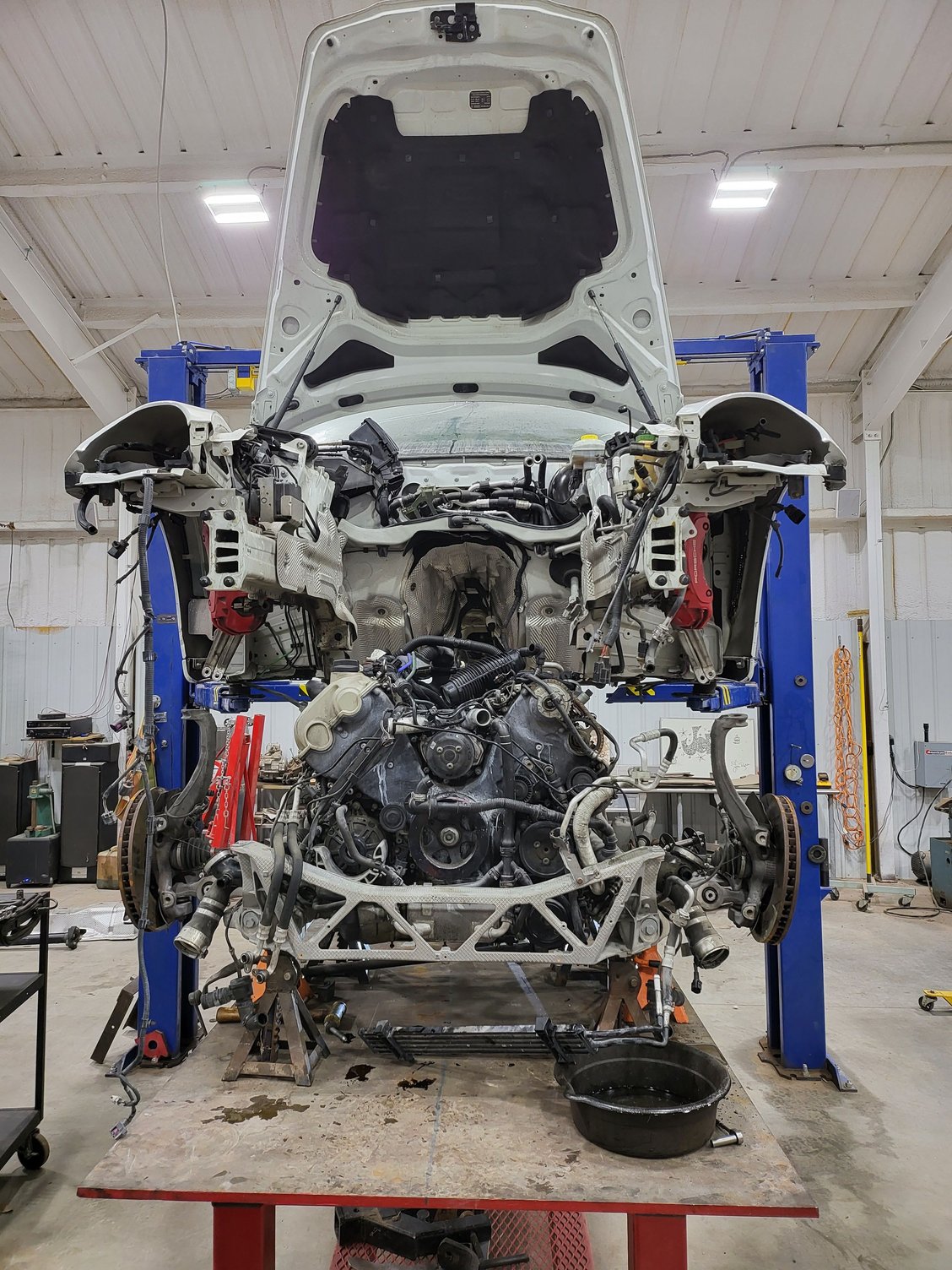

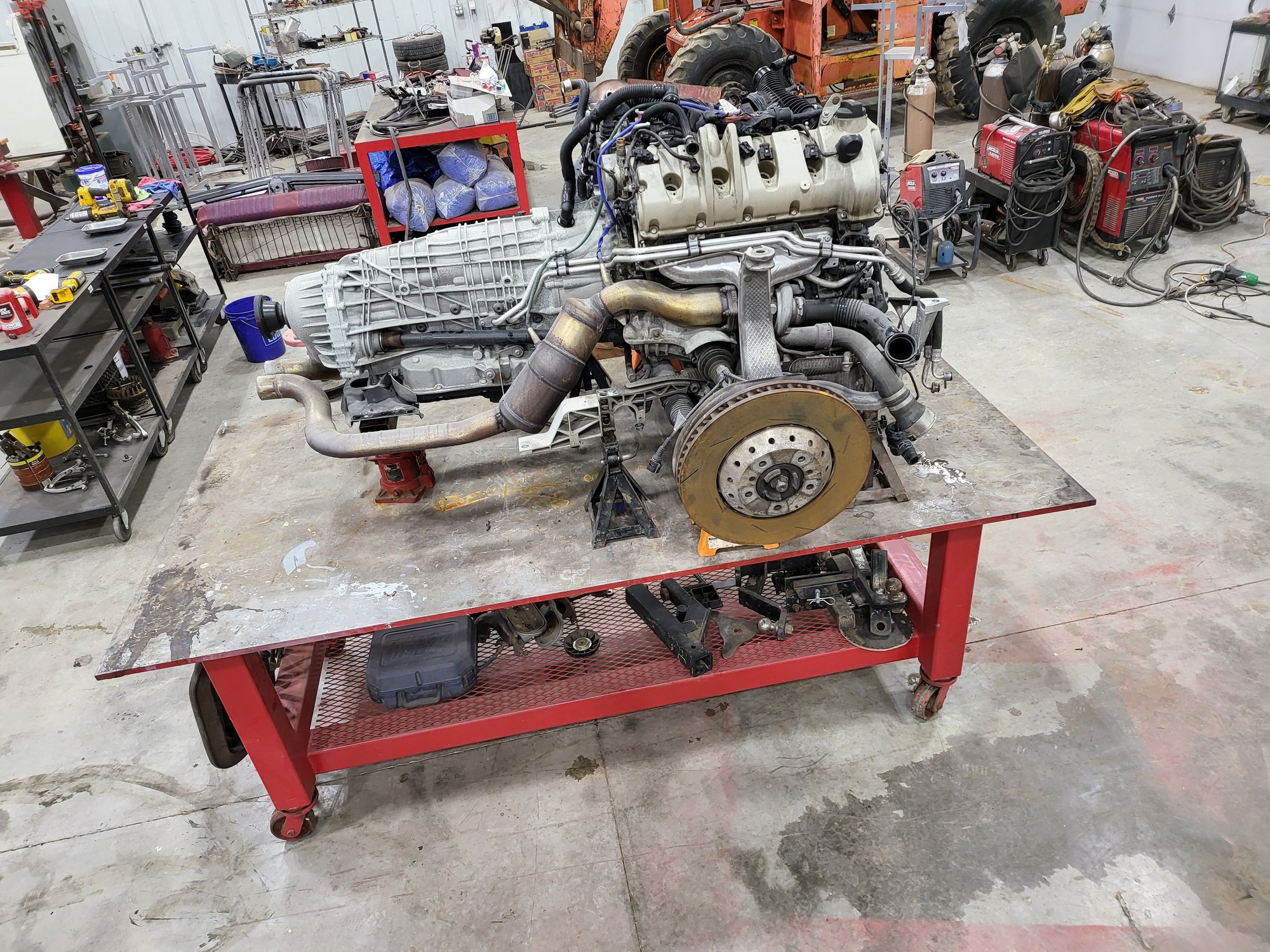

Bought 2013 Panamera Turbo S in non running condition, airbags not blown. Pyro Fuse still normal according to system scan. This isn't my first major Panamera repair, wont be my last. Engine was locked up. Sourced a used takeout VIN C engine with its own harness, have swapped and installed.

I'll attach a few pics for fun.
