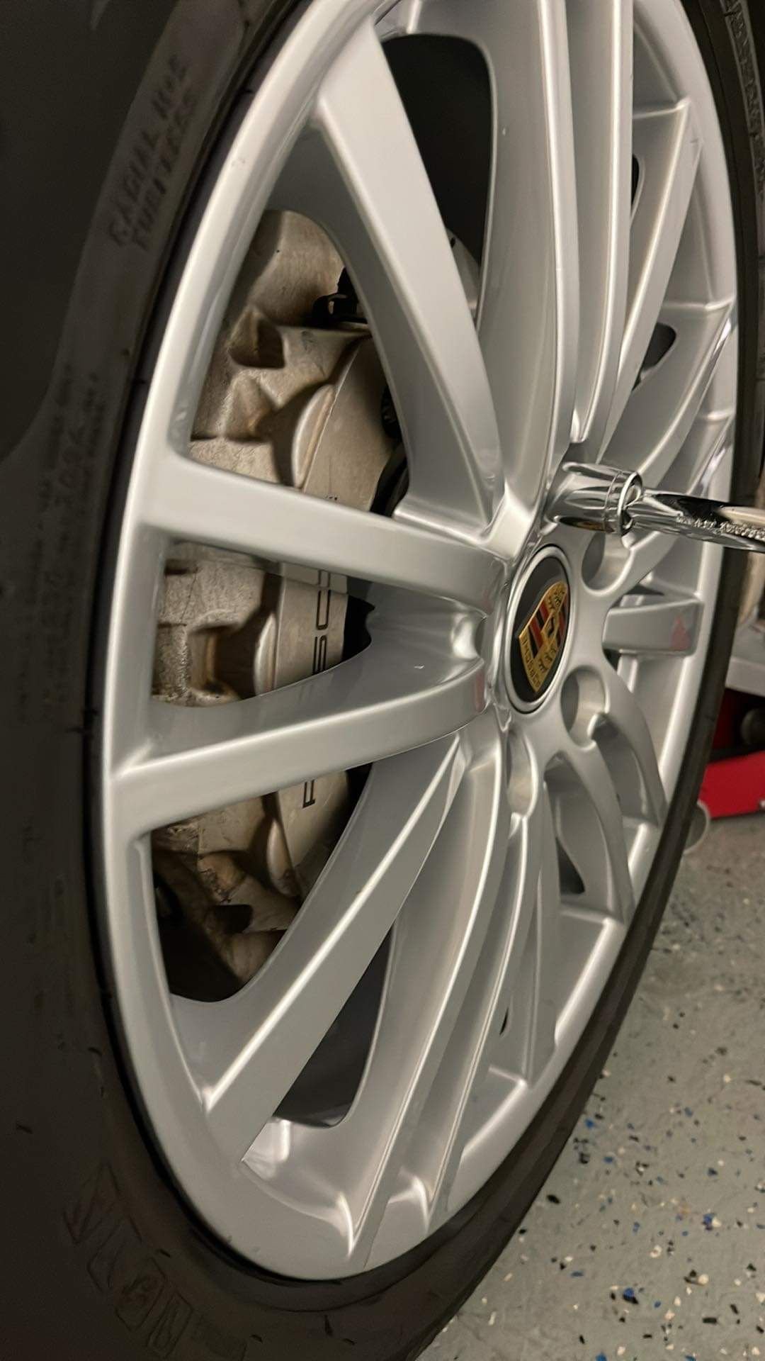

So it fits but the brake calipers are really close in the front wheels… what yall
think!!

From a clearance perspective looks like you clear, I'm not a fan of those wheels but that's just me.

oh yeah it’s clear by like a quarter inch. if a small rock gets in there…
im also not a fan of these wheels, but it was either pay same price for two new tires only (got a flat) or get 4 wheels with brand new tires.

because of the ET offset I think. The wheels are closed to the calibers. what if you use the tires only with your original 20" rim. 970 20" rims are better looking than 971 20". That's my opinion.How's the ride quality?
