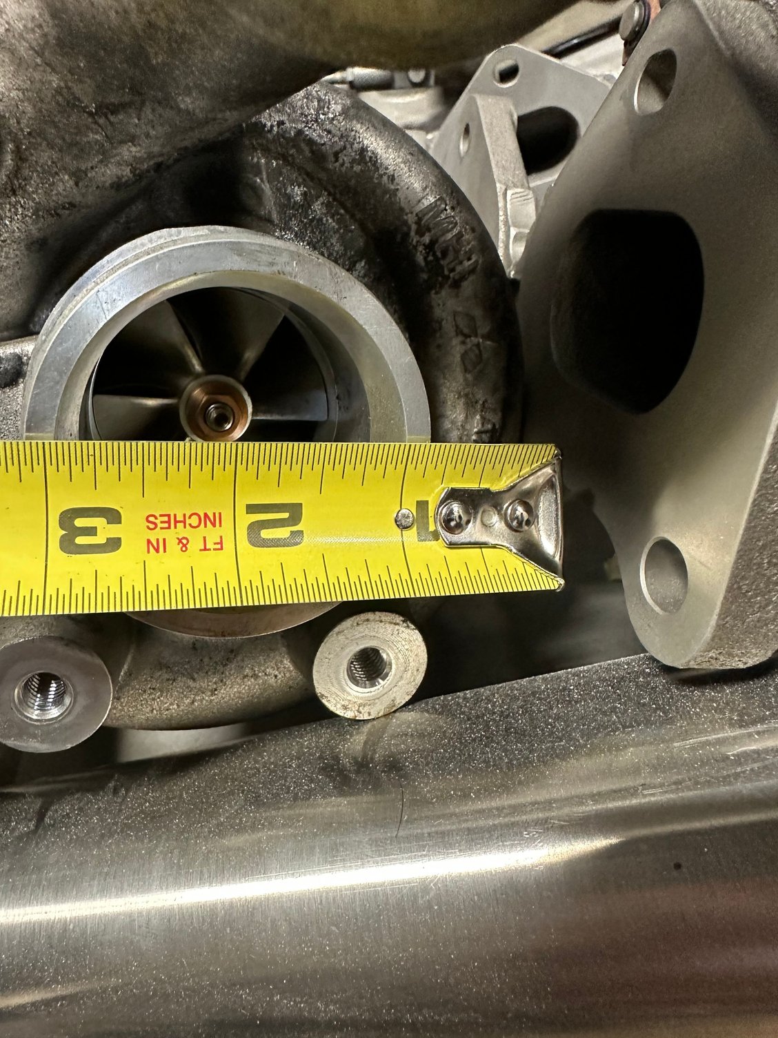

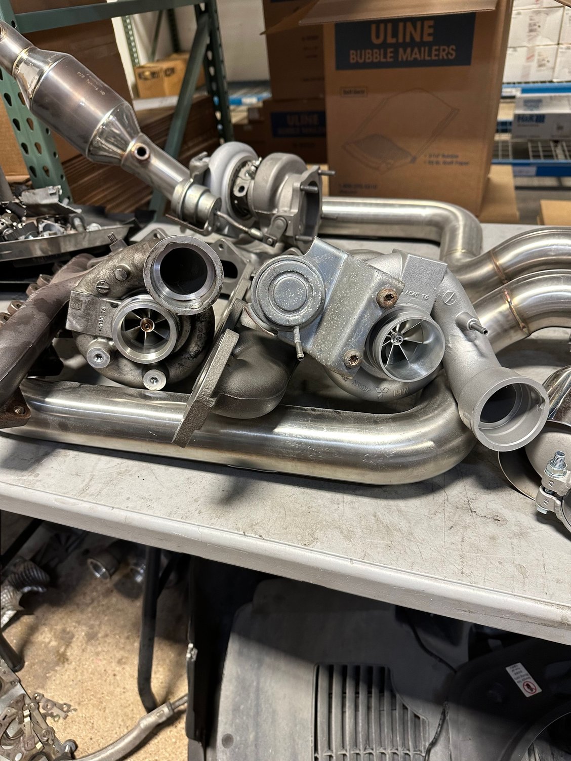

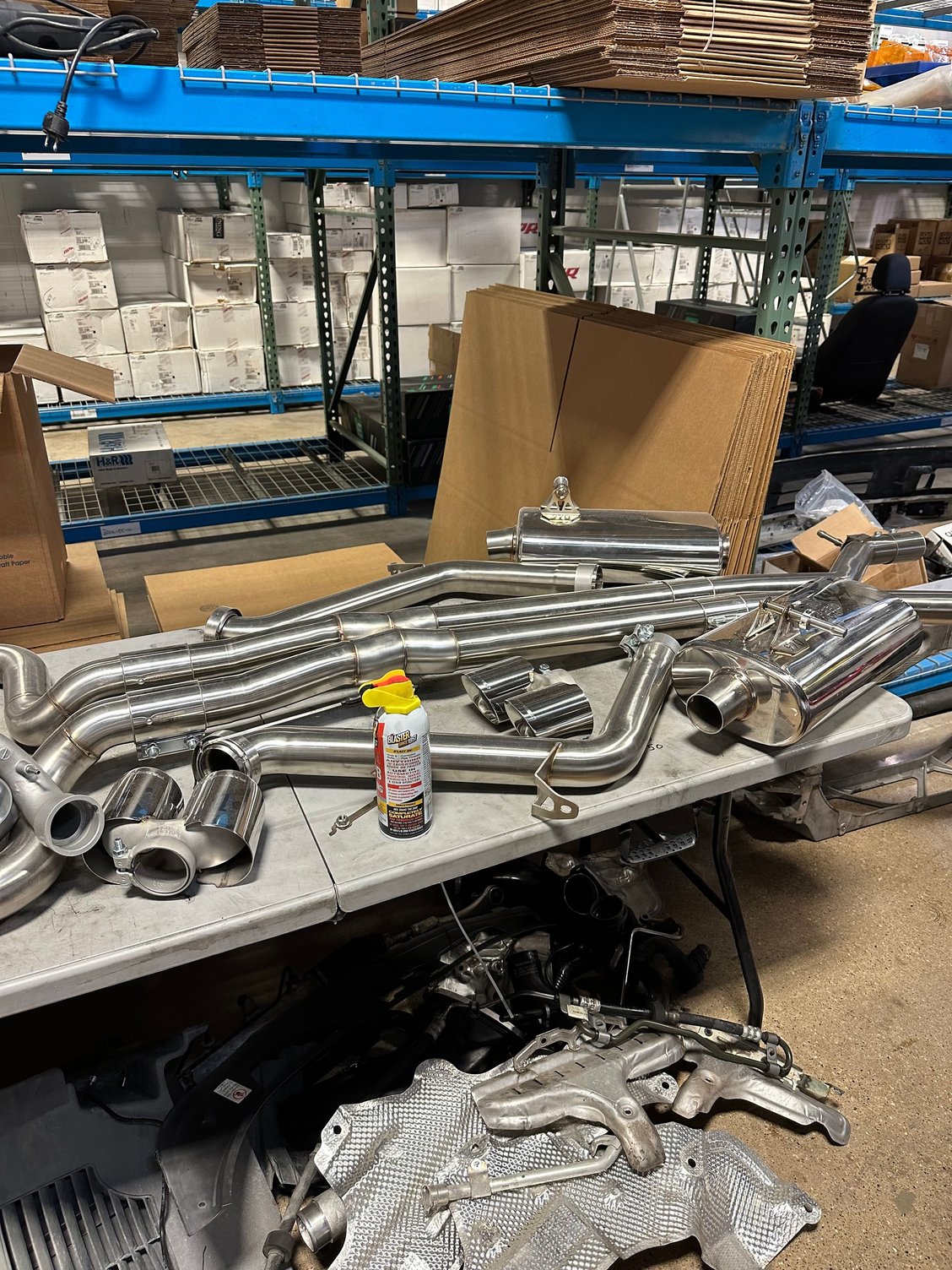

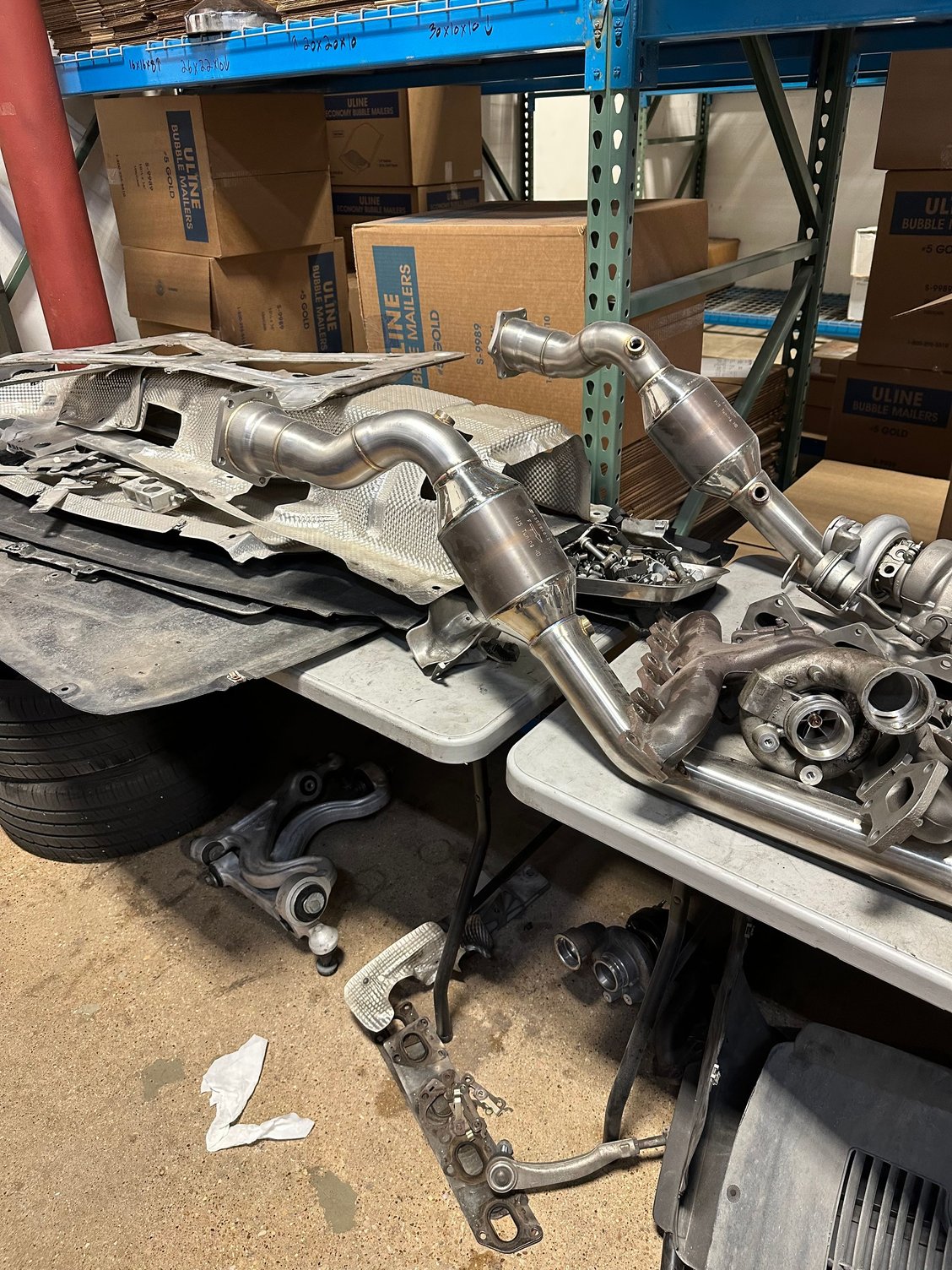

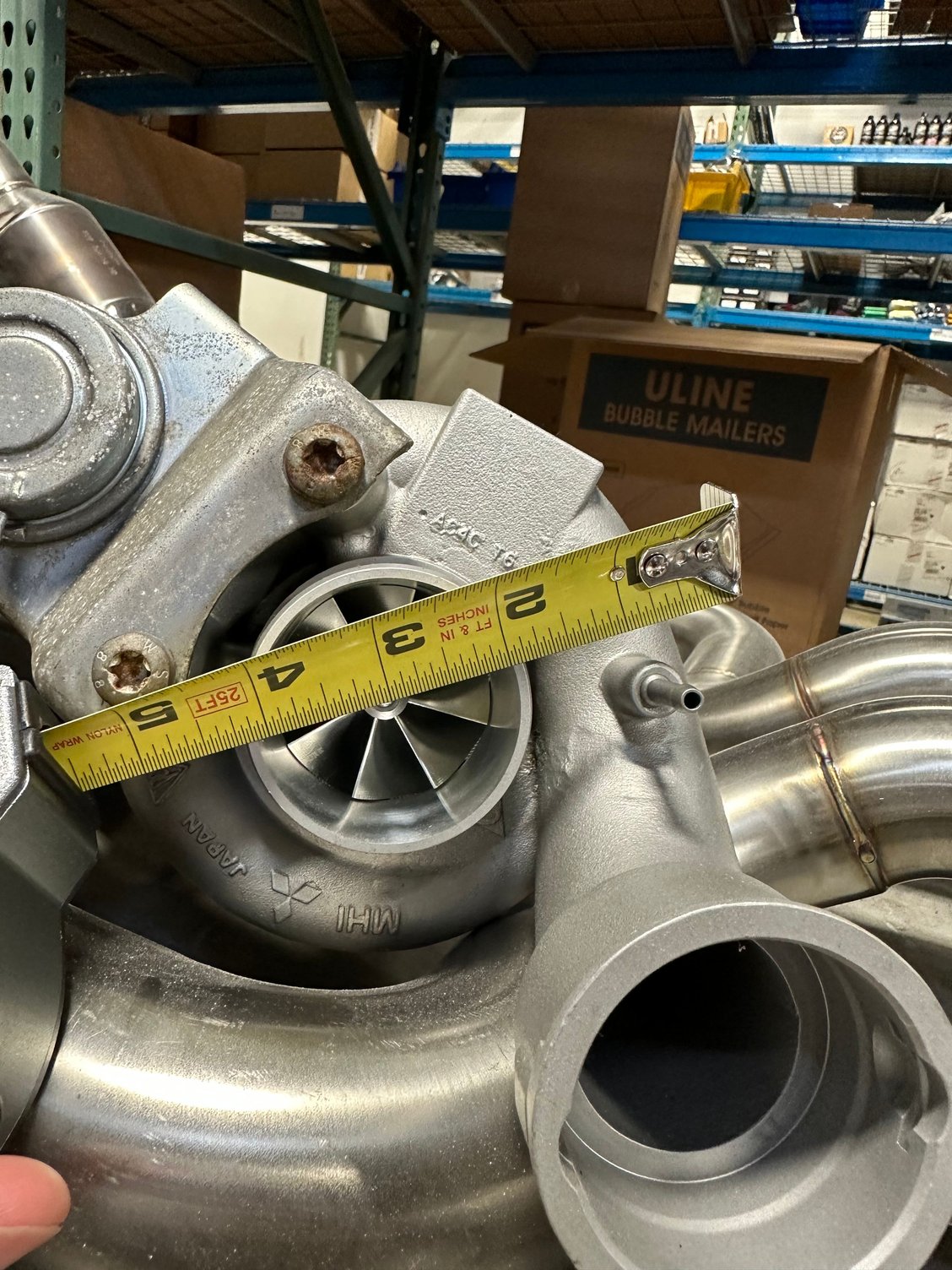

The car is still in surgery. Some parts had to come from Germany. Below are some photos to include the old lungs along with news one next to each others
Old turbo
New turbo
Old and new next to each others
Downpipes
Exhausts and stuff

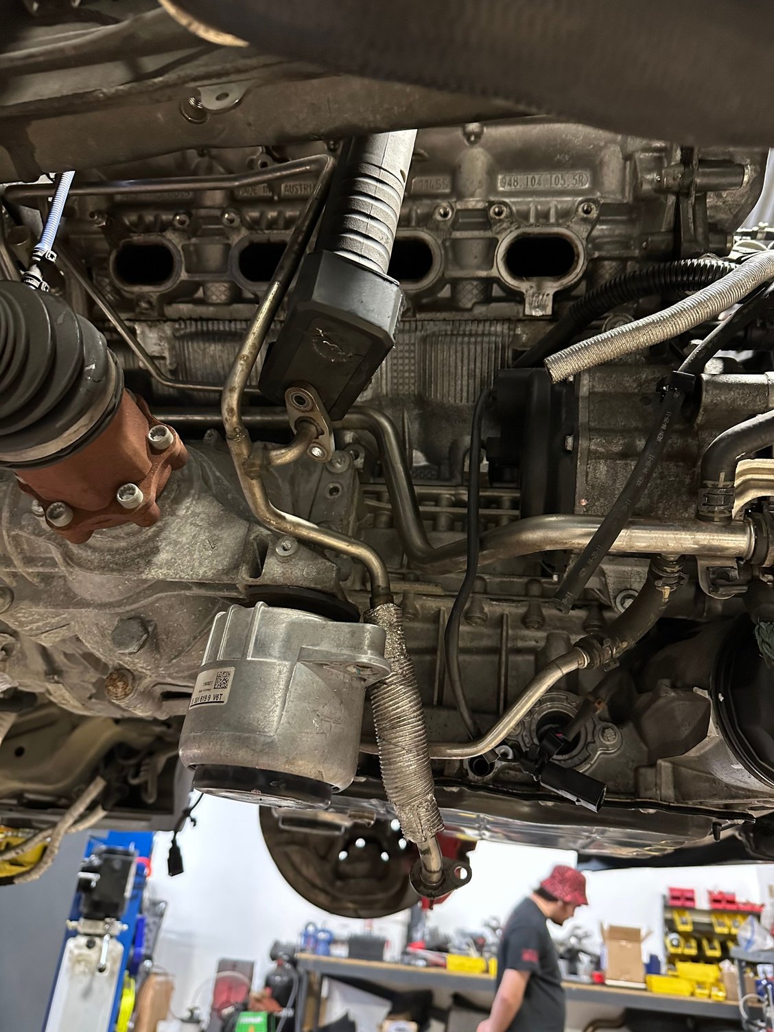

One od the manifold stud broke off so the technician had to go find solutions. You can see it on the last port

Update:
everything installed. The car is currently getting an alignment done due to the subframe had to be unbolted to complete the job.
tomorrow is when the tune will get installed- im asking the shop to put it on the dyno to get the HP readouts after the software installed

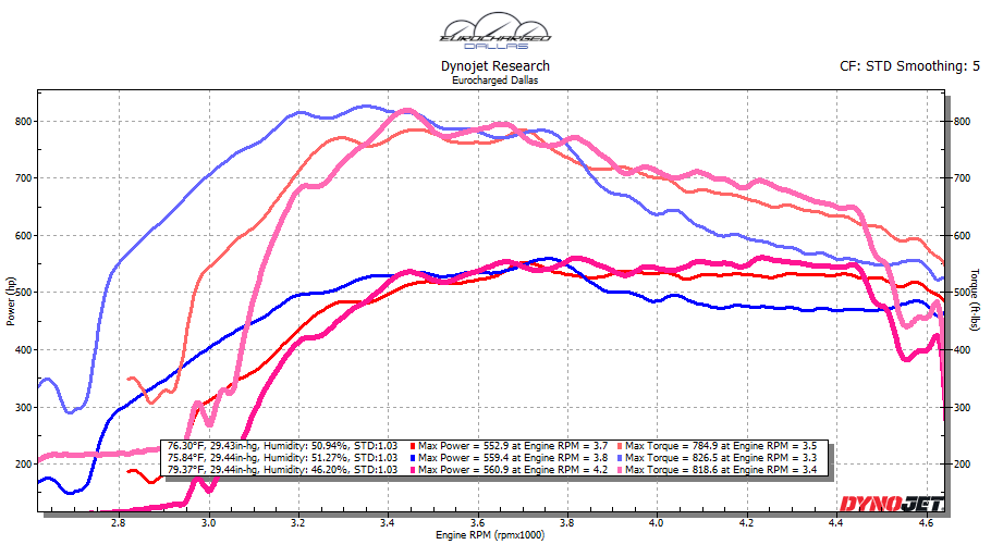

Final Update:
dyno tuning completed and the results are
HP 560 at wheels, with 20% loss, equal 700 HP crank
Torque 826 at wheels, 20% loss, equal 1032 ft/lb crank
this is on 93 octane gas
Put close to 1,500 miles on it so far with zero issues, no lights, no hiccups…none
