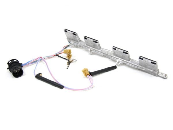

Good Afternoon all I have a 2016 Pan GTS my PDK light come on , what sensors no I need to replace or what should I change or replace ?

Control the DTC codes.

I had a technician run the codes for me and it came up with
P1731 but he said it might be best to change ....
P1732
P1734
P1733 all at once what do you think and what's the proper part number for these codes ?

This problem is this part. Here the DTC : P1731 ... to P1734: Distance sensor information/shift rod faults (outside of validity range) :
For 4s ref. 97031708530
For s réf. 97031708500
First you need to make a PDK calibrationto see.
