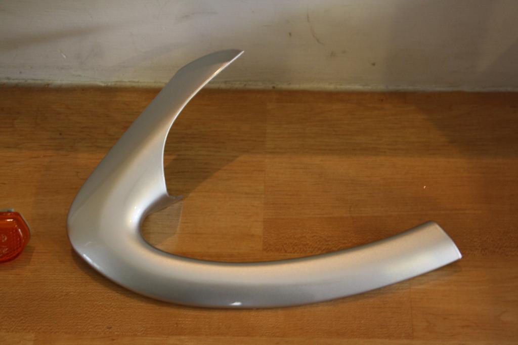

Aluma Look
If you are still looking for aluma-look paint codes they are as follows...
The paint is Spies Hecker. Code L4W9
(Porsche Uses 4 Characters In their Paint Codes)
Ref No.745710
Color: ALU 03 - Effect
Series 293
DuPont Code: X1070
(DuPont Makes Spies Hecker Paint)
