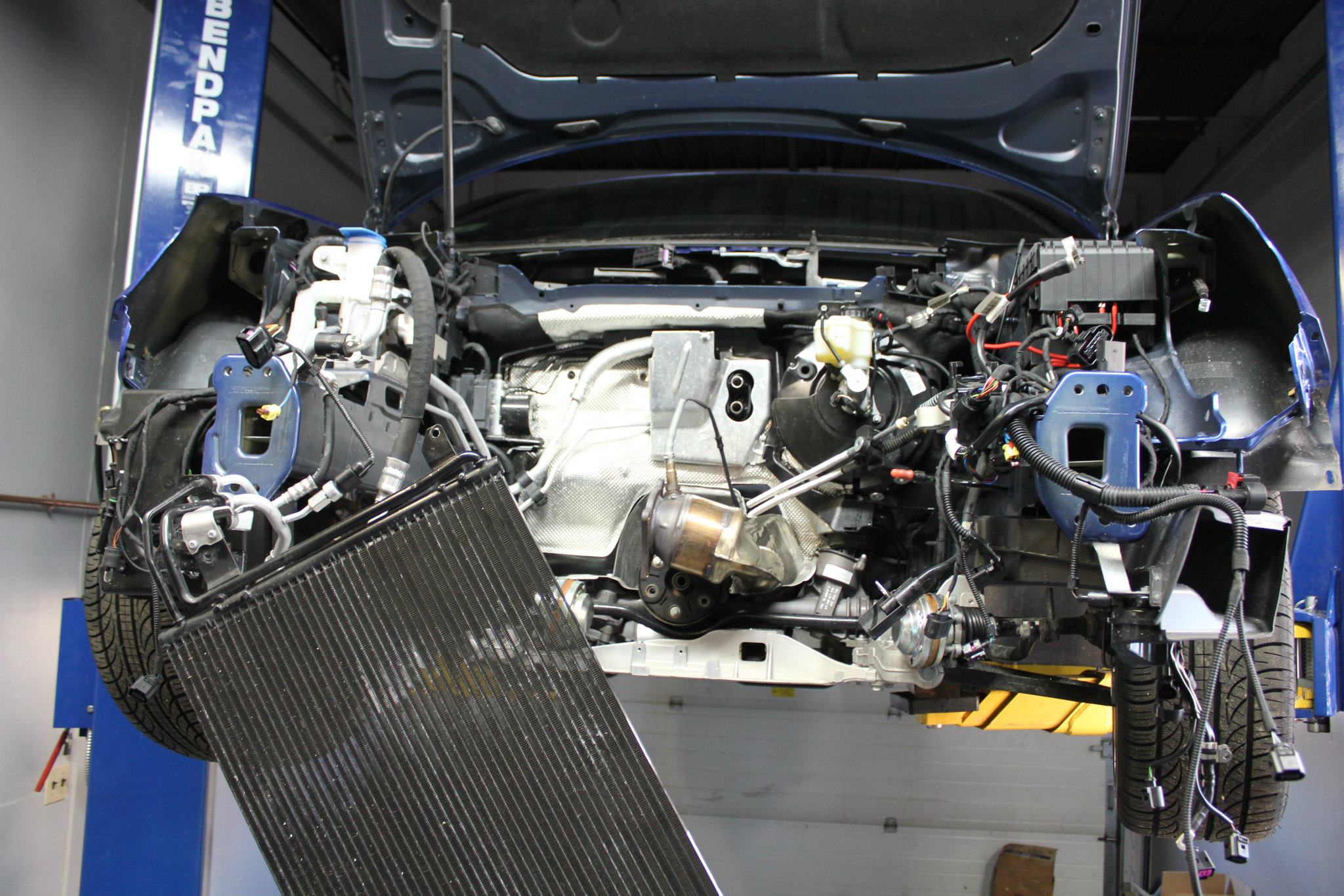

900 mile 2.0T motor, good bye!
Empty engine bay:

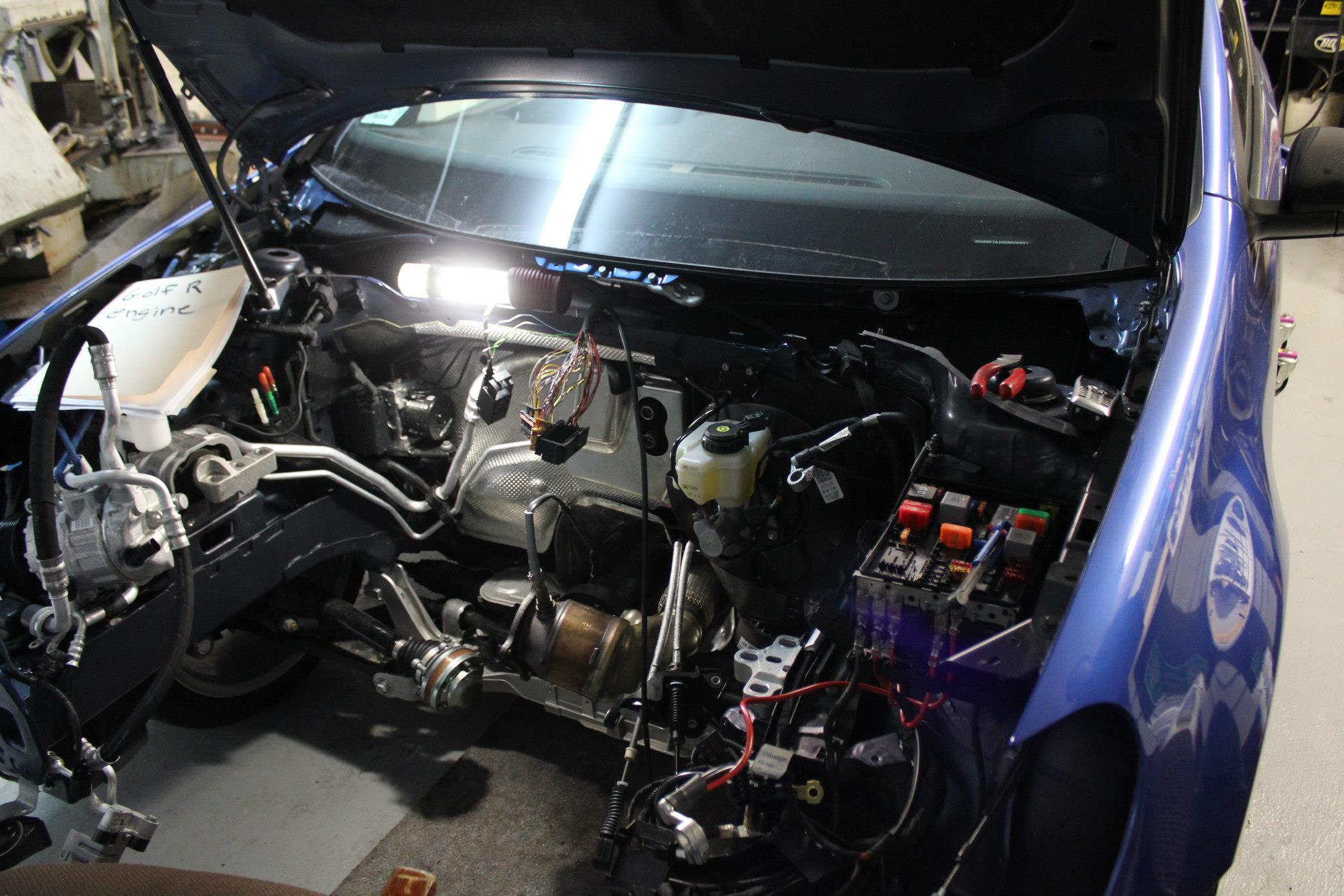

Time for wiring:

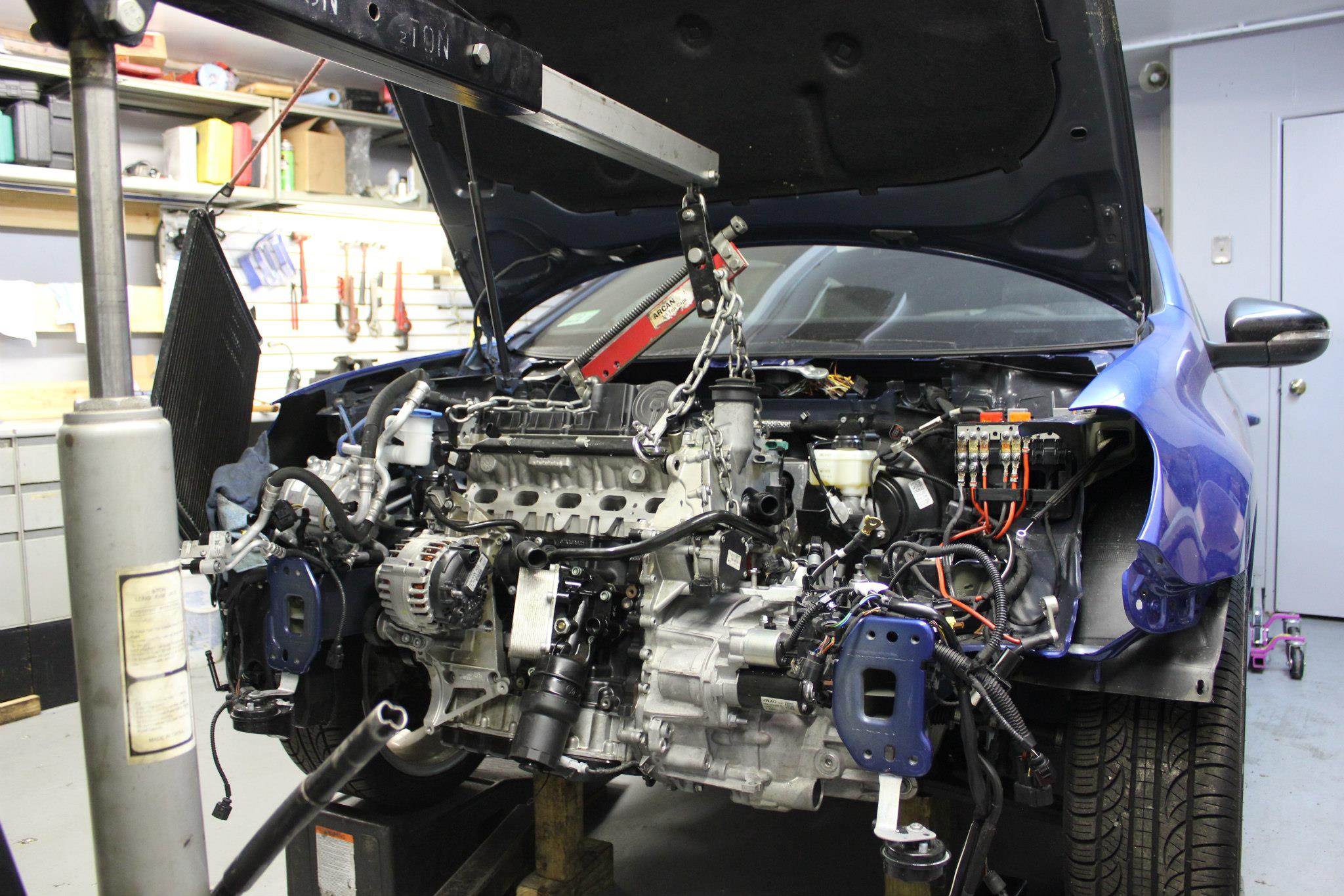

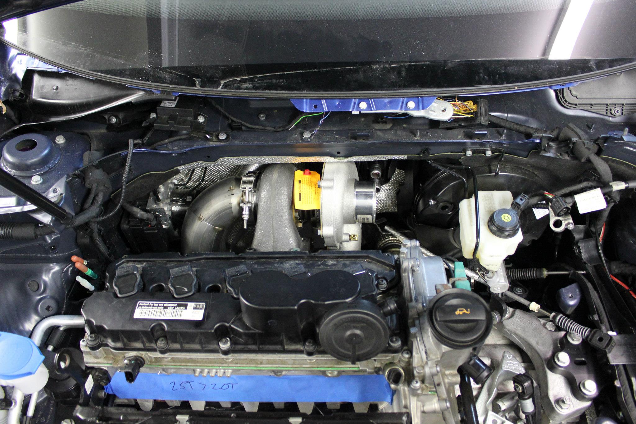

New built 2.5L 5 cylinder motor in for test fitting:

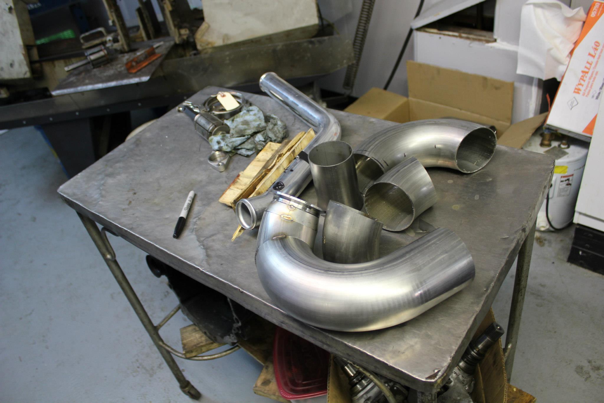

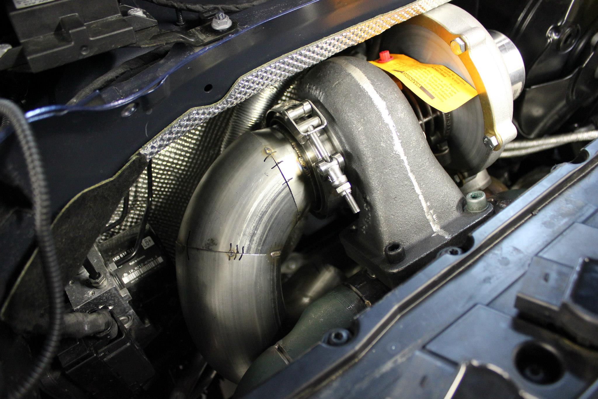

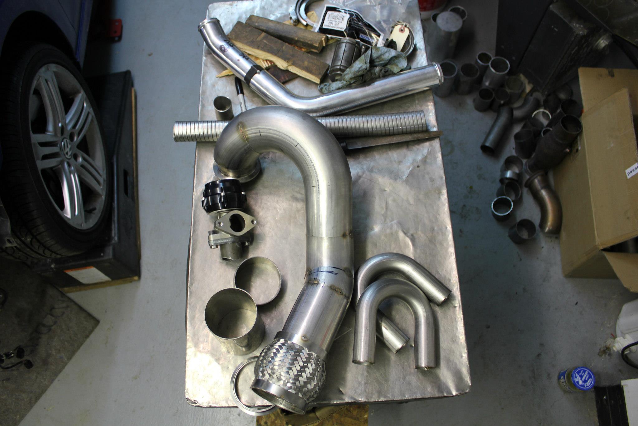

3.5" custom downpipe coming together:
Test fitting with the turbo and everything in place:

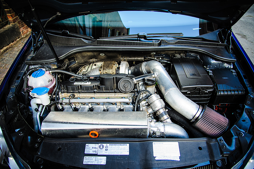

Everything all together and heat wrapped. Dirty from testing:

Custom in-house 3.5" intake piping
Custom in-house 3.5" charge Piping
Garret 700HP Core
Exhaust:
Custom in-house exhaust manifold
Custom in-house 3.5" down pipe & mid-pipe

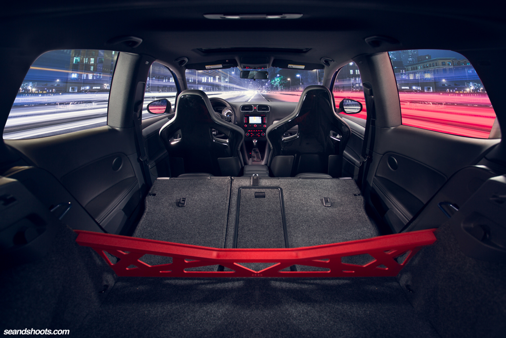

Car is a blast to drive. We guestimate based on what it will keep up with and what we know about the hardware that the car is making around 450awhp and about 400awtq. There is more tuning work to be done though.
I plan on adding water meth and an SPDi racing ignition system which should put me well over the 500awhp mark.
