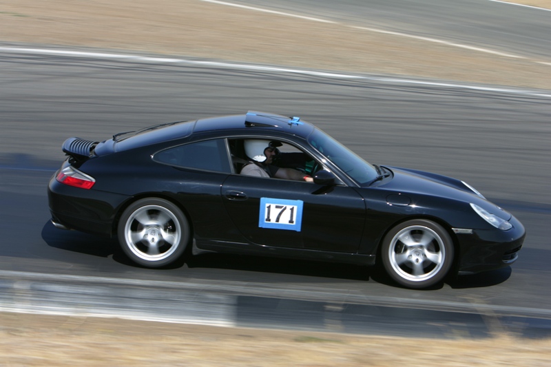

Better side shot of wheel/tire spacing:

Nice pics....
You're car looks pretty low any idea on the measured height at the corners? My car is lowered to the point where the front control arms are parallel with the ground and there is a less than 1% front to rear rake.
As for my setup there is slight rubbing on the inside liners at full lock and during hard cornering as well.
I'm looking at Kumhos, NITTOs NT01, and TOYOs 888s. I will probably have two sets of rims so I'd run PS2s for street and the R Comps for track. I am leaning toward 888s for now but need to find a good place to get them from.
