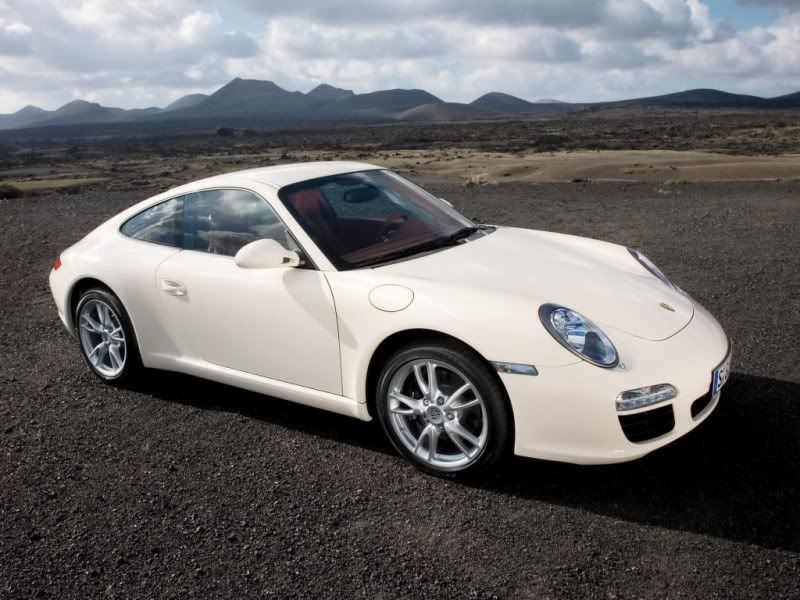

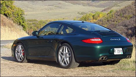

I have a 09 C2S, with standard carrera type 2 rim. i am looking for a winter/maybe track set up, so i thought of OEM 18" carrera rim due to my limited budget. Would they fit on my C2S?
my offset is 57/67
18" carrera 's offer is 57/60.
here is the rim i have
here is the rim i am interested in,
any thoughts?

Hi there, actually using a 7mm spacer in your case will not help it will make it more agressive. You should have no problems direct bolt-on. Factory 18" & 19" are found on your vehicle so you should be fine there too. If you are at all intereested in a Winter package Id be happy to assist, we offer complete packages and TPMS equipment in stock for all of you driving needs.
A package as seen below using Pirelli snow and TPMS equipment installed and shipped to your door can be had for around $3249
