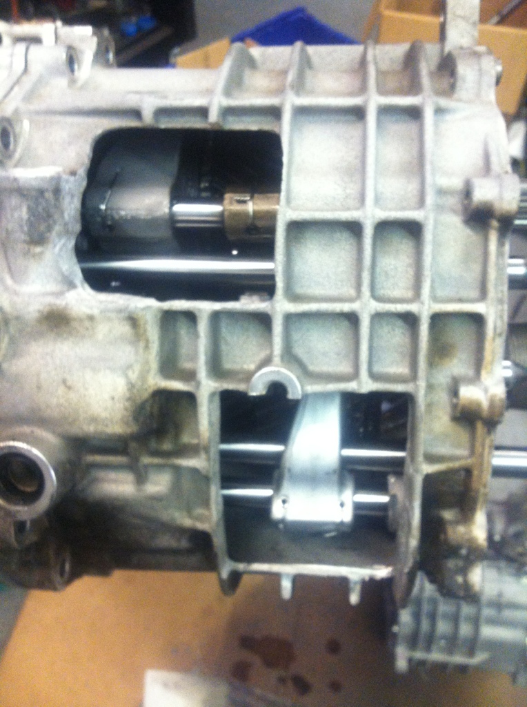

Steve,
Look at the face on second gear and see if there is wear mark from the slider touching. if there is no mark you are getting full engagement. you need a center case with cut outs to see where anything lining up.
The shift forks are not adjustable so you need to shim the stack to get the throw right. You may be able to see the 1st/second gear slider through the oil fill hole in your center case. also make sure you line the the missing tooth up on the 1st/2nd slider with the oil hole on the pinion shaft. I would get the cms shift arrester
http://californiamotorsports.net/col...shift-arrester
