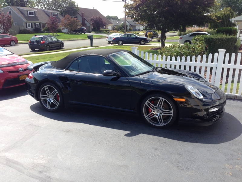

Pics
I had to re-size them for the upload.

looks great. Not a 'need' but consider treating the top-a two part deal-wash and then spray. I mask things off like its getting painted. The water will bead like crazy for several months. My 08's top looks like new. js

Thats a beauty! Enjoy in the best of health!

Good to have another Turbo on the Island. She looks good, I would strongly suggest as others have to clean and protect the top. I used the Mr. Ragtop and it keeps the water out and keep the top looking great.
Your car look great, enjoy it in the best of health.
