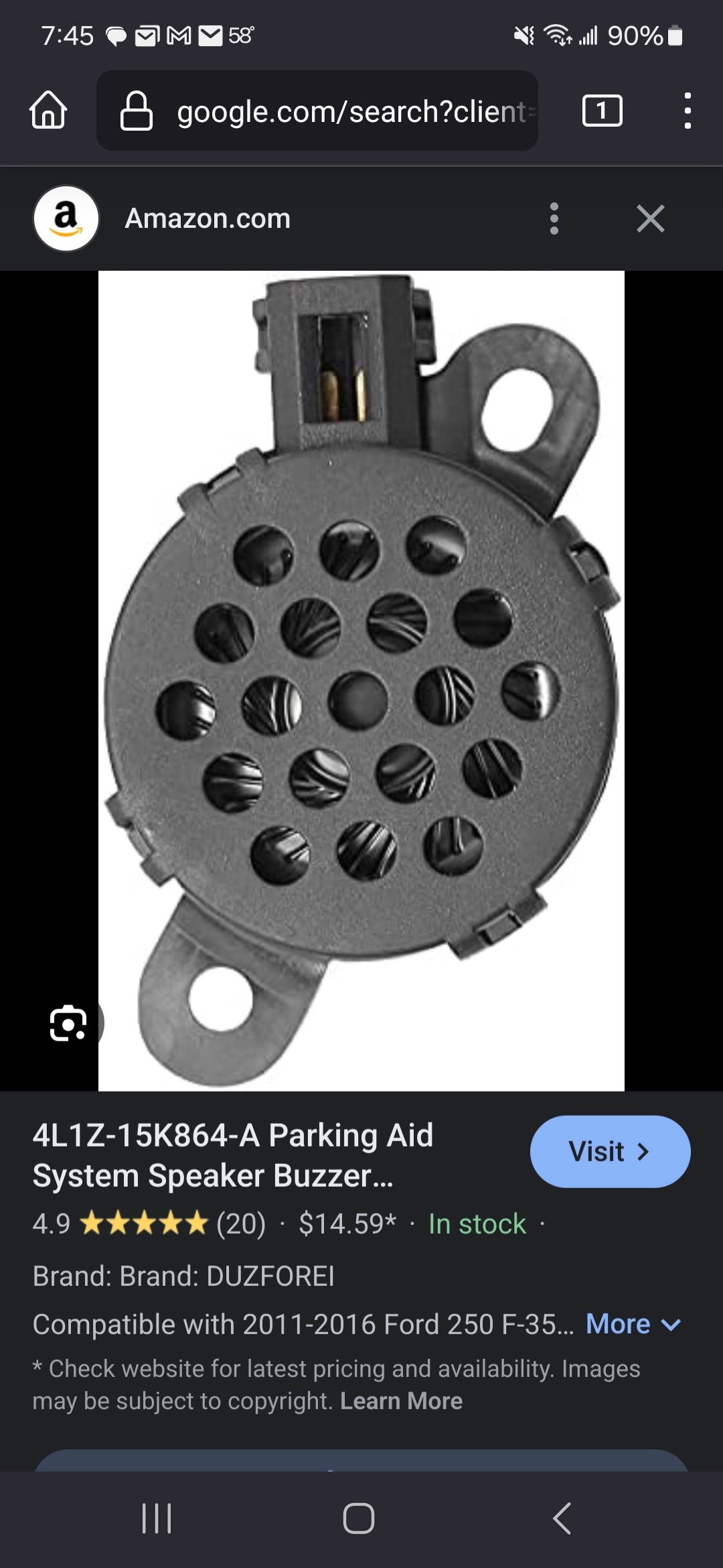

So you need to locate the front speaker and most likely replace it. Under the drivers side dash about 30mm round with a bunch of holes on the surface.

Ford part that you should be able to source just about anywhere.
