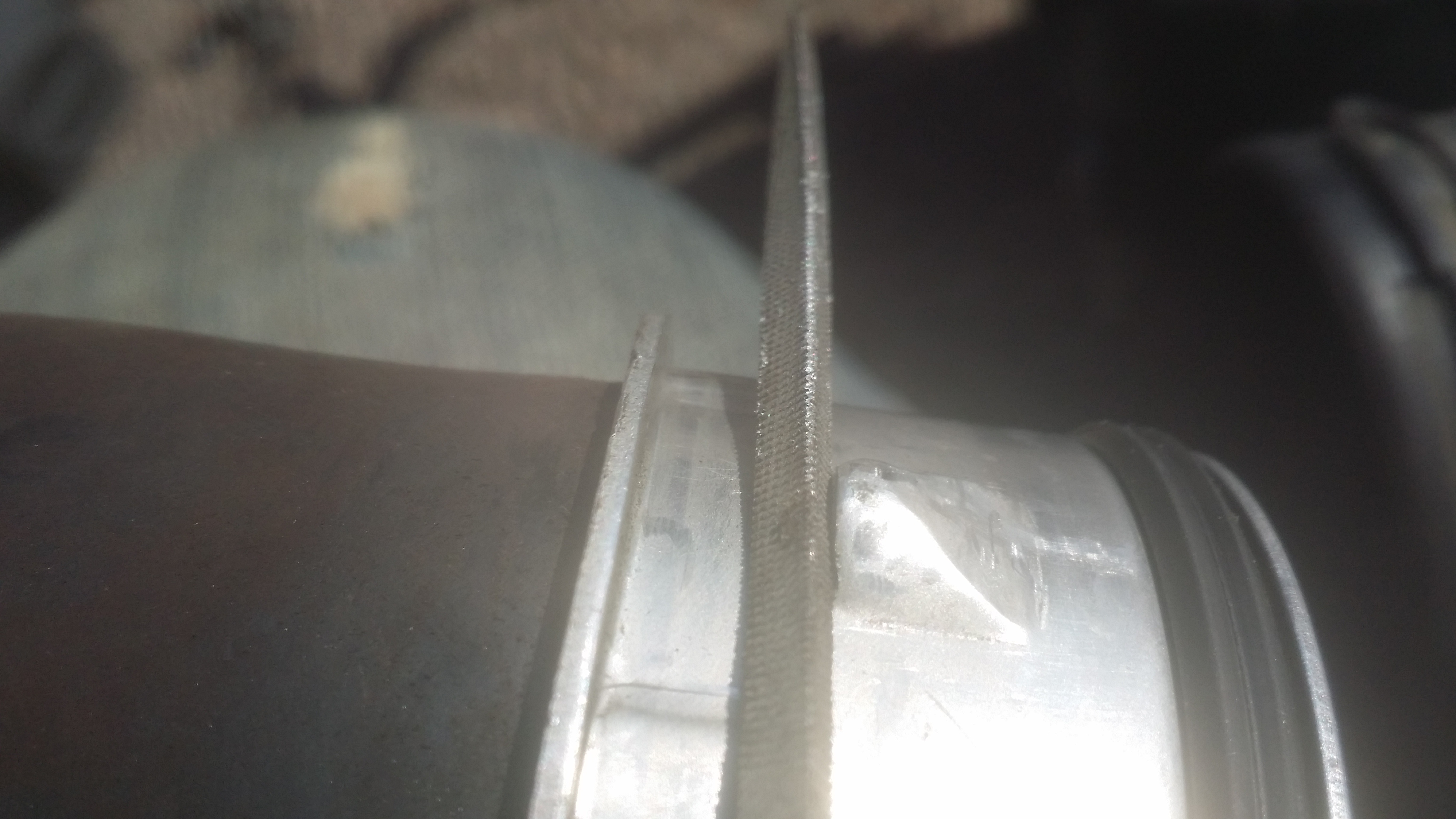

So I fixed it today. I did a little filing on the tabs to provide a sharper angle to help keep the clip from sliding over them. I put a tiny bit of lube on the o-ring so it wouldn't roll, then clipped it in and wrapped wire around the clip, making sure it was twisted down tight. I couldn't resist putting a dab of RTV silicone on each side of the clip where tabs are located to help prevent the clip from moving. The car is a silent rocketship once again. Thanks everyone for your help.
