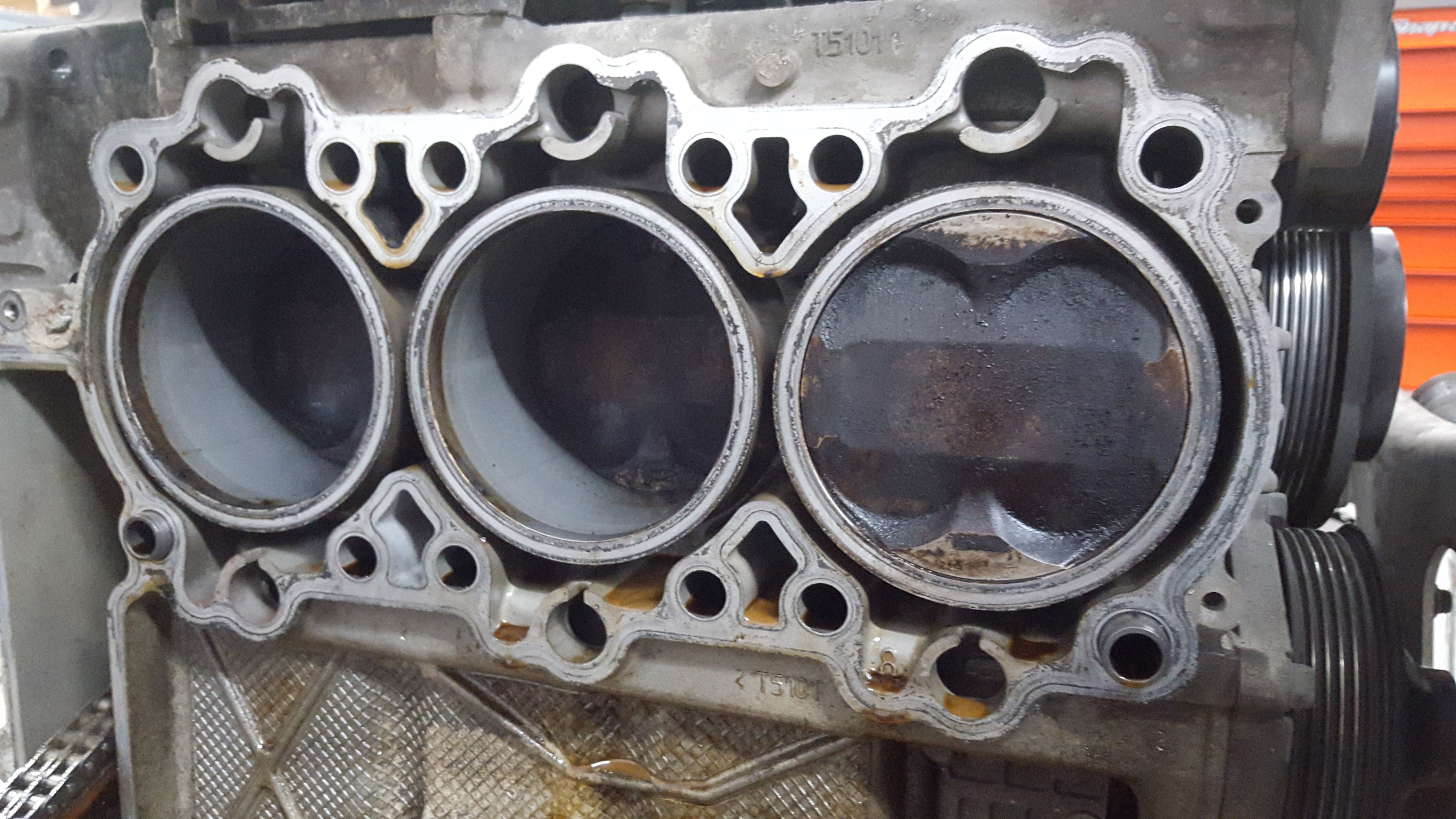

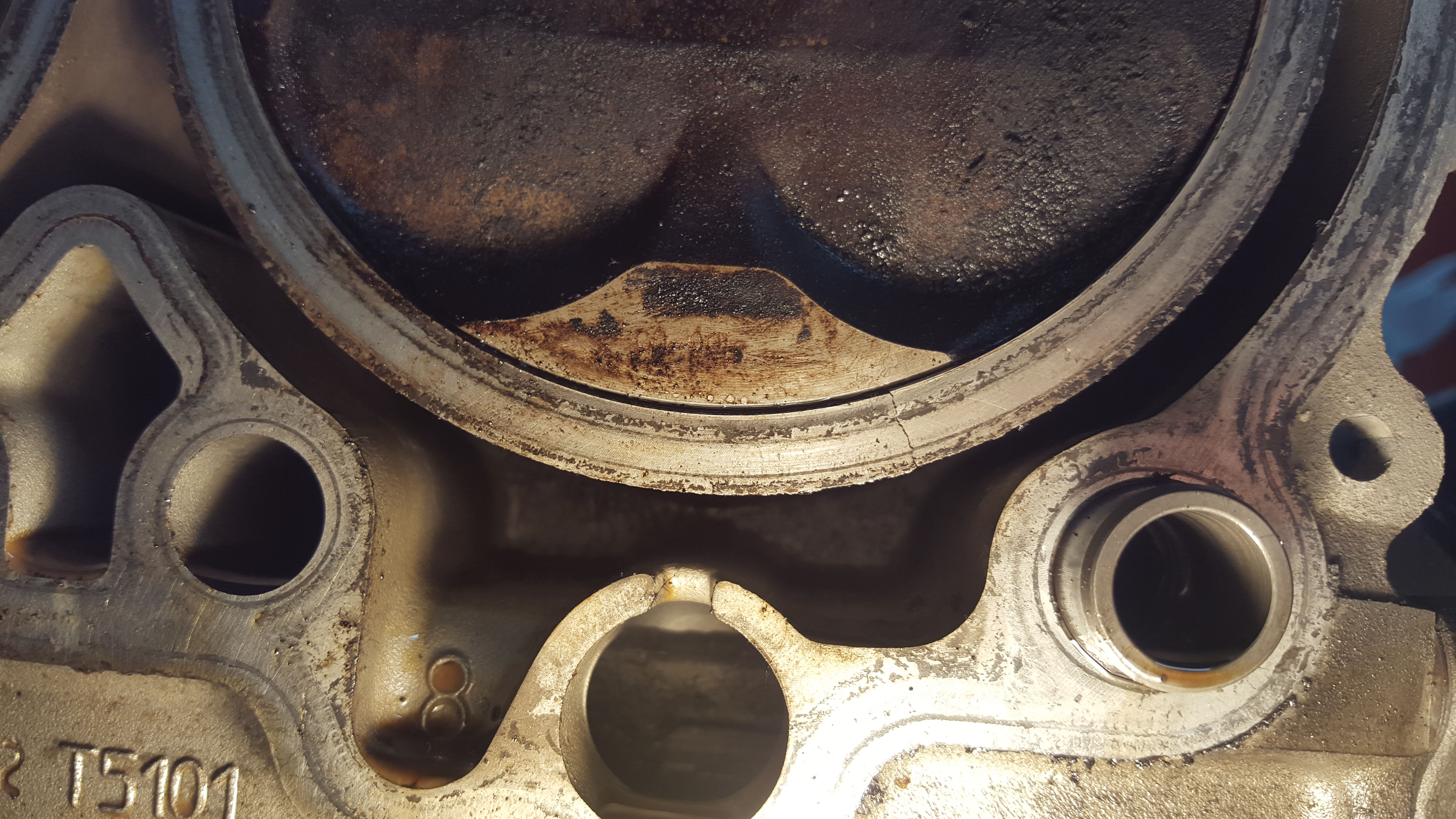

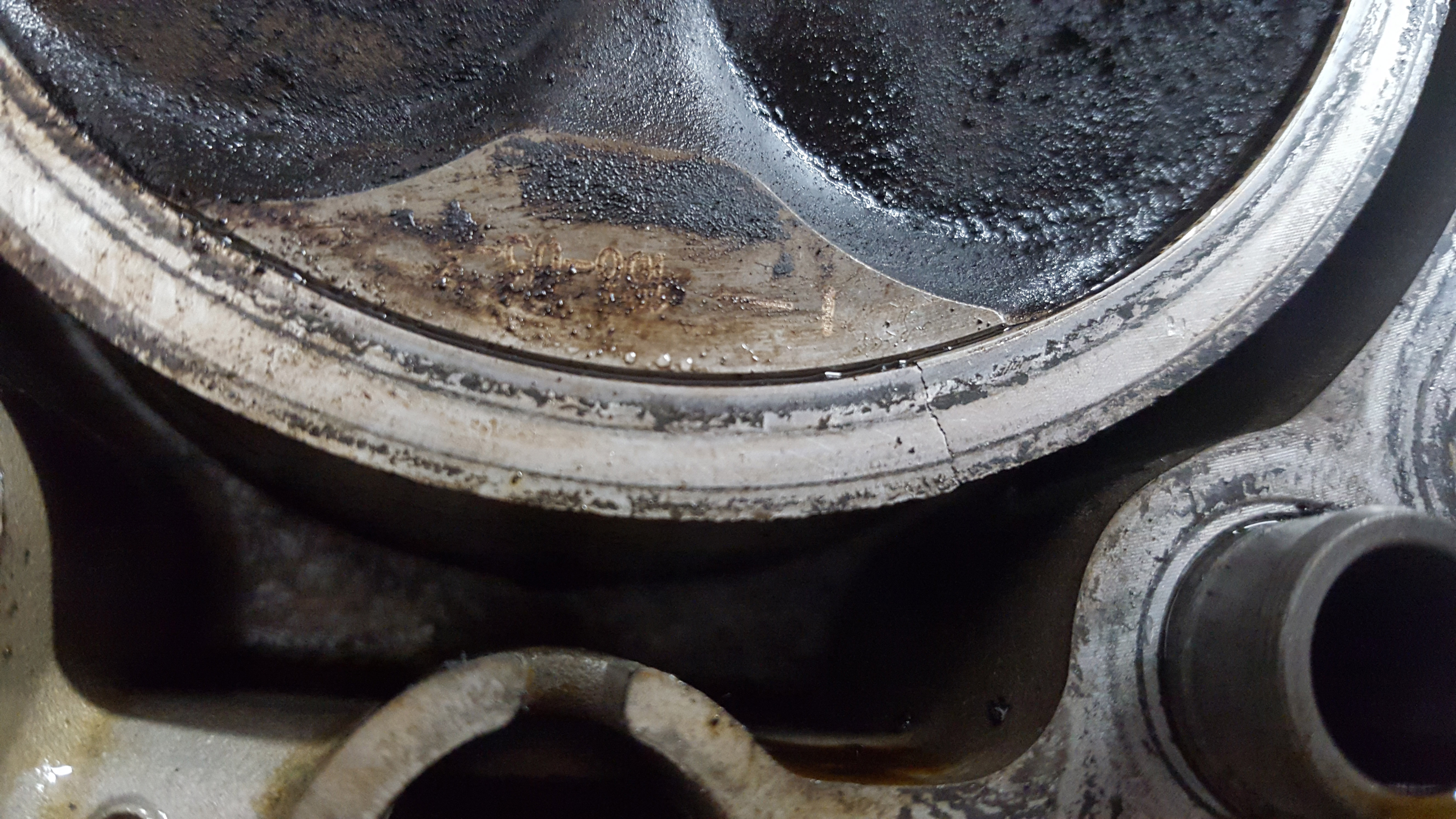

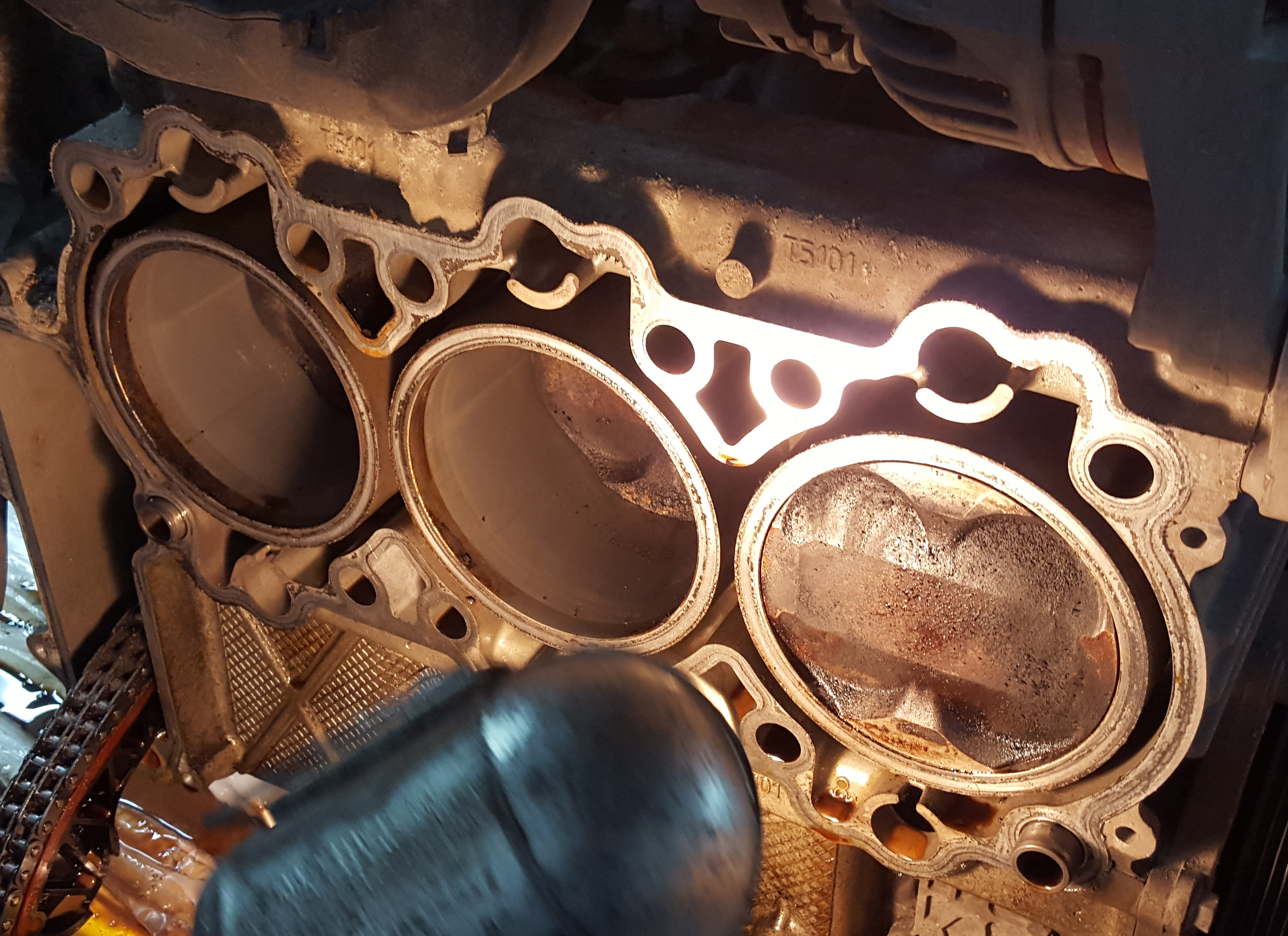

Old Apr 3, 2016 | 11:39 AM
artyve's Avatar
Joined: Jun 2012
Posts: 58
Rep Power: 16
artyve is infamous around these parts
Update: there is a crack on the cylinder #1 wall. Pics attached. Mechanic says that this means the entire block is toast and needs to be replaced. He gave me a few options at this point if I want to keep the car:
1) Buy a brand new short block from Porsche to replace the cracked block. $19K CAD for the block and about $4K in labour (labour includes all the work so far and all the work to put everything back together again). The labour costs is a fairly rough estimate.
2) Get an aftermarket block from LN Engineering. Not sure what the cost of this is and I can't seem to make heads or tails on the LN Engineering website. "3.8 to 4.0 911 Nickies inc. 101mm FSR JE Piston set, inc. rings, pins, & clips" for $4770 USD. Is that pretty much all I need? Mechanic is looking into it, but hasn't gotten back to me yet. It would be tempting to go up to a 4.0 though...
First thing I asked my mechanic to do is to get both heads bench flow tested to ensure they are in proper working order because if either head is damaged, then I'd have to reconsider attempting to rebuild this motor. Any advice, at this point, is greatly appreciated.

Old Apr 3, 2016 | 02:39 PM
myw's Avatar
myw
Joined: Jun 2013
Posts: 746
From: toronto
Rep Power: 50
myw is a splendid one to beholdmyw is a splendid one to beholdmyw is a splendid one to beholdmyw is a splendid one to beholdmyw is a splendid one to beholdmyw is a splendid one to beholdmyw is a splendid one to behold
i think that is the cost to have the block resleeved to nikisil cylinders (so that the problem does not happen again) as well as the stronger pistons + additional stronger engine internals .... but not the cost of the block itself.
