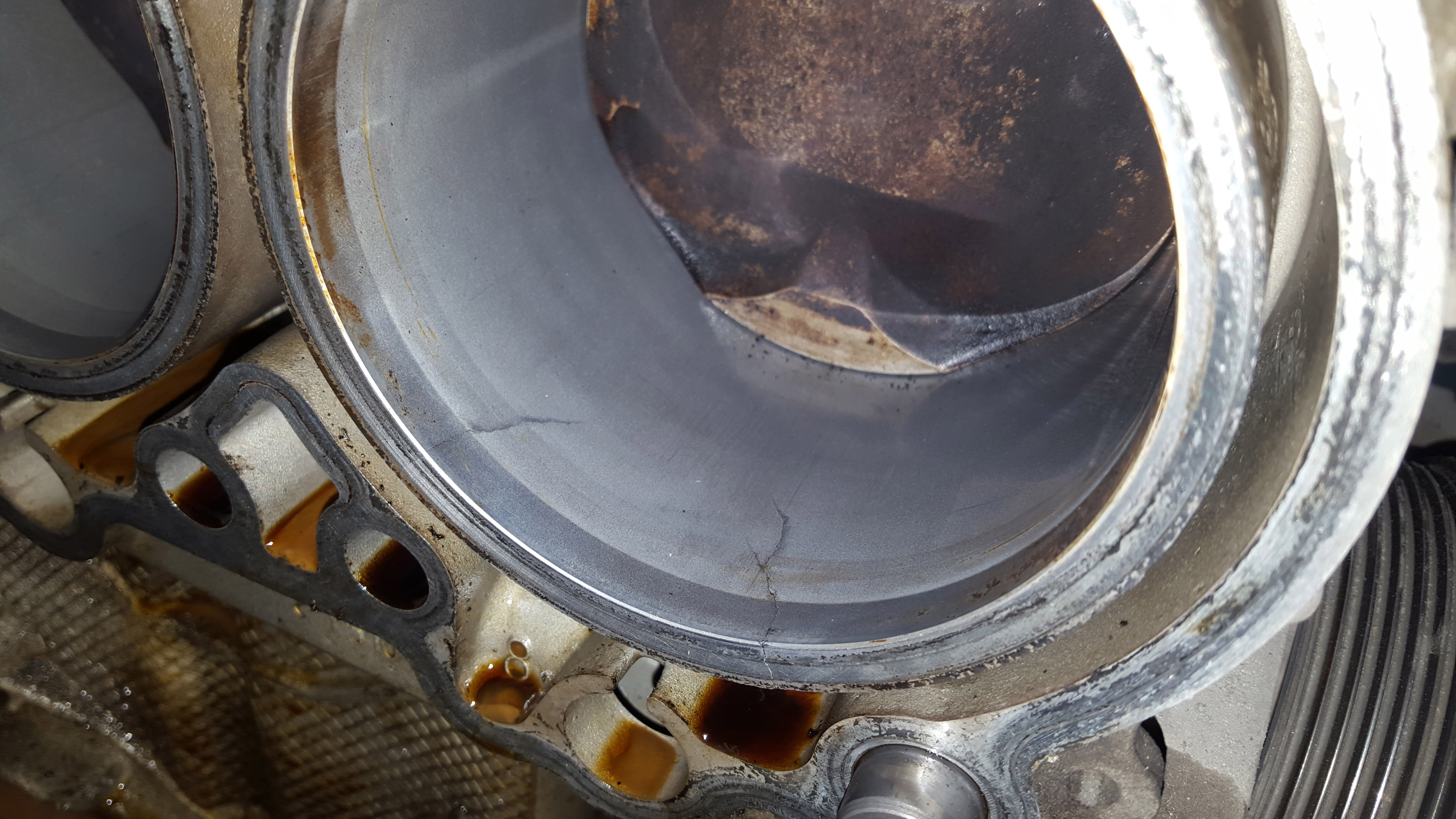

As an update, we rolled back piston 1 to reveal what looks like the start of a D chunk. Based on photos we sent to LN Engineering, it looks like we should be able to salvage the block and install the Nickies 4.0. Heads are also back from the machine shop. They are good except for minor warping and were machined and cleaned up. Next step: open the crankcase...

There was an article a while back in Excellence about the use of "waterless coolant" th keep temps down on these motors. I'll have to look for it. Fugly pic. Sorry to see it come to this.
