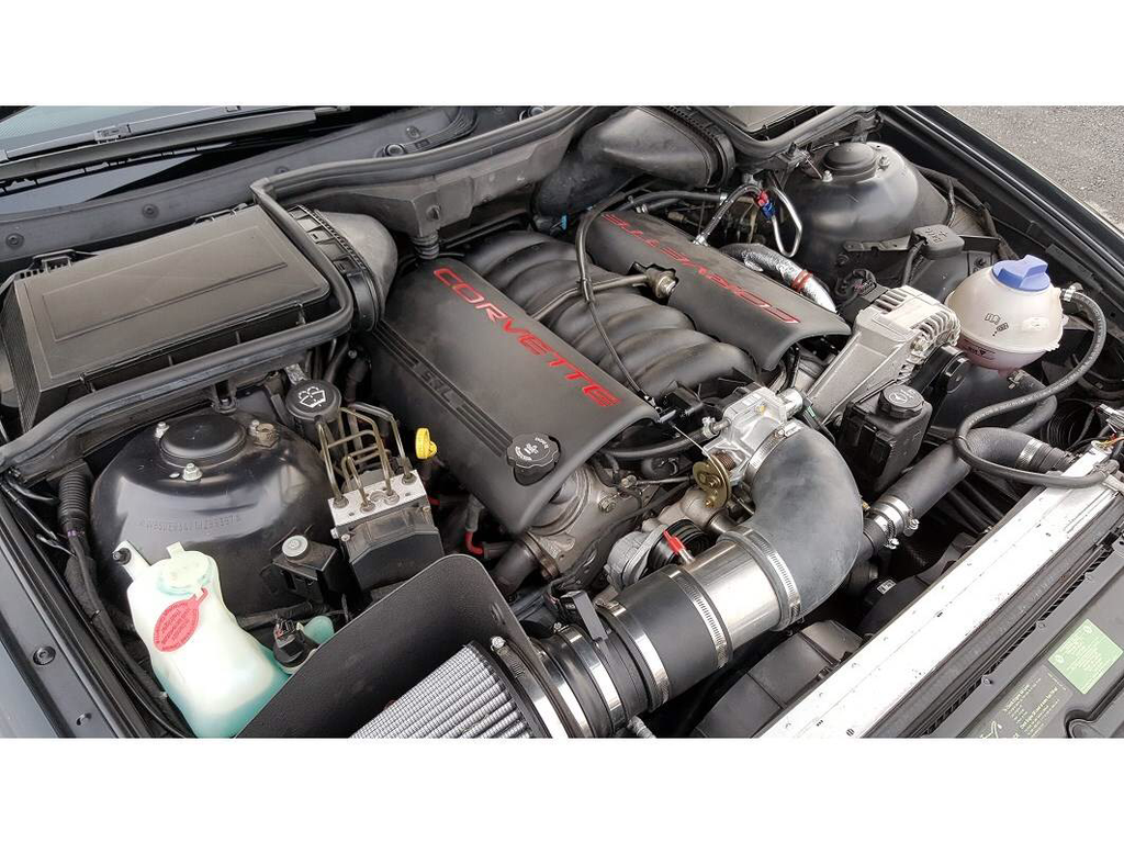

Engine is an iron block 5.3L from a 2005 Chevy Suburban, with ~66k miles (see mods below)
Transmission is a T56 6 speed manual from a 2007 Cadillac CTS-V with ~67k miles
Heads ported and built by Total Engine Airflow and is running a Trickflow camshaft (220/224, 112LSA)
Head bolts and rod bolts are ARP.
Intake is an LS6 intake and throttle body
Headers were custom built by original owner and are a tri-y setup, much like the stock M5 headers. The headers connect to the stock M5 exhaust using the stock M5 flanges, therefore you should be able to use any aftermarket E39 M5 exhaust setup and bolt it right up to the headers. The M5 cats are in place and functional. Exhaust is quiet but there is a noticeable lope from the cam.
Belt driven accessories are the corvette layout and were brand new GM parts along with the starter and water pump.

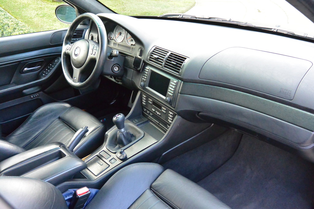

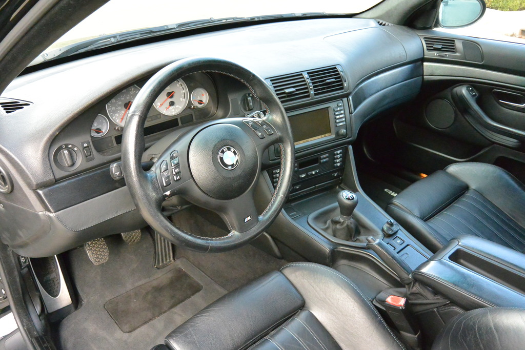

Clutch is a Diamond stage two running the CTS-V slave cylinder (using the Katech slave spacer) along with a Tilton Clutch Master Cylinder. E60 545 Short Shifter. Transmission shifts smooth in all gears, no grinding. The radiator is a stock M5 unit running (F-body) two speed cooling fans.

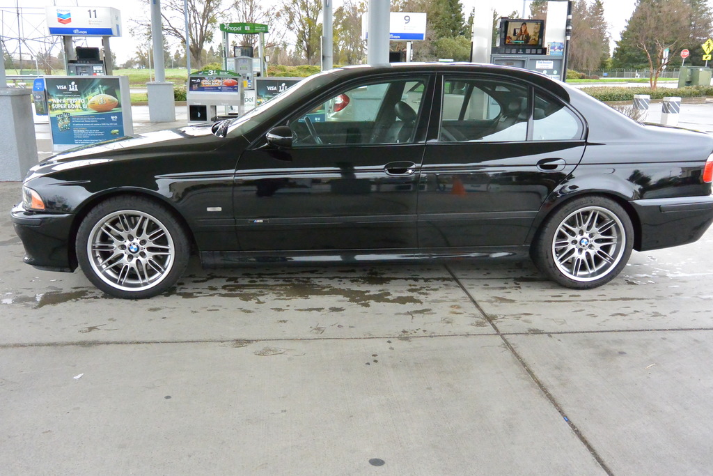

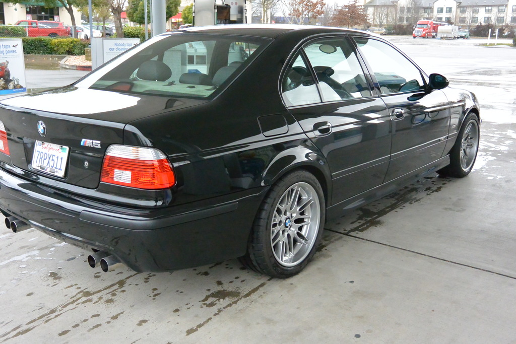

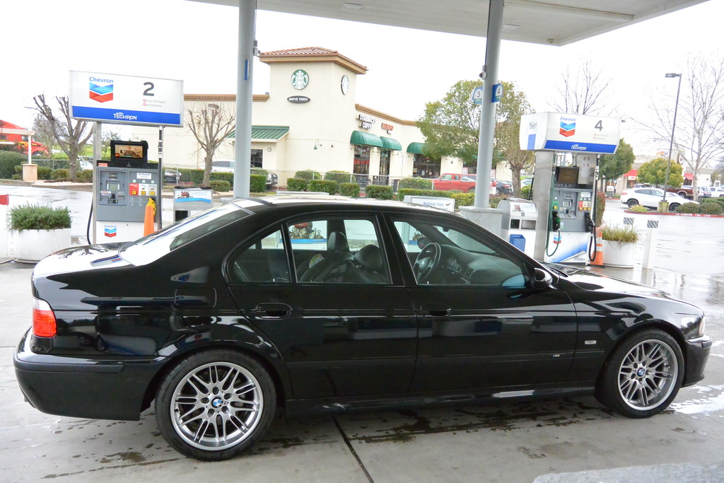

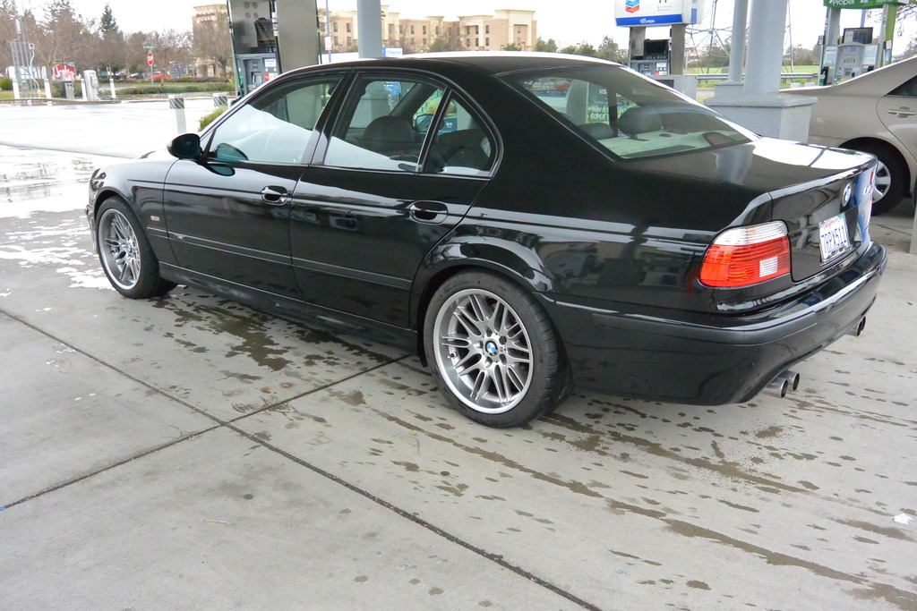

Tires and Wheels OEM Square Setup 18x9.5 (Rims are all refinished) with Michelin Pilot Super Sport 275/35/18

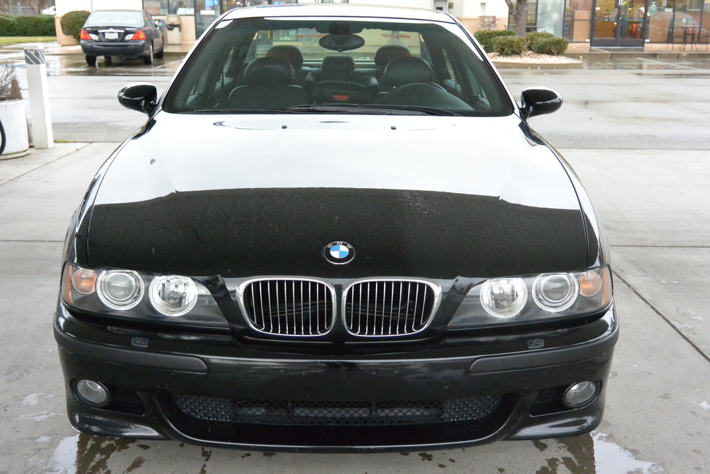

MTEC V3 LEDs for Angel Eyes

OBD-II plug and play just like a stock car. The gauges all function properly with the exception of the M5 oil temperature gauge. The check engine light is connected to the GM PCM (no errors). I also programmed out any error messages out of the instrument cluster related to the engine swap. All electrical splices were soldered and covered with internal adhesive heat shrink tubing.

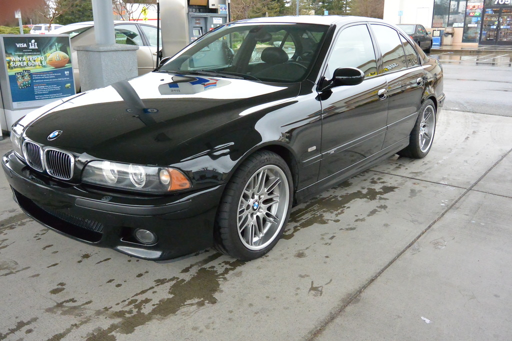

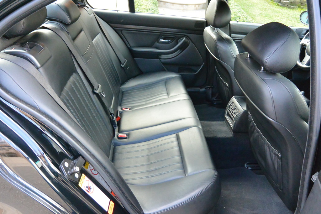

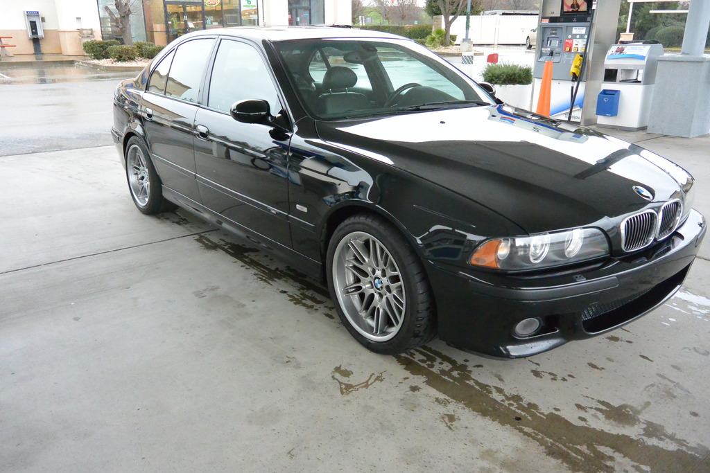

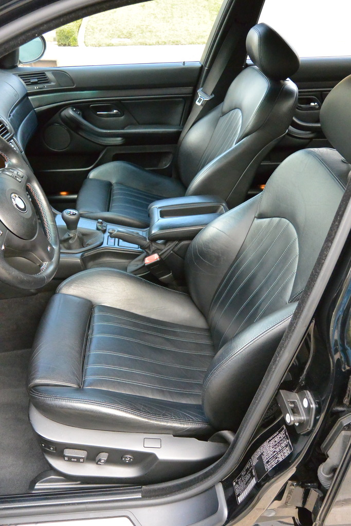

I have over 18k miles on the swap and have resolved any issues that I've come across. The exterior and interior is in great condition. The exterior has a few dings, small scratches and nicks in the paint but overall the paint looks great, especially considering its age. The body does not appear to show any signs of collision repair, though the rear bumper cover has been replaced. I've replaced many of the exterior rubber trim pieces that were dry and cracking. I have a folder full of receipts and info from the build.

cool swap but confused by LSX in title
Old 01-24-2017, 10:18 AM
selshahsamand's Avatar
Join Date: Nov 2012
Location: sacramento
Posts: 25
Rep Power: 13
selshahsamand is on a distinguished road
Whats the confusion? Because of the 5.3 bottom end? Still has LS heads and cam. Not sure what else to call it. So I figured LSX is the best bet.
Old 01-24-2017, 12:14 PM
bzinsky's Avatar
Join Date: Sep 2012
Posts: 65
Rep Power: 14
bzinsky is on a distinguished road
LSX is an actual engine, an expensive crate motor based on the ls7.
I too thought it had one from the title.
Not a big deal, but generally you just say LS swap
