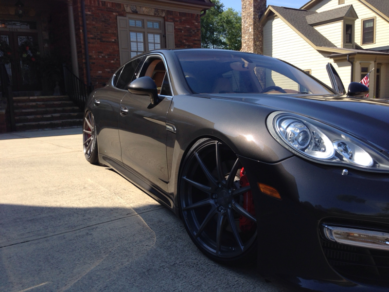

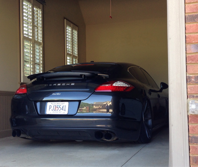

Couple of pics re: slammed panamera... This is the lowest the air suspension can go...

Damn P that's tuckin

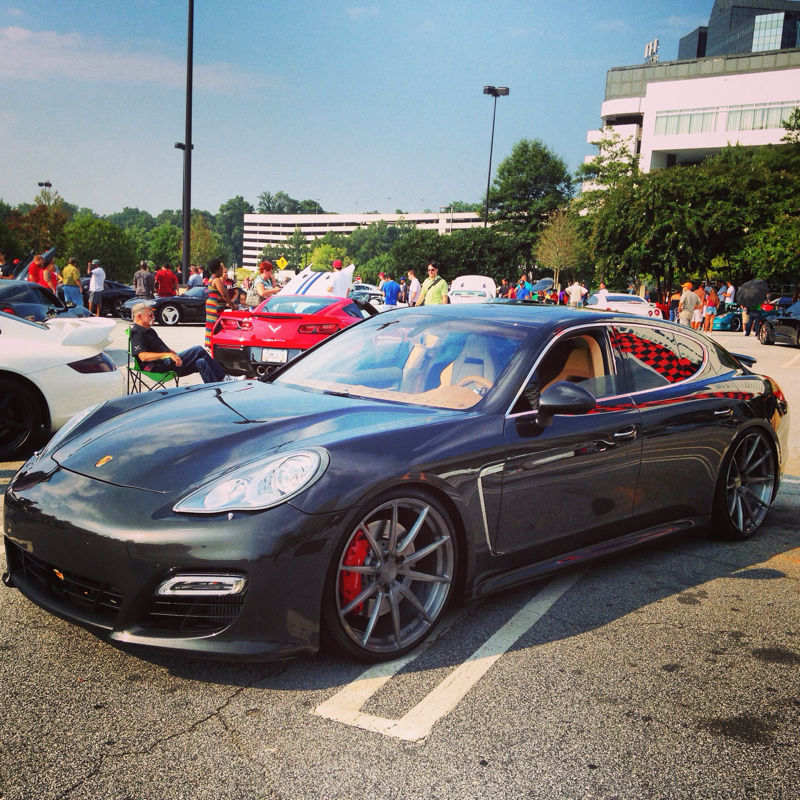

No I don't run her that low... I run about 1" lower in the rear and .75" lower in the front than the original height in sport plus (see pic of my fixed height I run in sp). You can however technically go 2.5" lower than stock height with the links but I haven't performance tested it this low but do know it can be done without it hitting the wheel wells at under 5 mph
