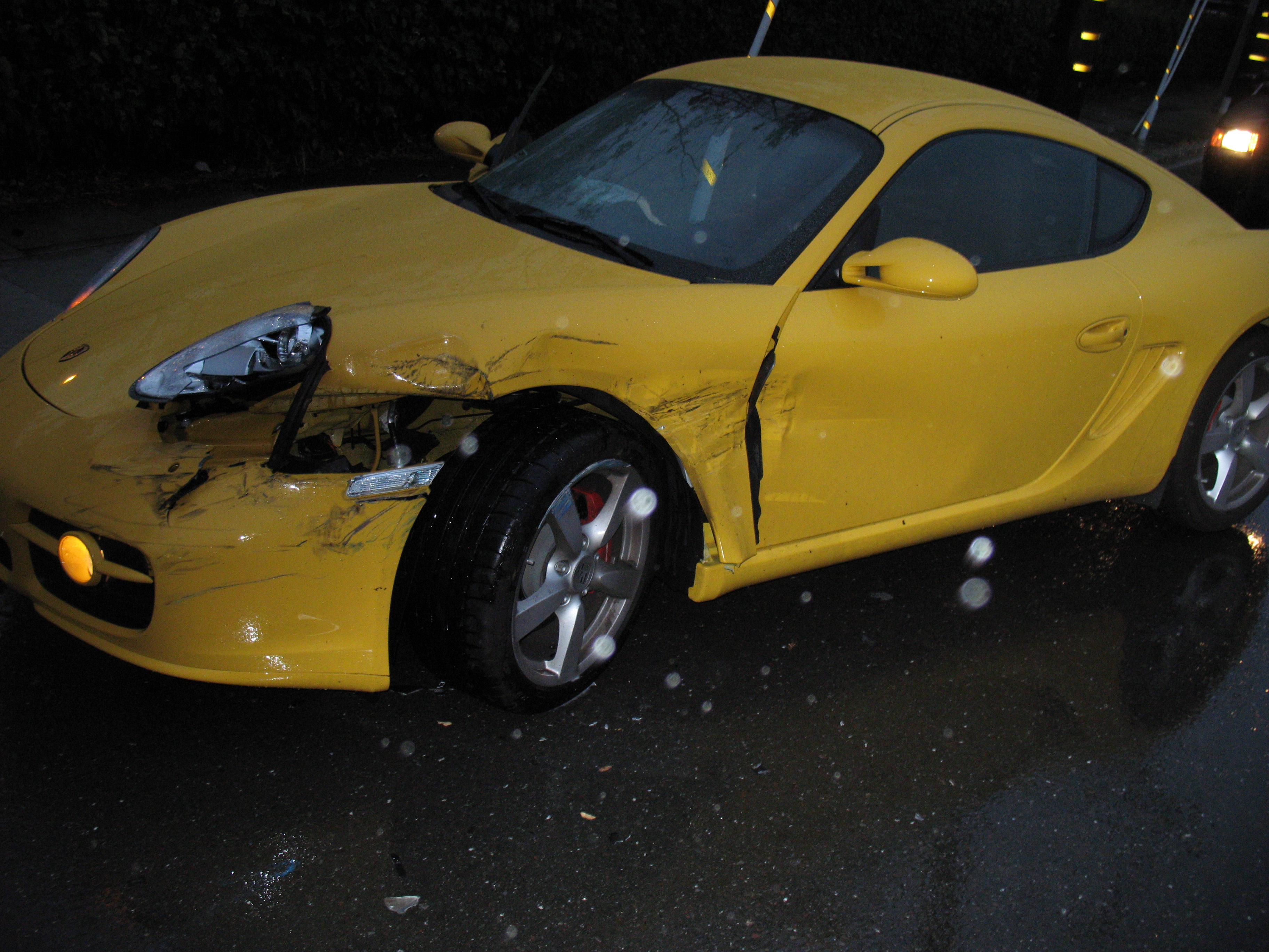

Back in 2009 I sold my 2008 Cayman S with just 2200 miles on it as a salvage vehicle. The car was hit -- at the driver side front wheel/a-pillar area -- and declared a total loss. Both airbags went off. Sold at salvage auction for over $20K. (The insurance company allowed me $17K for the car's salvage value and when I offered the car to Oklahoma Foreign it offered me the same amount.)
Apparently the car never made it back on the road. I googled its VIN about a year or so ago and found the chassis/body in grey primer for sale for $300. I'm sure the low miles engine and 6-speed and other running gear were sold, along with the heater/AC and stereo and dash/cluster, seats, and so on.

With my smashed 2008 Cayman S -- see attached pic -- it took 3 insurance adjusters with the last one an "exotic car adjuster" several weeks to decide the car was totaled. The insurance company didn't really want to total the car but it finally had to admit the damage was that bad.
Might mention even though I had the car towed to and parked at the local Porsche dealer as far as I know the dealer techs played no role in appraising the car's condition. One did bring out a floor jack and lifted up the right front corner and showed me how when the car was hit and shoved against the curb this fractured some pretty heavy duty cast pieces on the right side of the car opposite the side that was hit.
The insurance adjusters just showed up with their pads, camera and made notes.
Not sure how much say the owner has in these situations. (When I called to report I hit a mule deer -- with my Turbo -- just outside of Ely NV and wanted to arrange to get the car towed home -- 600 miles away -- to get it in the hands of a body shop and Porsche dealer near me -- I was told to have the car fixed at a local gas station and drive it home. I ended up paying for a tow -- around $1500 and that with a discount -- to get the car back to my home town. At my buddy's shop -- who had a business relationship with the insurance company (it accounted for 40% of his business) he told me the insurance company was tying his hands regarding repairs and advised me to "get mad" and yank the car out of his shop and take it to another shop that didn't have a business relationship with my insurance company.)
In the case of my Cayman I filed the claim against the other driver's insurance company when it admitted fault. It wanted me to file the claim against my insurance company but I refused. It asked me to do this even after it had accepted responsibility -- which is illegal -- and I told the person every time I was asked to file a claim against my insurance company to put it in writing and send me a letter but of course the letter never appeared.
My concern was that my insurance company would not declare the car a total loss but instead have the car repaired and do a shabby job. One loses some leverage when he signs on the dotted line when he buys insurance.
I don't know what I would have done had the other driver's insurance company elected to fix the car but I would have certainly explored my options to see if I could refuse to accept the car on some grounds. Thankfully it never came to this.
But I was sure relieved when the car was declared a total loss. It is kind of strange to be so happy to get a car only to 4 weeks later have the car smashed and then some weeks later to see the car finally hauled away with a salvage title and destined for who knows what future.
