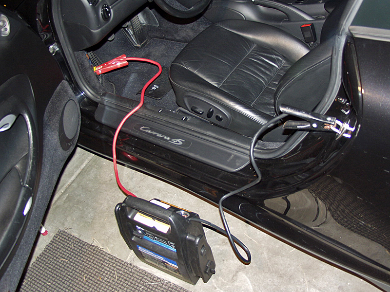

A quick search will yield the same answer, and you're in the wrong forum... But with that said -
There's an emergency hood release in your fuse panel... Just run power to it and a solid earth on the door catch:
