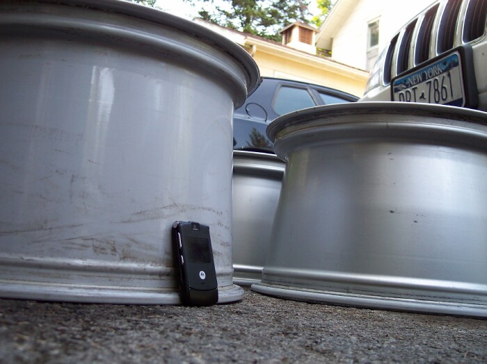

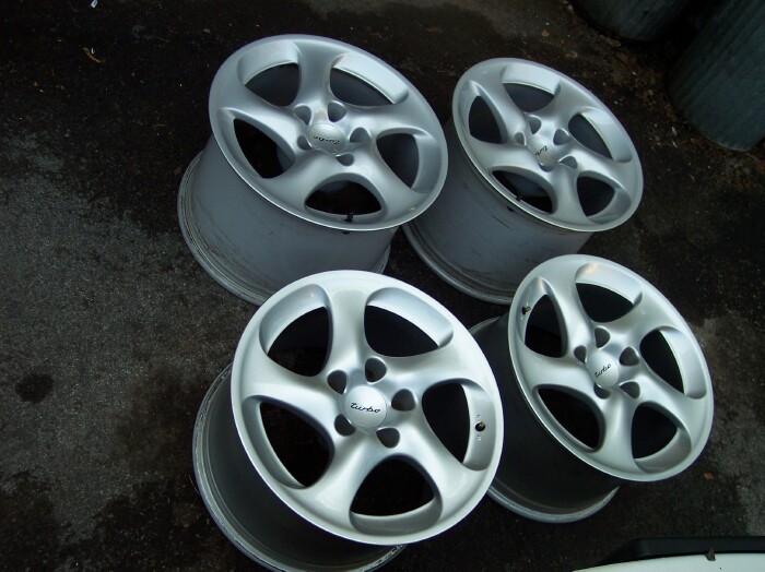

Havent worked on the car nearly at all in 2 months or more, been busy. New wheels for the new widebody though.
18x12 GT2 rears
18x11 996TT rears (for the front).
I'll need a 12mm spacer on the GT2's to get them to fill out properly, but should hold me off till I order some CCW's or BBS Motorsport's.
Doors, fenders and hatch are off the car. Waiting on widebody fenders, 1/4's, and fiberglass doors... among other things.
