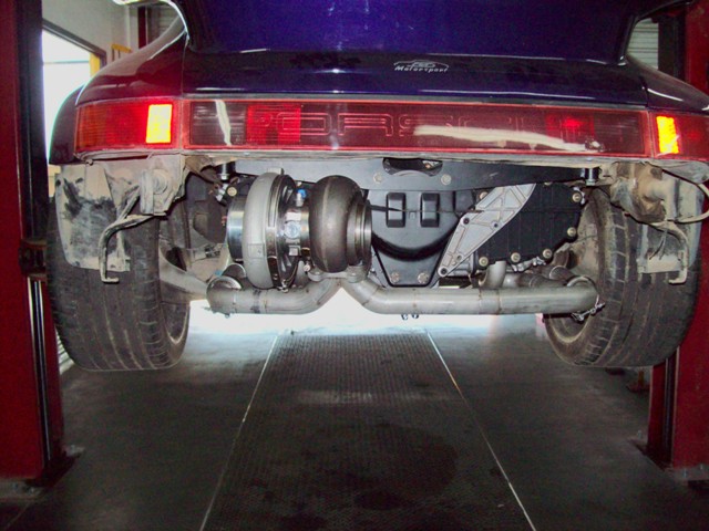

I will let you guys on two photos of my cars project for now. I will try to get you more informative photo's and description once i have it.
The car is a 1994 Turbo 3.6 . Modifications are being done by Chris at TurboKraft.
Some of the specs:
* 3.6 TO 3.8 LITER CONVERSION
* CIS-TO-EFI CONVERSION PACKAGE
* COMPETITION VALVE JOB, SET OF 6, INCL. NEW VALVE GUIDES & NEW VITON SEALS
* EXTRUDE HONE 930 MAGNESIUM INTAKE MANIFOLD & FLOW BALANCE PERFORMANCE COAT CYLINDER HEADS,
* MOTORSPORT VALVETRAIN: (8000 rpm)
* CUSTOM JE PISTONS
* CARRILLO CONNECTING RODS
* 996 GT2/GT3RSR OIL PUMP
* TWIN PLUG IGNITION
* INDIVIDUAL THROTTLE BODIES
* CUSTOM HEADERS (see photo)
* CUSTOM MUFFLER (see photo)
* CUSTOM GARRETT TURBOCHARGER (see photo)

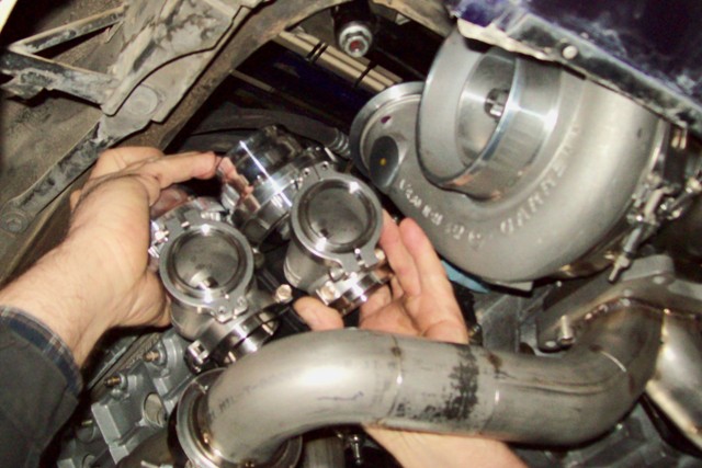

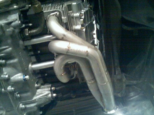

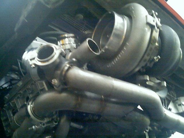

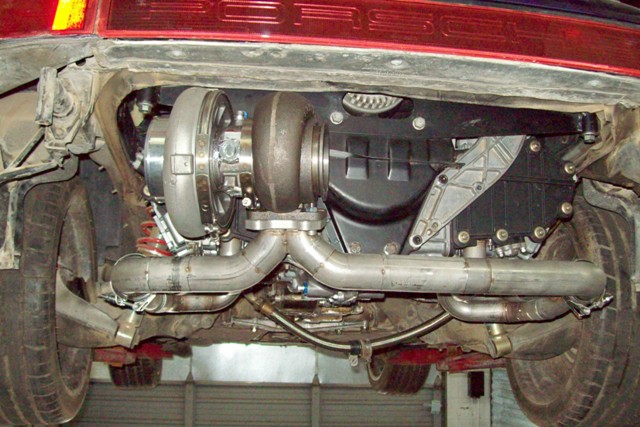

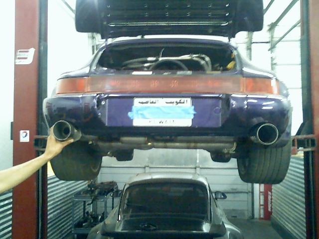

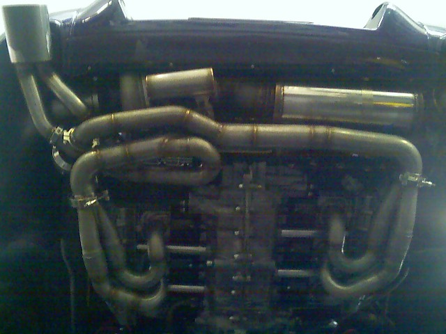

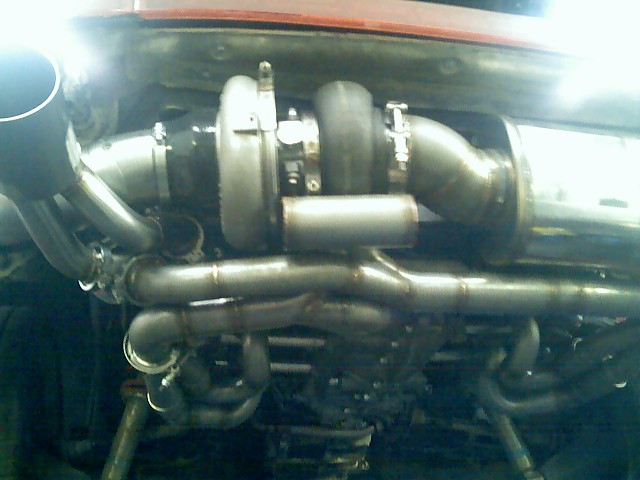

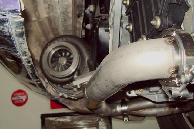

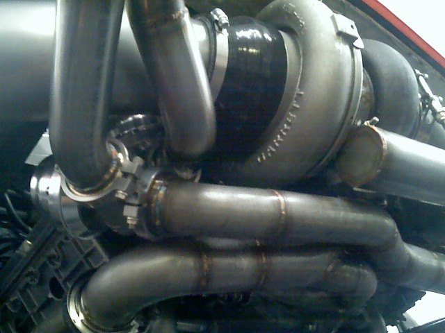

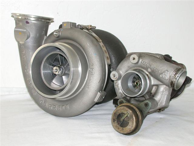

As promised, more photos of the complete headers/exhaust and twin wastegates.
1st photo Project Garrett GT turbo VS. K24 Turbo.
2nd photo custom headers and merge collecter.
3rd photo rear muffler and completed fabrication.
4th photo exhaust routing.
5th photo another cshot of the twin wastegates.

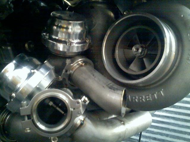

Heades, Exhaust, turbo mounting and wastegate fabrication all done. Some more photos.

What size turbo is that? It looks HUGE! Your build is very cool and I'm excited to hear more about it.
