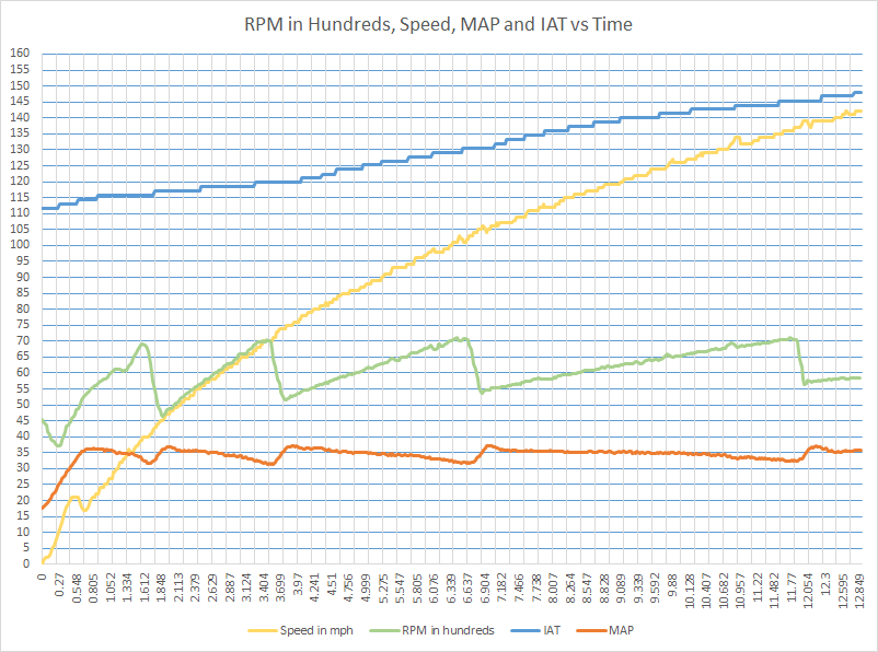

Here is a chart of a quarter mile run with MAP data
MAP is absolute pressure i.e. measured pressure in the manifold so to get boost you subtract 14.7. Course this is with a custom tune but boost hits 21-22 at the peaks. Probably look different without the tune but I haven't measured it that way.
