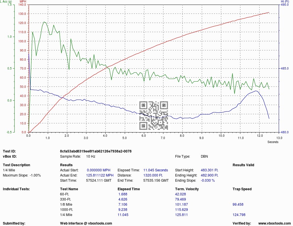

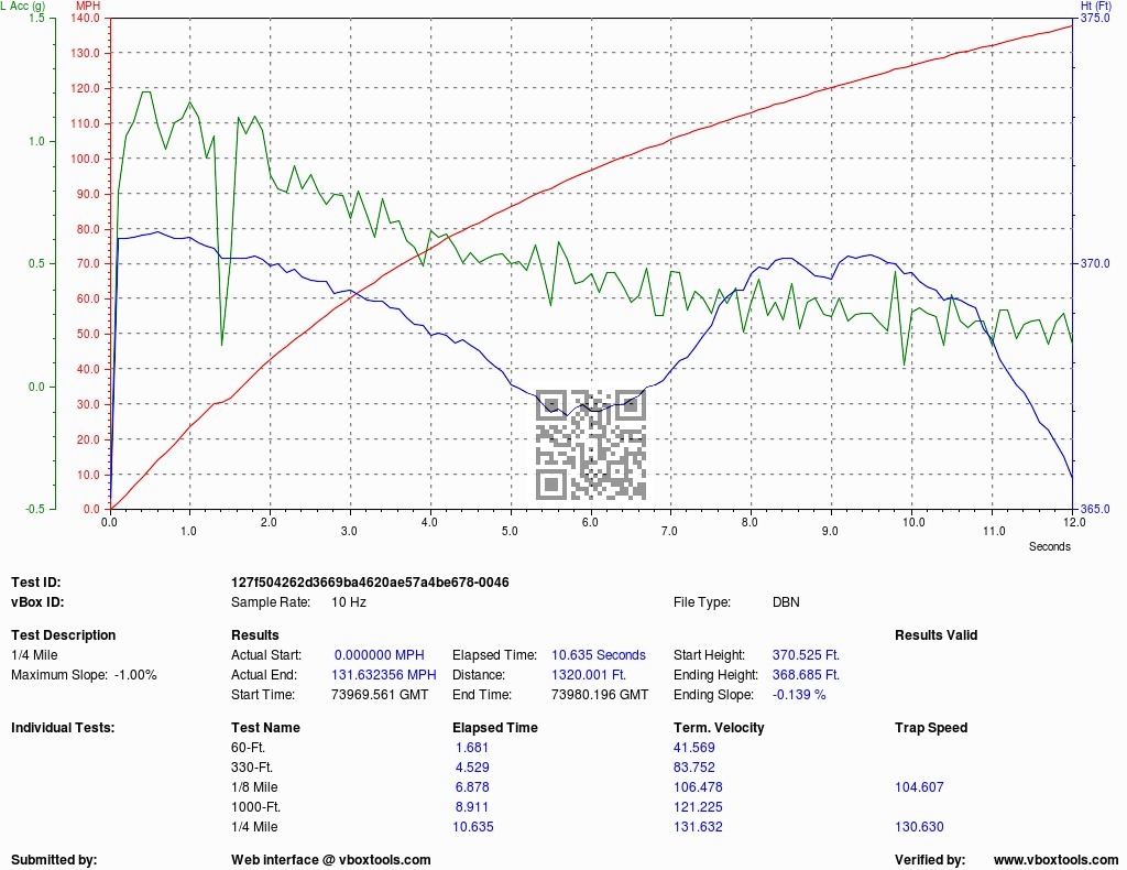

Your piggy back was no good then. Here is mine before and after, demonstrated results without and then with the piggyback, headers and plenum. There was an increase of 6mph in trap speed and .35 in ET. I got an even better ET of 10.5 in another location but only a 129 trap speed because the DA was higher. The DA for these two runs was around 1800. It was midday in the same location. The Vbox gives unequivocal numbers but the butt dyno can tell the difference too, bigtime.

Dude you are missing the point, test your car now after the piggyback has been on a while and then remove it and test it stock again....Let me know what ya got then...
Enjoy going straight in your sports car without a factory warrantee..
I'll never understand why guys will buy an expensive sports car to run 1/4mi. when you can do better with a tuned Honda Civic for under 10K.
