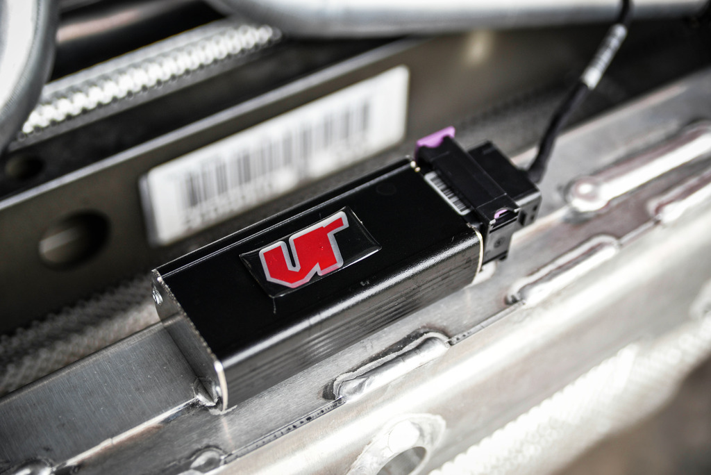

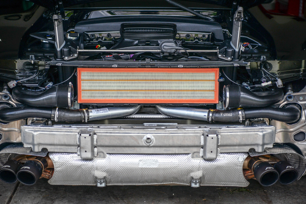

On Friday I installed the Agency intake on the 15 Turbo. I already had their VR Tune Piggy Pack installed on the car.
Installation:
Pretty straight forward...you do have to remove the whole rear bumper to install the intake but it's made to come apart and go back together really easy.
I did filters on my 991s and removing the bumper was exactly the same. This video is super helpful.

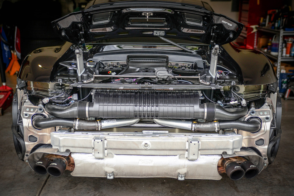

Factory Intake - pretty restrictive design that keeps turbo noise to a minimum.

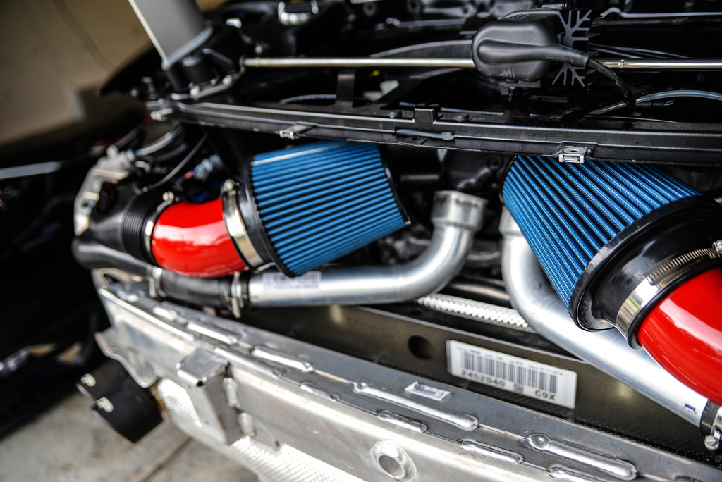

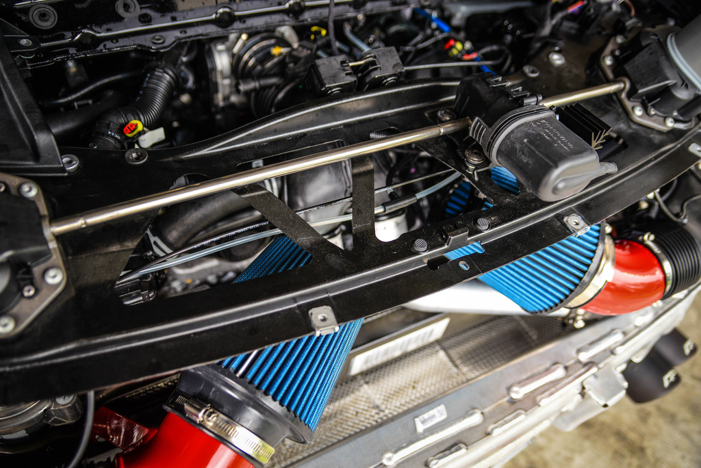

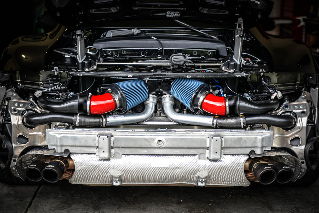

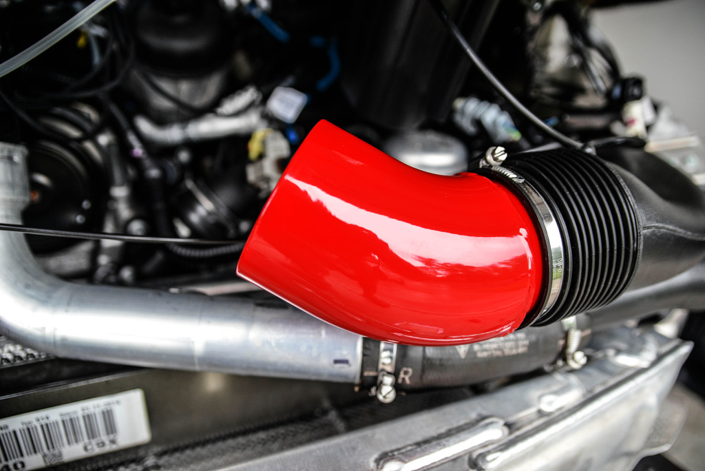

Agency Install - there's really no mistaking how the part install...just take your time and make sure everything is how you want it.
Gains - I have access to a Mustang 1100 AWD dyno so that is what I used. My gains on the intake were more than the advertised results Agency claimed which I am assuming is because I am also running a tune.
Dyno run on same day as install. Conditions were 79 degrees, 87% humidity, and 823' of elevation.
Pull 1 - 11.26whp 19.26tq over stock intake
Pull 2 - 14.13whp 21.22tq over stock intake
Pull 3 - 12.22whp 20.97tq over stock intake
My PDF file of the dyno is like 100mb for whatever reason and won't let me upload to photo bucket.
Driving Impressions - The car is noticeably louder (turbo noise) which I enjoy immensely. There seems to be a bit more of a deep end growl to the exhaust note and a tick more throttle response. I've put nearly 500 miles on it over the weekend without any hiccups or CEL. I am seeing nearly 1.8 more MPG's as well...which is a nice unintended consequence. Same driving style, route, and conditions.
All in, I am pleased with the product and seems to perform as advertised.
Notes - the intake didn't come with any instructions so I had to make a couple calls along the way to clarify some stuff.
