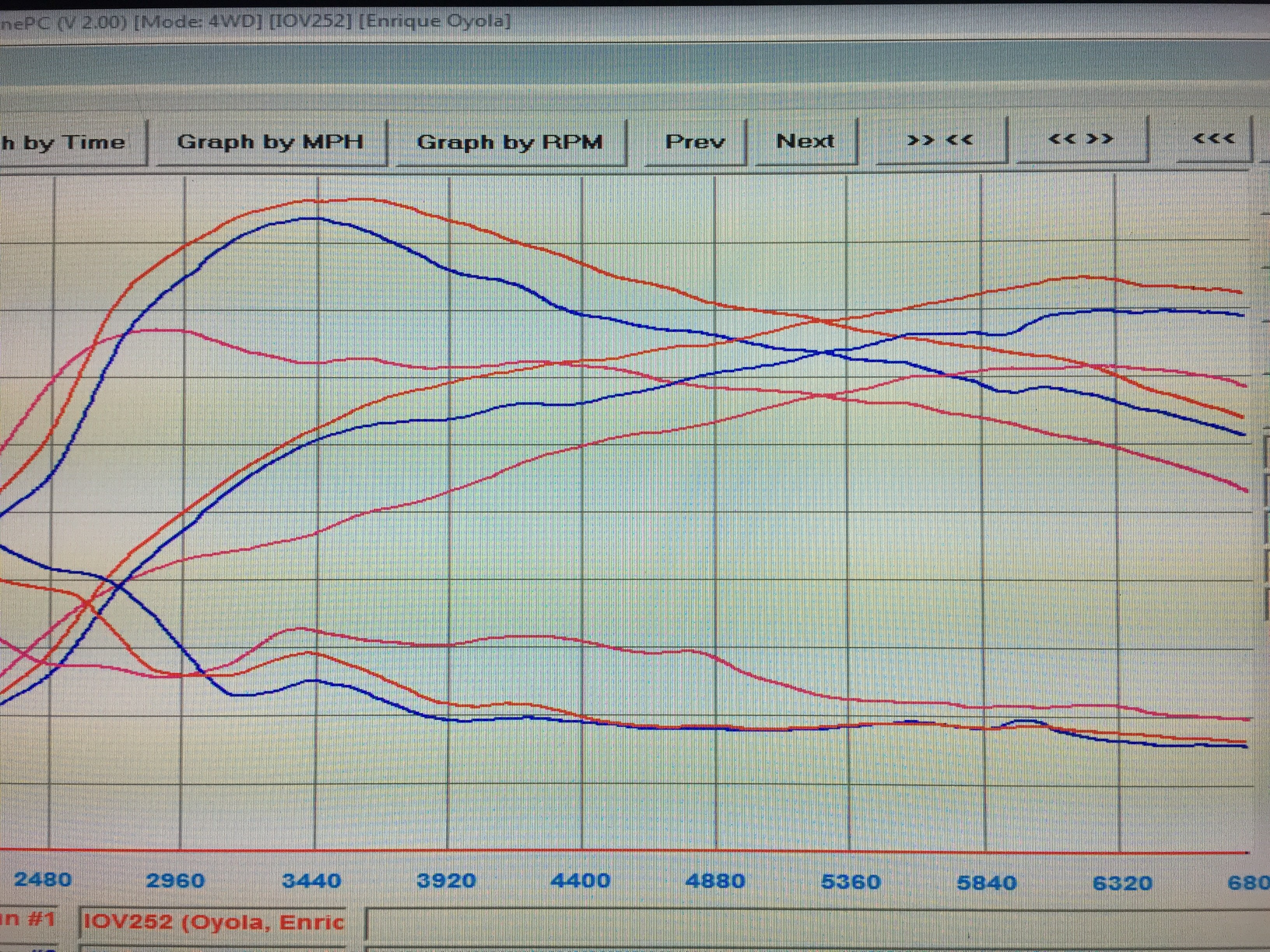

Well, COBB is the #1 Tune for your 991 Turbo... Period!
MUSTANG DYNO (no dynojet that read a lot higher)
Baseline - 432whp 473wtq
COBB OTS 100oct - 482whp 574wtq
COBB Custom Tune 100oct - 509whp 610wtq
The car also have Fabspeed Exhaust
P.S. Mitch, Omar did a terrific job
Sheet!

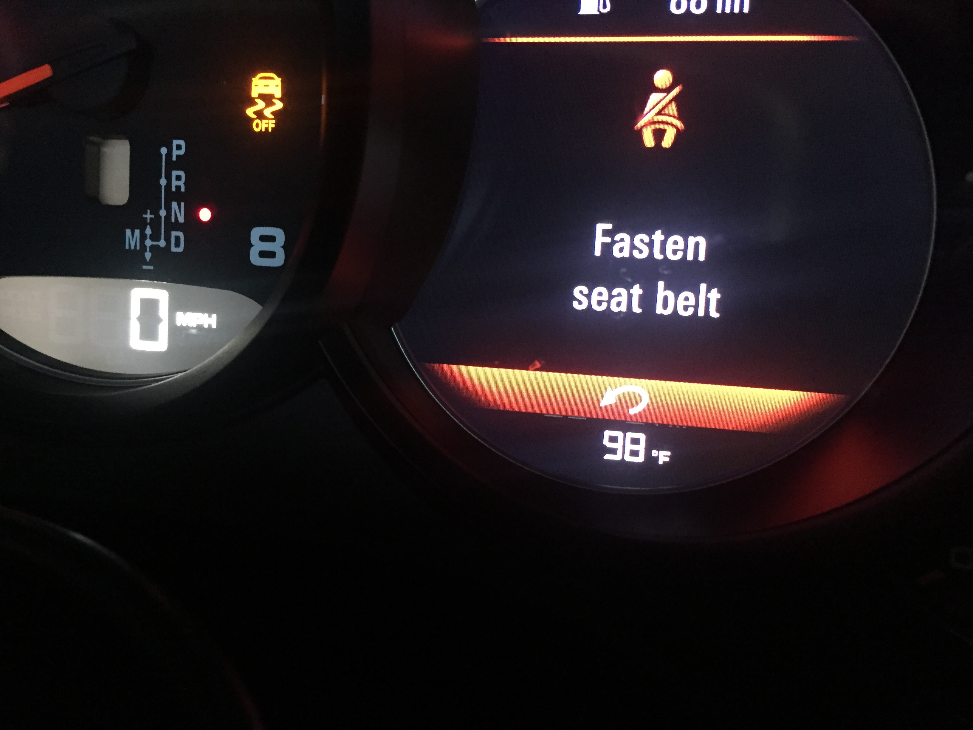

Temp in the dyno (humidity on 88%)

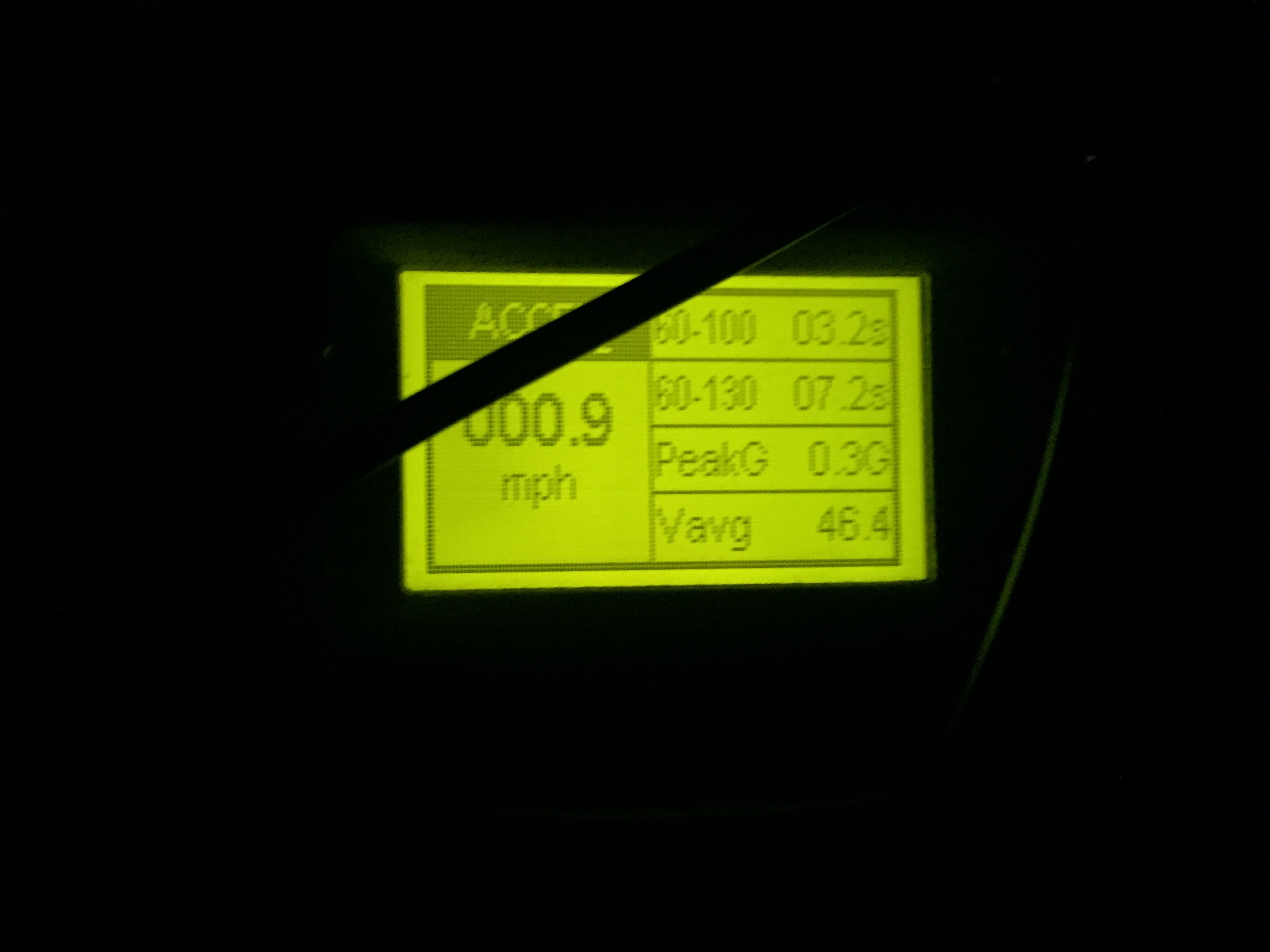

Little test of 60-130 after the dyno

Just for comparo, my 997.2 Turbo with Fabspeed, COBB, AWE Intercoolers, IPD Plenum and Meth did 7.0 on 60-130mph... This 991's are FAST

So the numbers your posting are a new exhaust and a cobb system with 100 octane gas only. If so very impressive.

Are you going to run some quarter mile times? That 7.2s 60-130 is really good. My car shows 7.6s 60-130 on Vboxtools.com and 3.5s 60-100 from my 1/4 mile runs with 50% 93 and 50% 104. I haven't run just straight 104 yet. I really need to get over to Cobb soon. Did you collect a dbn file you could submit to vboxtools.com? Sometimes they are a little different from what the display on the performance box shows in the car.

The wheel torque number is very impressive. Were you using the Fabspeed catless exhaust?

Who did the custom tune? That's impressive almost 30 whp and 35 wtq over the OTS tune.
Do you have fabspeed catless exhaust?

The car only have the catted Fabspeed Exhaust, COBB custom tune and 100oct gas
Omar of Predator Performace (in conference w Mitch) did The Custom tune

What gas did you for baseline? I see that you have a turbo, so the gain should be greater than turbo s cars.
I have a custom file based on datalog from Mitch and Jon, do I need to dyno tune with a specialist to get more power out of this thing? My car has fab xpipe catless and cobb.

the car got 100oct with stock tune on my baseline run... If Mitch did a custom tune in your car you are good to go
