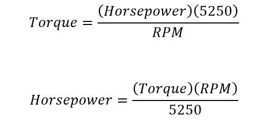

Thanks. I'm curious to know how they manually figured the TQ numbers without an rpm pickup. Or even how the HP graph was accurately calculated.
Dynojets are capable of calculating horsepower from vehicle speed.
The math to calculate torque from horsepower and vehicle speed is really quite simple and should be pretty common knowledge to most calibrators or dyno operators. I posted this same information in a different thread about a week ago. It is all just a relationship between variables. The key part in this was Nigel being able to record datalogs with the Accessport to get the variables needed. He pulled the logs off and sent them to me via email. Doing this would not be possible with other equipment that doesn’t allow the consumer to log. Keep in mind we can log at 40+HZ so the sample rate is extremely high.
We need four variables in total to find RPM and the resulting torque:
- Vehicle Speed (dyno supplied)
- Horsepower (dyno supplied)
- Vehicle Speed (log supplied)
- RPM (log supplied)
Using vehicle speed and RPM from the log we can now calculate our speed ratio. Speed ratio is the relation of RPM to vehicle speed. In 4th gear, from the log I uploaded here, shows the speed ratio of 4th gear to average out to be just over 52RPM/MPH. I use 52.08 in my calculations after reviewing several samples over the course of 3 logs for Nigel’s particular car. To put this in practical terms you would simply take that ratio and multiply it by your speed to get your RPM.
E.G. You want to find the rpm of your car in 4th gear at a vehicle speed of 87mph given the speed ratio for 4th is 52.08rpm/mph:
4530.96MPH is the RPM you are at in 4th gear at 87mph.
Using this speed ratio constant and the shared variable of the dyno vehicle speed and logged vehicle speed you can easily use Excel to calculate all RPM values of the dyno runs.
Using those RPM values you can then calculate torque using that new RPM value and the horsepower output from the dyno. Horsepower and torque have a simple relationship.
We have horsepower and now we have RPM which is all we need to find torque!
Attached is a spread sheet in Excel with the Cobb Stage2 Run 3 as well as our competitor's Stage2 Run3 using the data I got from Nigel. These runs produced the most power of their respected baseline session. You can look through them yourself.
No smoke and mirrors here folks, lift the veil and see that is all just good old fashioned data! We are much too talented of a group and take tremendous pride in what we do. We aren’t going to risk our personal reputation and that of the company by making bogus claims to make a quick buck. We are out to produce a kickass product and judging by the converts and Cobb’s sales in the Porsche market overall, the majority of you agree it is kick *** also.

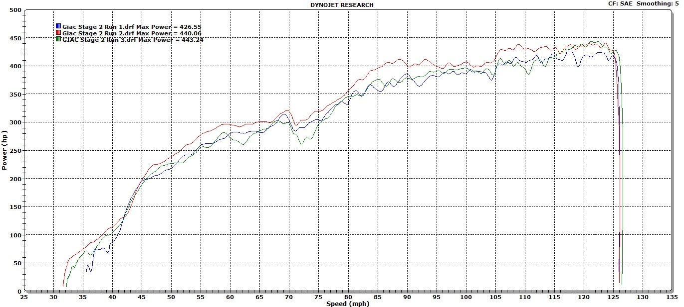

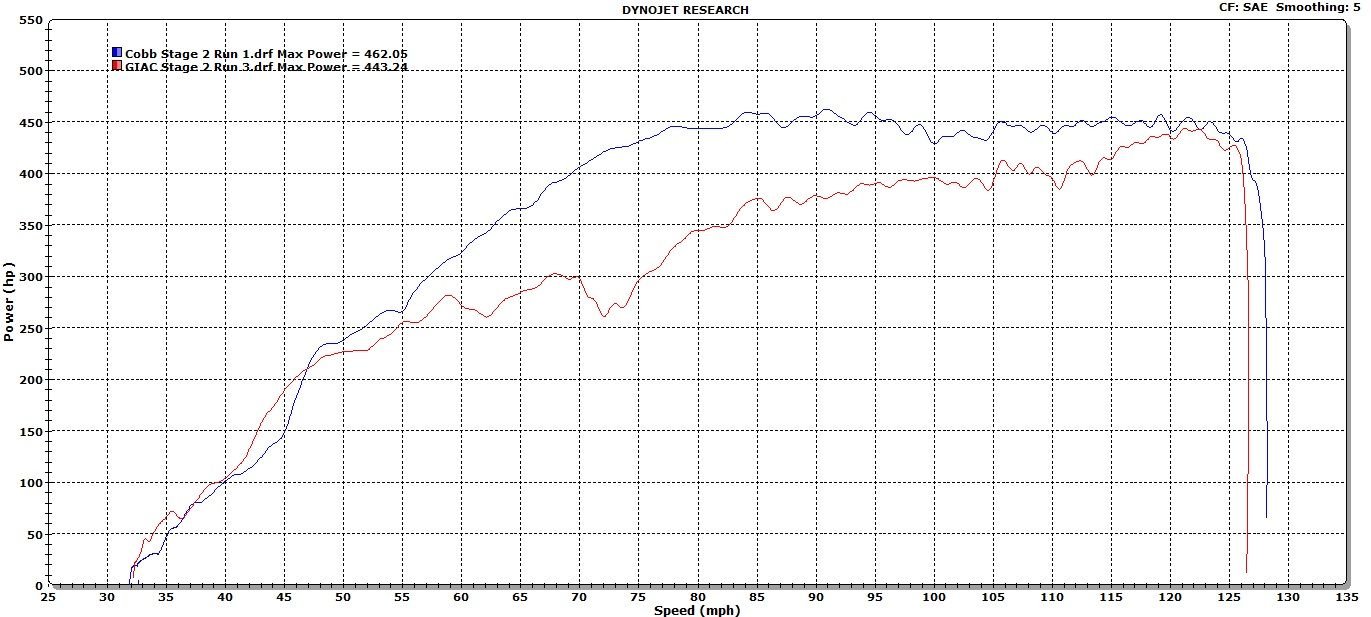

Dyno Plots from the .drf files Nigel sent me.
Cobb Best vs Competitors Best with calculated torque:
Cobb Best vs Competitors Best:
Cobb Worst vs Competitors Best:
Cobb Best vs Competitors Worst:
All 3 Cobb Runs:
All 3 Competitors Runs:
-Note the dip is present in all three
All Runs:
All Runs with run conditions:

Thank you so much Jon in helping to make sense of the files sent. Such a worthwhile endeavor as I was able to dyno and compare both tunes on my car apples to apples with no other change.
The value is in the hard data and having the ability to determine what helps or not in achieving results.
